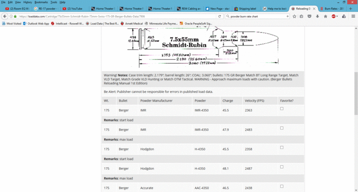

Help me to look up a load in your load book for my k31!
From Berger data. H4350 is close enough to get you started safely.
What do you think will happen? They are just going to tell him they have no data and refer to similar burn rates. In fact, they even recommend IMR 4350 burn rate on the link you provided.
