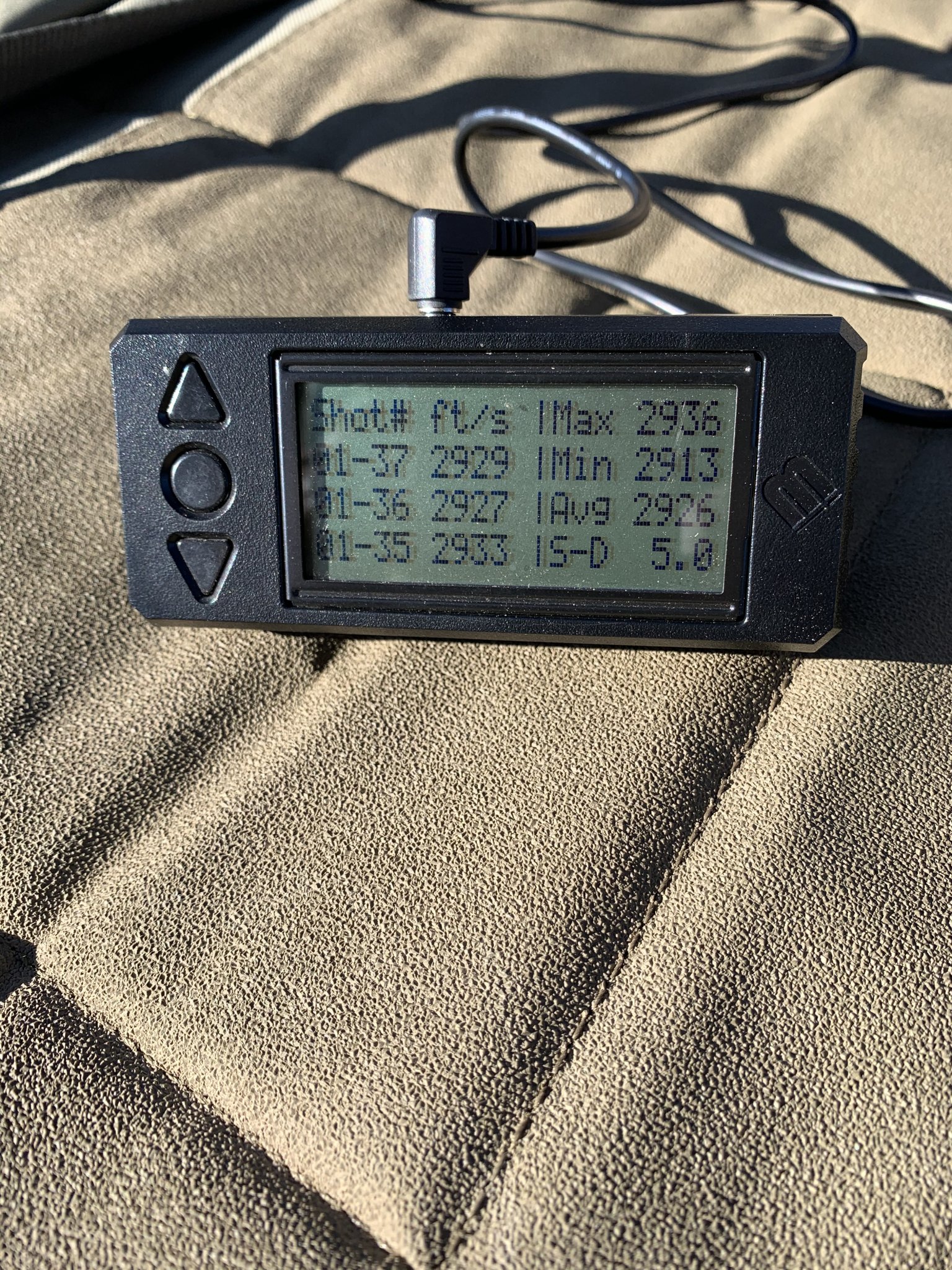

I'd be really interested in the folks with the "single digit SDs" posting some screenshots of those with 20+ round strings. I wager it's selective memory of statistical noise most of the time
Your wish is my command…
Shot from my 300 Norma, NO culls; all shots recorded shooting 1860 to 2425 yards.
