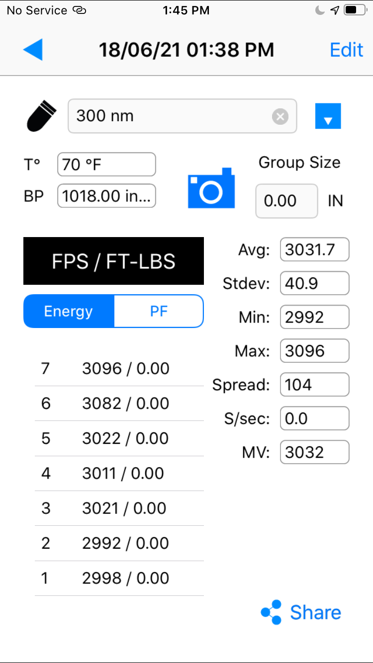

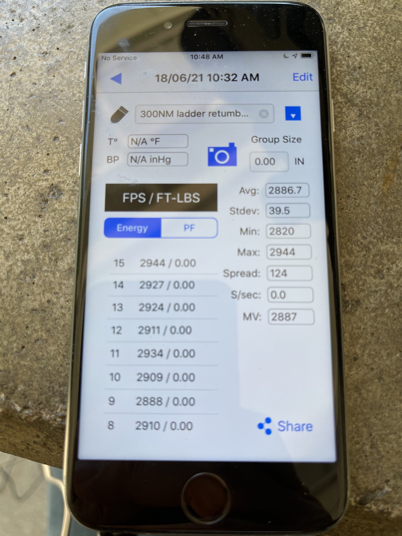

Hi all. Thanks for your help. I’d like to share some data and what I have learned:
Location 200’ elevation
Rifle: AXMC 1:10 26” barrel
I bought some factory ammo Federal with 215 Bergers. Runs really well at 3000 FPS.
Conditions were 60deg F, 70% humidity 30.10 pressure
Today I ran a ladder test of Retumbo with 220 grain SMK in Lapua
Charged from 81.4 to 87.7 of Retumbo
Got good results around 86.8 nice node in the low 3000 of 3010 ish
Nothing huge for pressure signs primers were not flattened but crater was a bit bigger by the last one. No heavy bolts. Noticeable kick increase last couple shots. I think 86.8 will be the zone for me. Headed to Rock Lake to shoot at distance later this month.
Any questions recommendations etc please post them up.

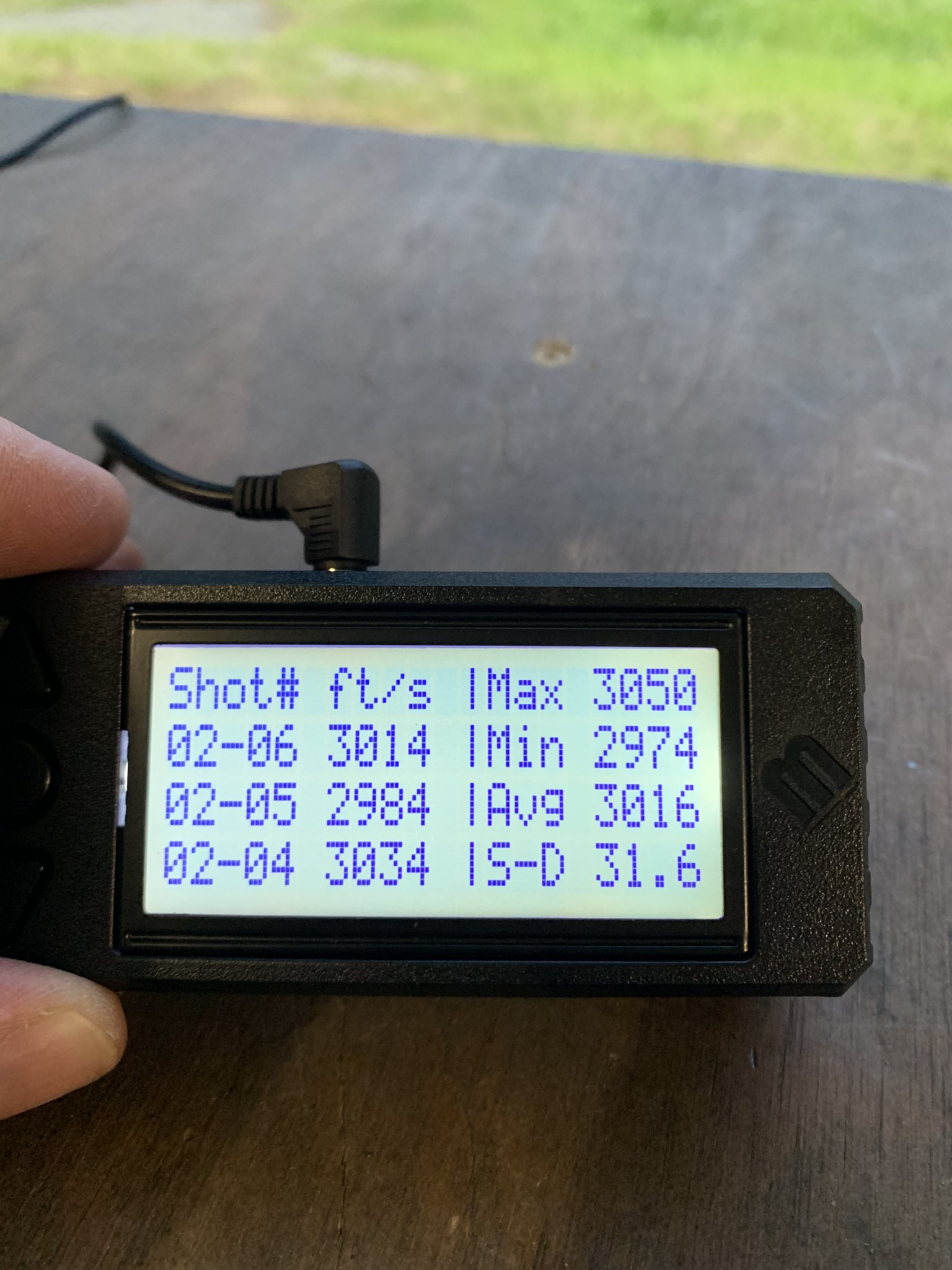

No the pic of his MS screen of his Federal ammo.
I had a 5-shot group of that same Federal ammo loaded w/the 215 give me an SD of over 50 once in my AXMC. It’s not the most consistent factory ammo out there. Federal uses Norma brass for that load, which I like and developed my own load that shoots in the 8-10 range over 10 rounds on average using that 1x fired brass.
Not sure why Federal’s factory shit is so all over the place but whatevs…
