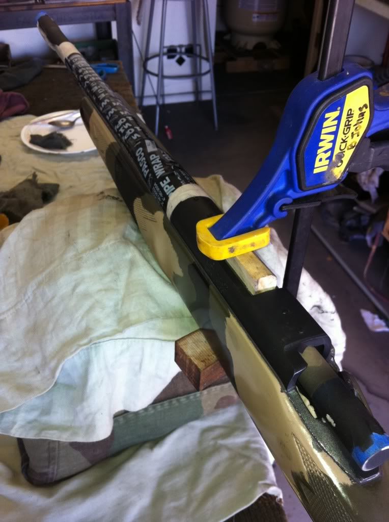

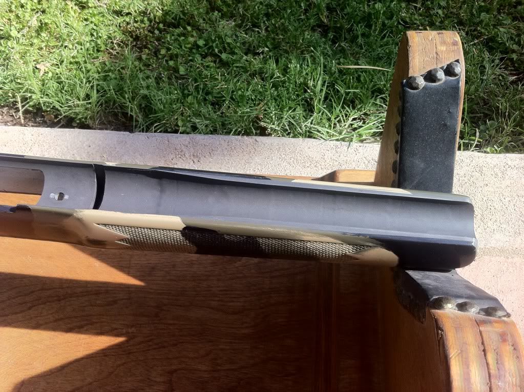

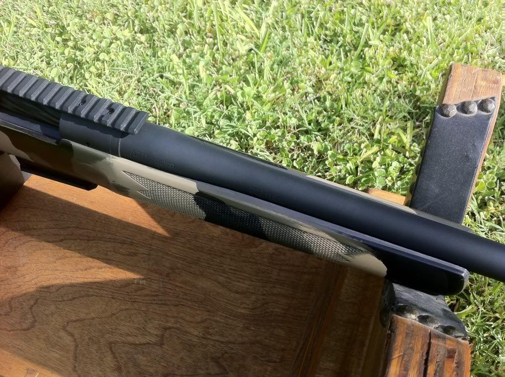

Xdguy,
Here is what I did with the same situation.
I also had an .125" gap in fitting this barrel profile to this McMillan stock.
First, I prepped the barreled action for full length bedding with Devcon 10110.
I put .030 thickness of mil tape over the barrel, and bedded the rifle from tang to forend tip in 1 shot.
Here are the results.
I am going to hit the bedding on the stock line with air cure cerakote to blend.
Bradley Johns
Phoenix Custom Rifles
480-747=0528

Nice prep work, Scimitar and azshooter! I believe that 10 minutes of preparation will save you an hour of aggravation.
Re: Help...Need to slightly modify a Mcmilan stock
what did you do to get such a nice finish along the top or the barrel channel? I am wanting to do the same thing.
