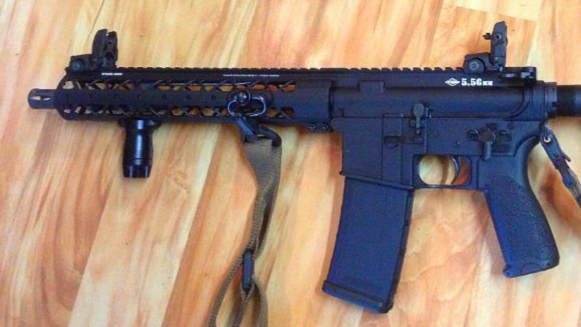

Well it looks like X-Mas came early! I can get a SBR in Michigan now (see below)! WooooHoooooo. And I was just looking to put another AR together, perfect timing.
So help me out here SBR gurus. I don’t want to go anywhere near AR-15.com. I don’t know anything about the intricacies of a SBR and assembling one to run correctly. I also don’t know what barrel length to go with, 8 or 10in? What’s the hot setup? If you were assembling one what parts/methods/etc would you use? I’m not looking to cheap out, I’m not looking to spend $3000 either. And I would like to do it in 5.56 and have it geared as a PDW, short and sweet.
So what the word?
Thanks guys!

AR15.com is not really a bad source of info. If you stick to the technical forums like the Class 3 and SBR sections then you get a lot of good info and usually have minimal bullshit to wade through.
But to help with the topic:
I'd personally go with a 10.5" to 12.5" barrel. You start loosing a lot of velocity when you get under 10.5". Also if you plan on suppressing your rifle most companies do not suggest running a can on a barrel shorter then 10.5" When I talked to AAC last year at SHOT about it they said I could put it on whatever I want. But when the blast baffles finally get enough wear on them and the can becomes louder all they will do for me is give me half off a new can. And if you do run suppressed I'd suggest some type of brake instead of flash hider. While it will be stupid loud while unsuppressed the brake will act as a sacrificial blast baffle.
Here is a chart for velocity out of different length barrels, I can't vouch for accuracy since I'm not the one who put the list together BUT it will give you a ball park idea:
As far as making it run properly you should be fine with a carbine gas system and an H2 buffer. But of course like any gun you might have to play with buffer weight to get it to run smoothly and properly.
To keep it short as possible I'd suggest maybe one of the new folding stock adapters. They seem very well made and have a few friends that have them on fun guns. They are quick to deploy and really shorten the gun up when storing it in your truck or bag.
Hope this helps, I'm not an expert by any means but I'm a damn dirty ar15.com user :D Hope this helps a little.
Depends what you want to do. Once you get past 11.5", the headache of going through a SBR is kinda worthless.
10.5 is a good all around legnth. Just buy a BCM or DD, and it will have the right gas system and gas port drilled.
I personaly like 7.5" guns. Much more fun to shoot and compact. Unless you absolutley need the ballistics of a 11.5" or longer, then don't do it.
To get around having to SBR it, which I refuse to do.... go with Sig Sauer SB15 Pistol Stabilizing Brace PSB-AR-BLK - Stocks - Lower Parts - AR-15. Save yourself $200 and 12 months of waiting....Ontop of the ATF getting a free shot of your private life.
I am very happy with my LWRC SBR. I would suggest a selectable gas system, something that can handle a suppressor if you ever wanted to mount a suppressor on it. I also agree with sticking to 10.5 inches and above. Any less and you really lose velocity and the sound reduction below 10 inches really decreases. Running an AAC on my LWRC shows how much louder it is than my 16.1 inch barrel. Enjoy!!!

That's a tough call man. The nice thing about purchasing from a good company is usually they've already done the R&D into the gas issues and you're more likely to get reliability out of the box with out the trouble shooting. Building is fun though and you can make it yours... I wish I had that decision issue lol. F@#king Washington...

It's easy to set one up the way you want it. I like 10.5" and 12.5" 5.56 SBR's, and my 7" .300 blk. They all have their place. For the .223, pick a good barrel and upper, get a mid length ff hand guard, carbine gas tube, and a low pro block and rock it. I've got lots of gas tube roll pins I can throw some in an envelope for you, because I always butterfingers the first couple, and never find them among all the metal chips on my floor.

I personally like the 11.5" barrel length. A little bit better ballistics than the 10.5 and a little more dwell time. I also find I like a 11" rail for more comfortable and further-out grip. Also, if going to build it as a pistol, the 11.5" barrel gives you 26.25" overall length using a carbine buffer tube so a vfg can be used without being considered an AOW. This is a 11.5" LW profile BCM barrel w/ 11" rainier evo rail.

Oh, and FYI... The ATF requires all short barrel rifles to be engraved with the manufacturer's name, city, and state. I'm pretty sure that's all. And that information should already be there anyway. We've sold thousands of lowers that were used for SBR's and every time someone has brought up "engraving" extra information on a Lower our Class3 guy has told them it is NOT required. So far no one has been arrested and blamed us for mis-informing them.
Is that a 11.5' barrel plus the flash device or 11.5" for both?
11.5 without muzzle device. The A2 adds about 1.25" to a bare muzzle. With any legal length measurements, it's always without muzzle devise counted, unless it's permanently attached.
