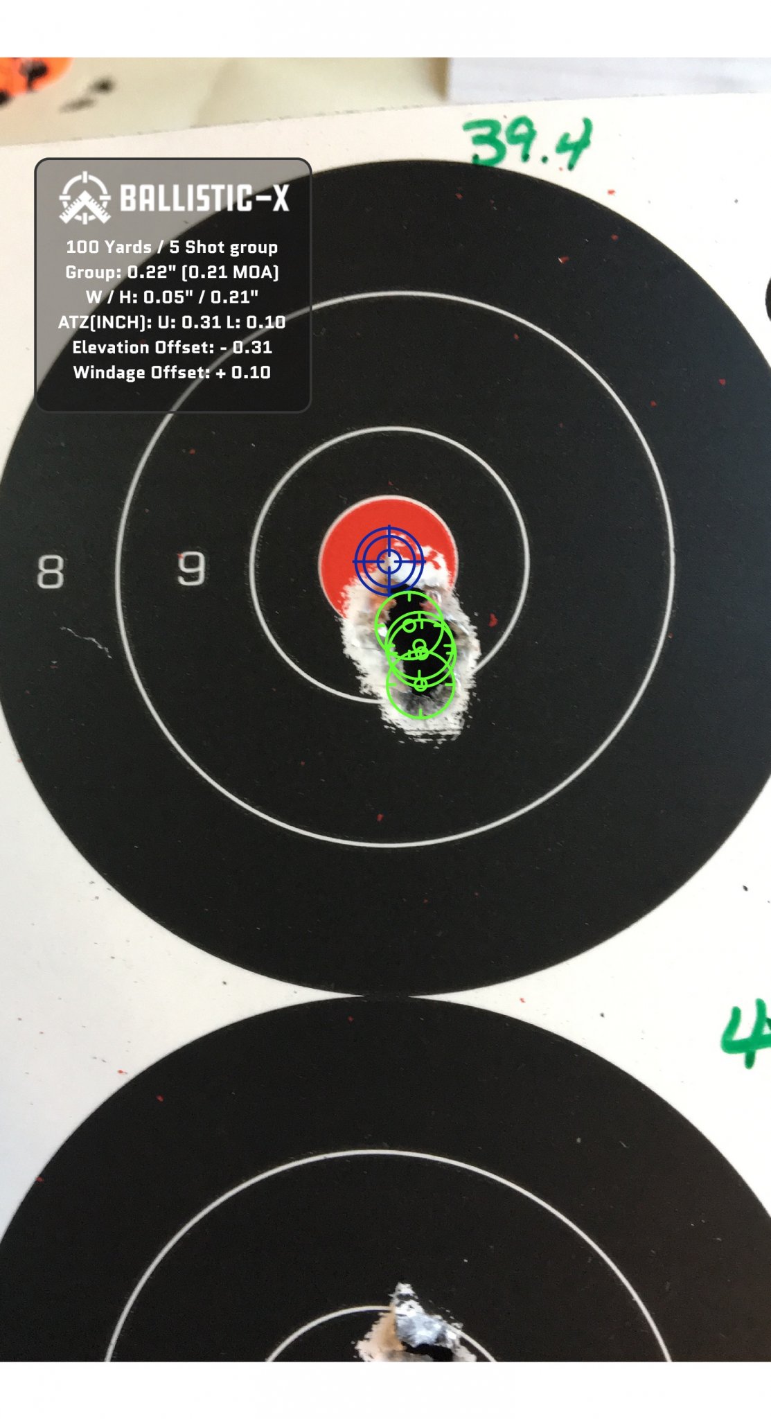

You dont need dedicated rear bag. Shot this with Harris and a Gamechanger yesterday

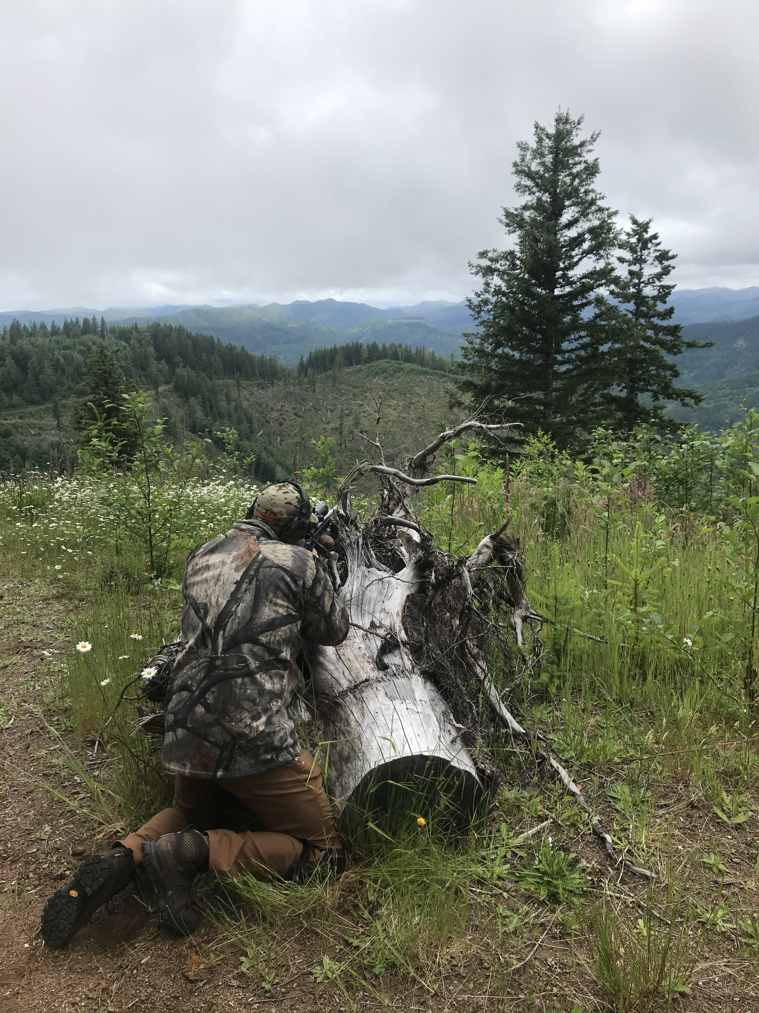

Here’s a buddy of mine using a precision underground bag as a front rest to bang steel at 1050 yards.
