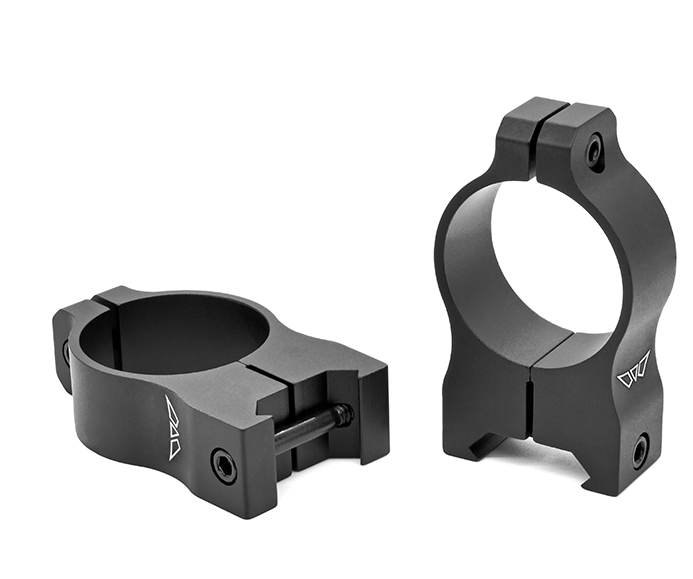

Thanks for those links. I think i'm leaning towards the Warne MSR XSKEL at this point. I don't see the need for QD levers in my situation. I won't be swapping optics often. I like the idea of torqueing bolts with a torque wrench vs QD torque nut settings. The Warne looks solid with a traditional clamp style scope ring vs the vertical split like on the ADM recon..
