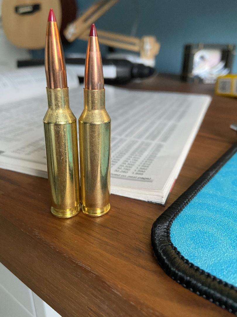

    So I'm a beginner at reloading. I'm currently trying to make a dummy round for my rifle.
    I used the Hornady OAL gauge to find the BTO measurement for my rifle's chamber and found it to be 1.999 on an average of three tries. To give it 20 thou jump I aimed for a BTO of 1.97 after seating. When comparing it to a factory loaded round with the same bullet and brass(Hornady 140gr ELDM) it seems like my ogive is too far inside the casing.
    Is this okay? Or is this bullet too far inside of the case? I can't find a minimum overall length for 6.5CM anywhere on the web.
    Factory ammo is on the left in my picture for reference.

    Does factory ammo have difficulty chambering?
    coloring the bullet in sharpie will also let you see if you are just touching on the lands or if you are dragging it somewhere.
    Factory ammo loads fine, I measured again and got a BTO of 2.05 twice, which seems a bit more reasonable and brings my COAL to 2.702.

    If the one on the right is 20 thou off the lands then the factory on the left shouldn't even chamber from the looks of that picture......LOL Something is askew here.

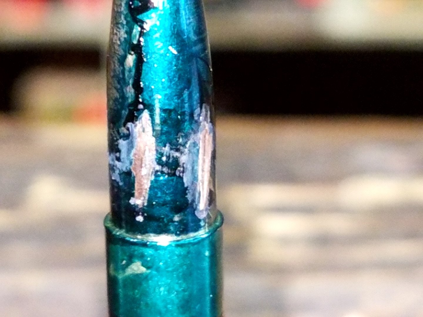

    Color it in sharpie, you’ll be able to see the 3,4,5,6 land imprints, however many grooves your barrel is. If it’s really jammed you’ll go past just the lands and get a full on scuff mark the whole way around. But sharpie makes it easy to see where the bullet got touched.

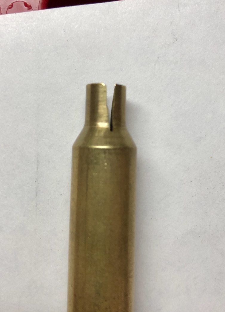

    Happily, I only borrowed a Hornady OAL length gauge and modified cartridges, and found the thing wildly inconsistent in both .223 and 6.5CM. What I use now is the bullet of choice seated long in a neck-split case (pictured), which holds the bullet firmly but does allow it to slide. Then I
    1. Push the bullet/case into the chamber with a finger until it stops on the case shoulder.
    2. Use a cleaning rod to push the "round" out from the muzzle, being very careful to protect the muzzle crown. The bullet will stick a little in the lands first time.
    3. Measure CBTO.
    4. Optionally, seat the bullet in further a thousandth or two
    5. Repeat steps 1-4 until the "round's" CBTO measurement is consistent. If resized and seated properly, the case/bullet should fall out on its own without pushing with the cleaning rod when the bullet is a thousandth off the lands.
    I get CBTO lengths consistent to a thousandth or two with this method, and the split case makes "chasing the lands" easier as the throat erodes.

    This is a bullet that was touching deep into the lands....
