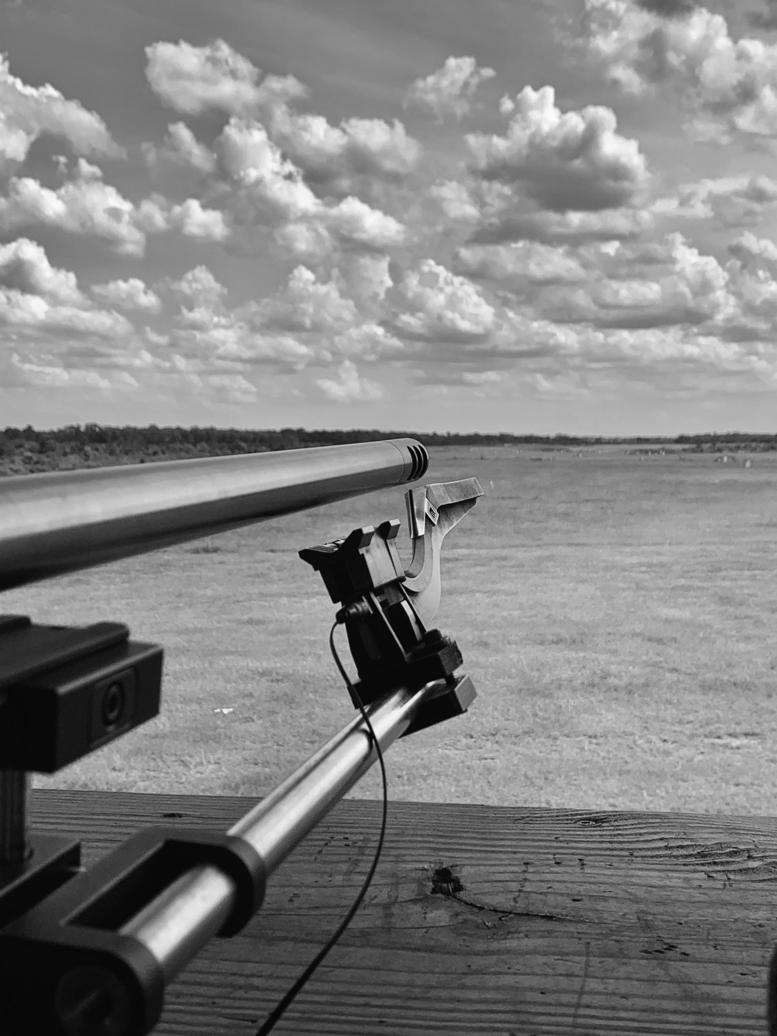

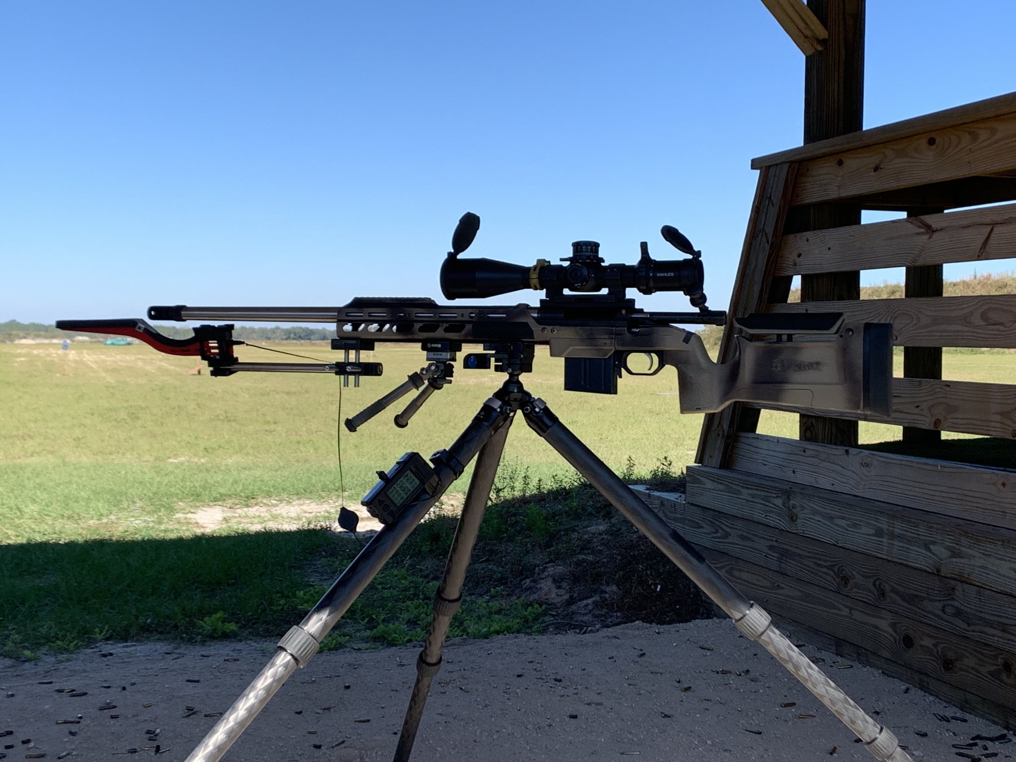

Oh, and as far as a chronograph attached when doing the test, try this. It gets it off the barrel allowing you to shoot for accuracy and velocity. Mine works great.
