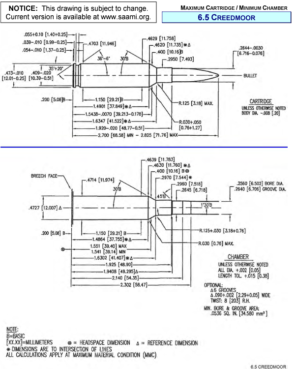

With the 6.5CM, the ammo specs and chamber specs are online.
Left to right for diameters
Rim 0.473"
The 200 line 0.4703"
Body to shoulder facet 0.4620"
Neck 0.2950"
The lengths
Body to shoulder 1.4901"
Shoulder to neck 1.6347"
Case OAL 1.920"
You can get away with using the edges of your 6" calipers on those body facet lengths, assuming your shoulder datum gage says you are good.
You will need a decent micrometer for the diameters.

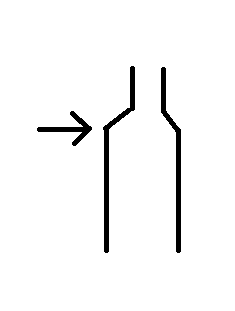

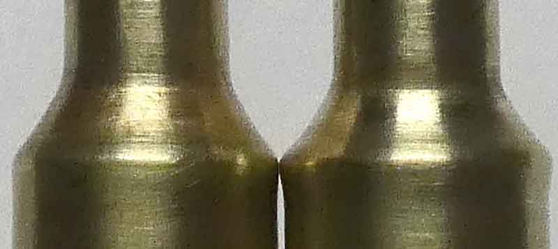

Did a ton of measurements and can't find one out of spec. Markered a round and forced it into a case gauge to get rubbing
Rubbing i s happening at the case/shoulder junction--bright shiny ring wear all the marker is warn off:
Diameter measures the same as a good round (0.4630), I dunno if there is a lip or that point is too far forward (that measurement is tough to get accuracte) This was measured just before the junction.
EDIT: There is indeed a "rim" at the shoulder junction that measures larger (in diameter). Right where the arrow is it increases to 0.4340+, Some how that area is getting bulged (again at random--most rounds are fine 1/15 have issues) during reloading.
IME, case lube issue. As in not enough applied, or it just isn't slick enough.
Reactions: RegionRat
Agree, we need to scrutinize the brass there before and after sizing and see when the bulge forms.
See if the idea like @TheOfficeT-Rex is saying about lube, or if those samples are otherwise longer from firing and being sized more/different?
I've seen this before and it had to do with how the sizing die was set up causing pressure to push down on the neck and shoulder to cause that kind of budge at that junction. It could be something in the die, like the expander ball not being adjusted properly or something catching a little on the case mount pushing down in a way to produce a bulge at that junction. Mostly, I've seen the use of an expanding mandrel and something in the die pushed down to cause that bulge.
