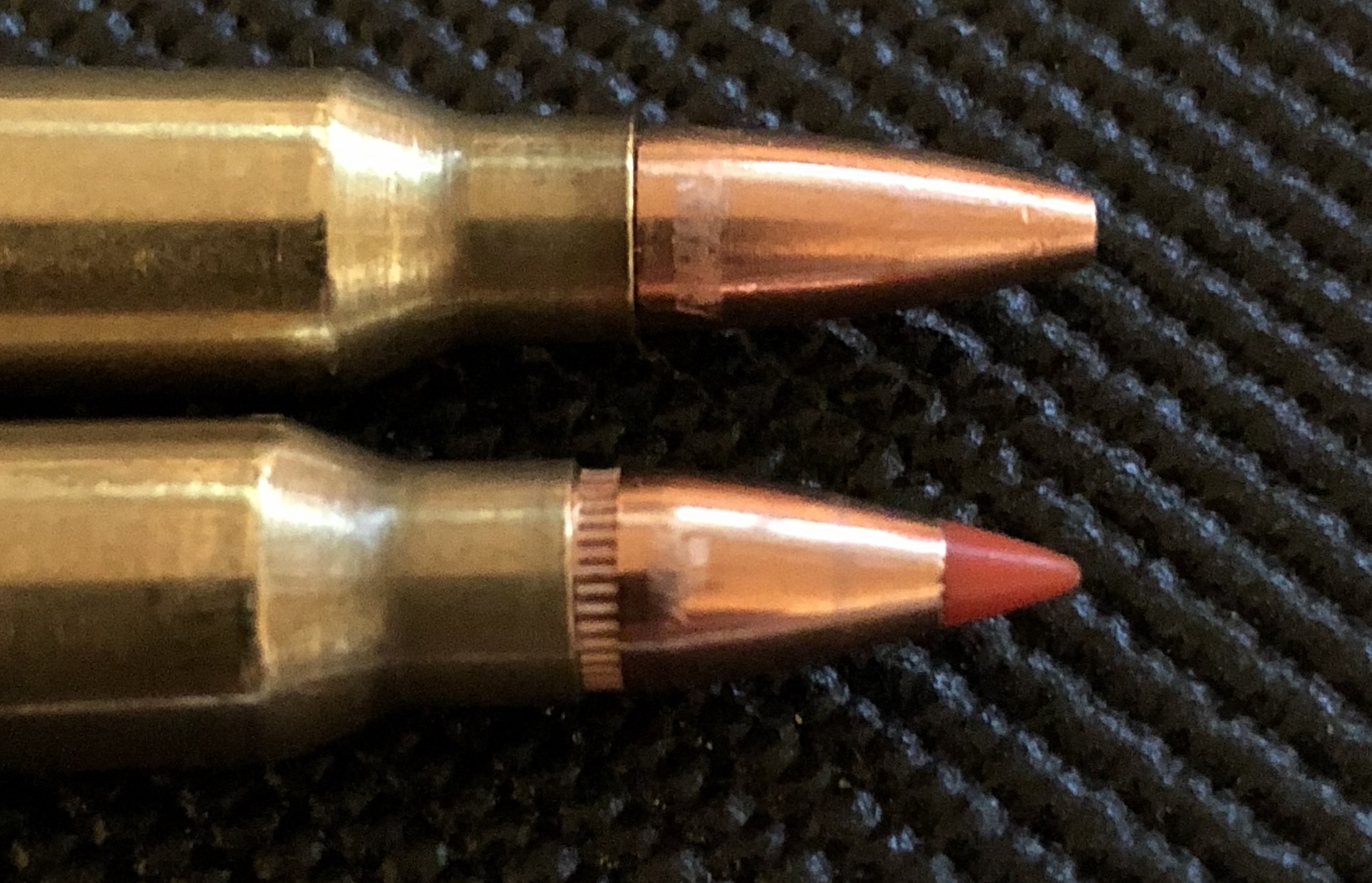

These are the marks getting left on the bullets. The vmax chambered. Lehigh defense did not.
glockguy56, perhaps you are loading a tad on the long side. What is the Overall length (OAL) of your loaded rounds?
Can you provide the length from the cartridge base to the tip of the bullet on both kinds of loaded rounds?
That’s lots of interference. Clean your throat really well as Codie said to make sure you don’t have a carbon ring from hell and then test your seating depth like in the second video posted above.
Two things:
First, your Howa bolt rifle chamber is probably on the minimum size for maximum precision. If you're sizing brass that was previously fired in a semi (with a fatter mil-spec chamber for self-loader feeding) you'll need a small-base sizing die.
Second, you are not seating your bullets deep enough. You can see the bullet ogive hard-contacts the lands at the leade where they're scuffed.
A cartridge drop-gage only tells you if the shoulder was sized back for headspacing and if it needs to be trimmed-to-length. It won't tell you if it was sized far enough, particularly 1/8 to 1/4 inch above the head and extraction groove. You'll probably want a Stoney Point / Hornady gage to find proper seating depth. From your photo I can clearly see both bullets may be seated a few thousandths long.

Are the marks only on one side? Will the round chamber if you put some pressure on the back of the bolt to close?
Yeah the marks are only on one side and I didn't ever try putting pressure on the back of the bolt but I did push a good amount forward on the bolt handle when I was trying to close it.

Follow the video above for seating depth. Strip your bolt of the firing pin and ejector. The firing pin will make it impossible to feel the bullet on the lands and the ejector will push the bullet into the side of the chamber leading to false results and scratches like youre currently seeing. Once you do that you will know exactly where your bullet is in the throat instead of wildly guessing.
