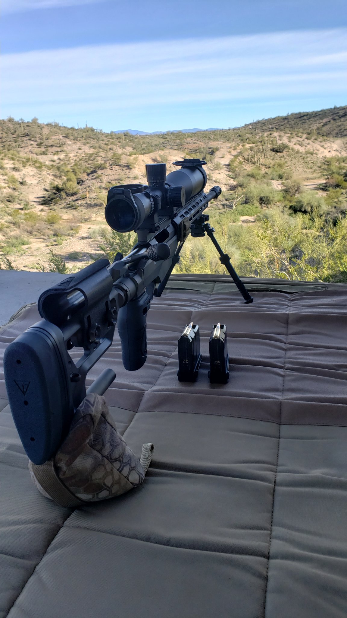

One thing to watch for is height, with the flat top rail on the Tac A1 you'll need tall rings. 1.5 should be sufficient maybe 1.4with a 50mm obj. I ended up having to go a little taller on mine with 56mm obj and 20 moa rail and even then I've got like 1mm clearance with the flip caps on
Optic on this one is Athlon Ares ETR 4.5-30 that i found a good deal on decent glass starts to wash out around the edges above 27x
Is that a Rifles Only rear bag?
