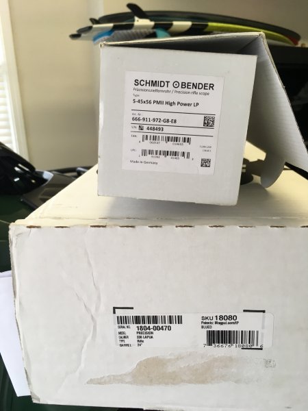

E Emmersom Biggens Sergeant of the Hide Full Member Minuteman Oct 8, 2018 115 17 49 Locust Grove, Ga Dec 23, 2018 #1 Dec 23, 2018 #1 I found this S&B scope local at what I feel like is a deal. I am ignorant to their numbers. I can’t tell if it’s a mil scope or a MOA scope, and nothing about the reticle. Any help would be appreciated. Thanks you! Attachments 17B483D1-43ED-4C2C-A71B-5FFCA30966C7.jpeg 47.4 KB · Views: 54
mattwaage1 Slacker Full Member Minuteman Oct 21, 2012 308 120 39 Rock Springs, WY Dec 23, 2018 #2 Dec 23, 2018 #2 Just type that model number that starts with "666-......" Into Google search and you'll see what comes up.
E Emmersom Biggens Sergeant of the Hide Full Member Minuteman Oct 8, 2018 115 17 49 Locust Grove, Ga Dec 23, 2018 #3 Dec 23, 2018 #3 Does cm ccw mean the same thing as mil-r? I found several depictions of a P4FL reticle on line, just several that are different. Thanks!
mattwaage1 Slacker Full Member Minuteman Oct 21, 2012 308 120 39 Rock Springs, WY Dec 23, 2018 #4 Dec 23, 2018 #4 Cm is centimeter. Aka mil. Ccw means counterclockwise spinning turrets. Up is counterclockwise (as opposed to clockwise turrets) P4f is the reticle and should be all the same subtensions It's a mil scope with a p4f reticle and counterclockwise turrets.
gr8fuldoug Supporting Vendor Commercial Supporter Full Member Minuteman Jan 24, 2006 7,500 4,171 61 Old Bethpage NY www.cameralandny.com Dec 24, 2018 #5 Dec 24, 2018 #5 5-45x56 LP P4FL 34mm 1 cm/.1 mrad CCW DT MTC LT / ST ZS CT Weight:1106g / 39.0oz Scope Length:434mm/17.1" Magnification Range:5-45x Scope Objective Diameter:56mm Scope Tube Size / Mount:34mm Turret Adjustment (Click Value):1 cm CCW Elevation Turret Details TMTC LT (Double Turn; More Tactile Clicks; Locking Turret) 270 cm/100 m Windage Turret Details:ST ZS CT (Single Turn; Zero Stop; Capped Turret) ±60cm/100m Parallax Adjustment:Side Focus Parallax 30m->∞ Reticle Position:First Focal Plane Reticle Details P4FL Reticle Field of View:7.8 - 0.9m @ 100m Eye Relief:90mm/3.54" Twilight Factor:16.7 - 50.2 Light Transmission90% Illuminated Reticle:Yes Turret Rotation:Counter Clockwise (CCW)
