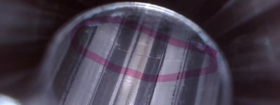

The circumferential line appears to be near the muzzle and is probably a tooling mark is my best guess? How does it shoot? By the way having to unzip your pics is cray cray. Can you downsize the files and post them here?
Thanks. Unzip? Its not zipped. Thats probably how your PC downloads it. Tooling? seems rough. I thought I damaged it with my stupid cleaning routine I picked up for the "experts"

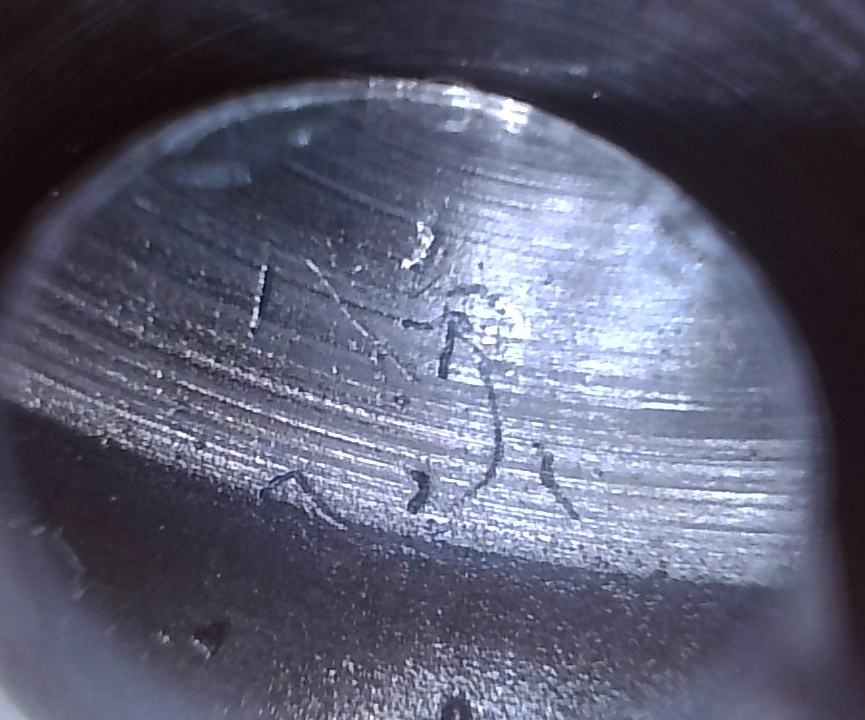

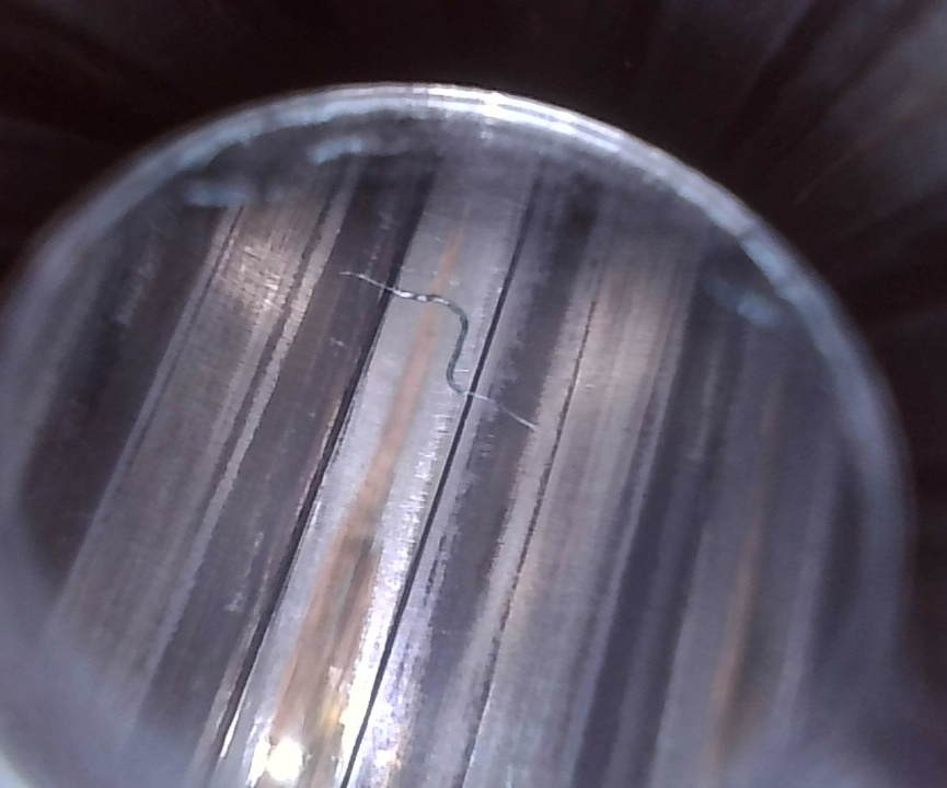

You have barrel worms as indicated by the many random looking little trails in 1708549824623 and 1708549805937. Bad deal.

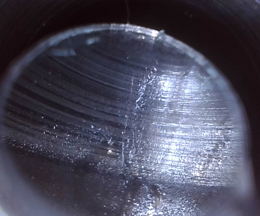

Pic #3 is just a piece of lint or something, nothing to worry about.
I can't tell what is going on in Pic #2.
But, barrel worms...fortunately they are not contagious and your other firearms are PROBABLY safe at this point. I hope you can get them under control.

The squiggly lines just look like threads off of you patches or similar. It does NOT look like etched metal (barrel worms lol).

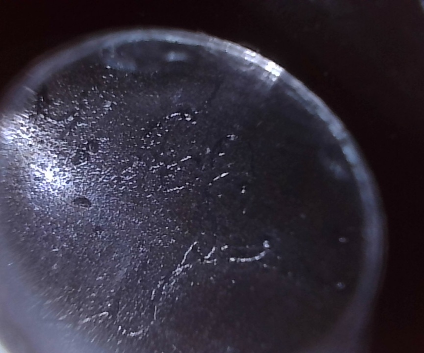

If I am seeing it right, at 2:30 in the vid there appears to be some copper. Please do not go full retard trying to get it out. A good solvent (I like Bore Tech Eliminator for general cleaning) will get out and lumpy deposits of copper. A bit of remaining copper wash is zero problem and you’ll likely do bad things to the barrel trying to get it out.

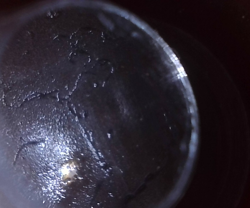

Thanks Baron. I am sorry I meant 2:26. This. What is this line? Boretech Eliminator is all I used.

This is not in metal you mean? Its just fabric?

I think "lines" like that are from drilling the bore with a piece of swarf trapped on the drill bit. I have a few Rugers and a Howa with worse but they are very accurate.
No, not that one. That does look like what @Robert4 said. Some superficial scratches. There were others in first couple of pics that just looked like thread to me.
And the line seems like a scratch from when the barrel was rifled…but again, to me it looks superficial.
