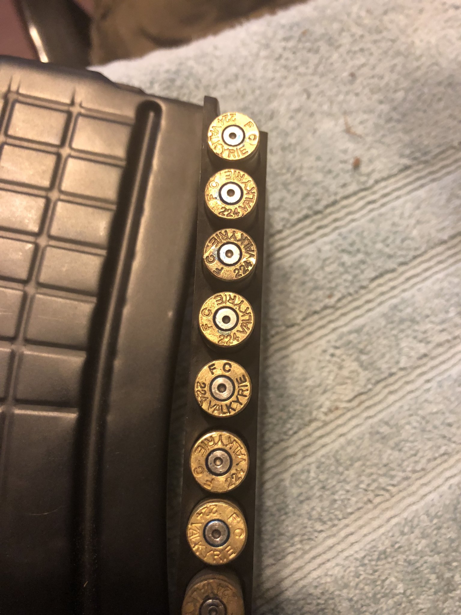

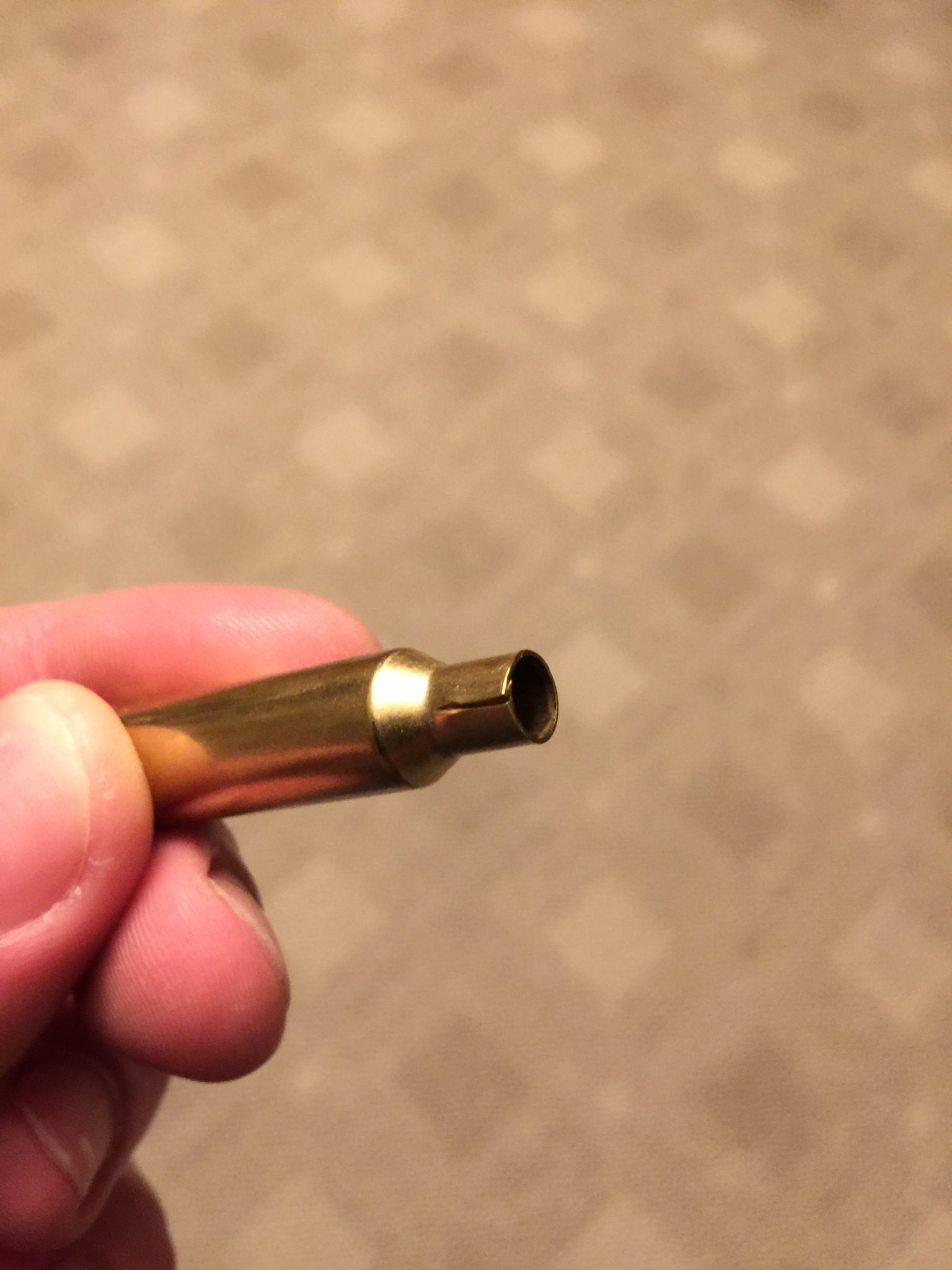

Has anyone else seen this happening? The Scheels store in my state took the msr 15 off the shelf due to this issue. I, like others, thought the blown primers was a batch issue at the least, or QC negligence at worst. I’m going to call savage as soon as I can and raise Kane.

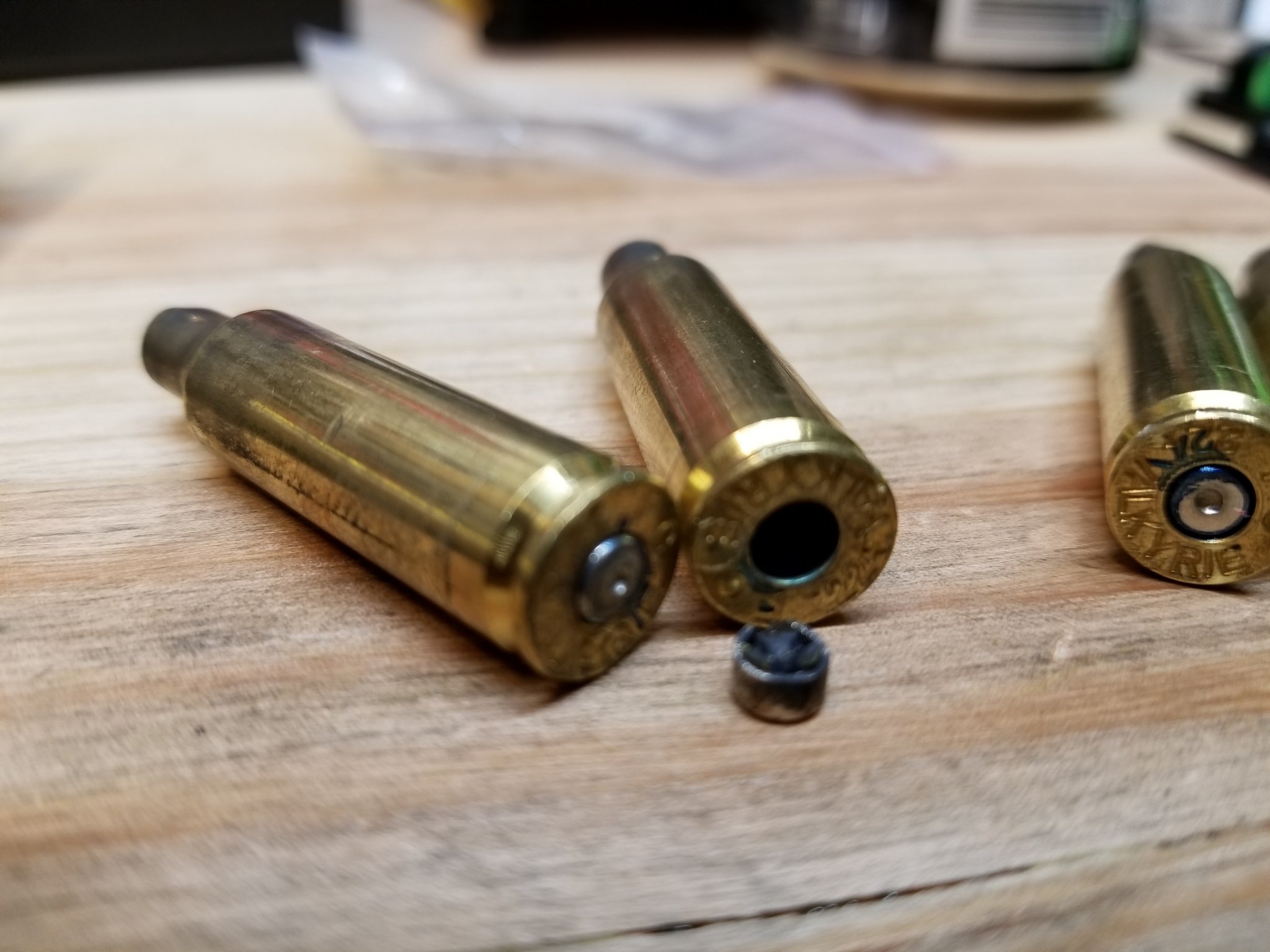

Here’s a few pictures. No joke, this fell out of mag well when I pulled it out of the box.

For many of these reasons alone, as soon as I can get the necessary pieces to reload my own I plan on starting. There are a myriad of variables that could cause the blown primers...but I will say that the case of factory ammo that I'm currently running through has shown only occasional signs of very slight pressure. The first case showed heavy pressure signs apart from the blown primers. Accuracy has been pretty good overall out of the second case. I'm out of the country this week on vacation but I will try to check in and be a little more specific at a later time, right now the wife is on my tale about getting out, so....I'll check back in later. Let us know how the rifle operates once you've run a few rounds through it. I'd give it a very thorough cleaning and be very particular about watching for signs of pressure out of the first batch of ammo.

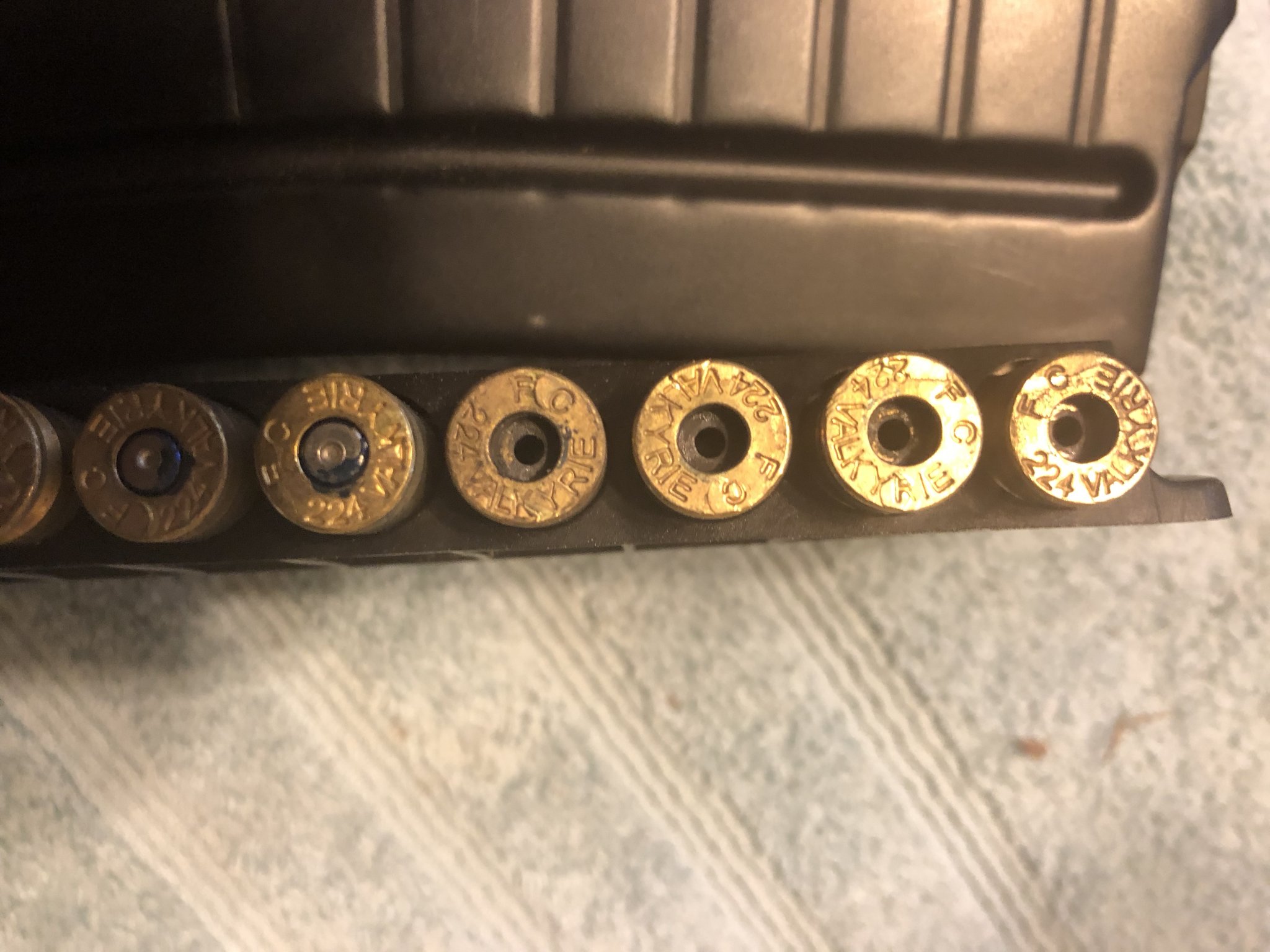

Only had time to run 20 rounds. Glad to say there are no signs of high pressures or extractor/ejector issues. However, just as you, I plan on loading my own rounds for coyote and target shooting to completely avoid the primer issues. I’ll let y’all know more in the future when I can really put some lead down range.

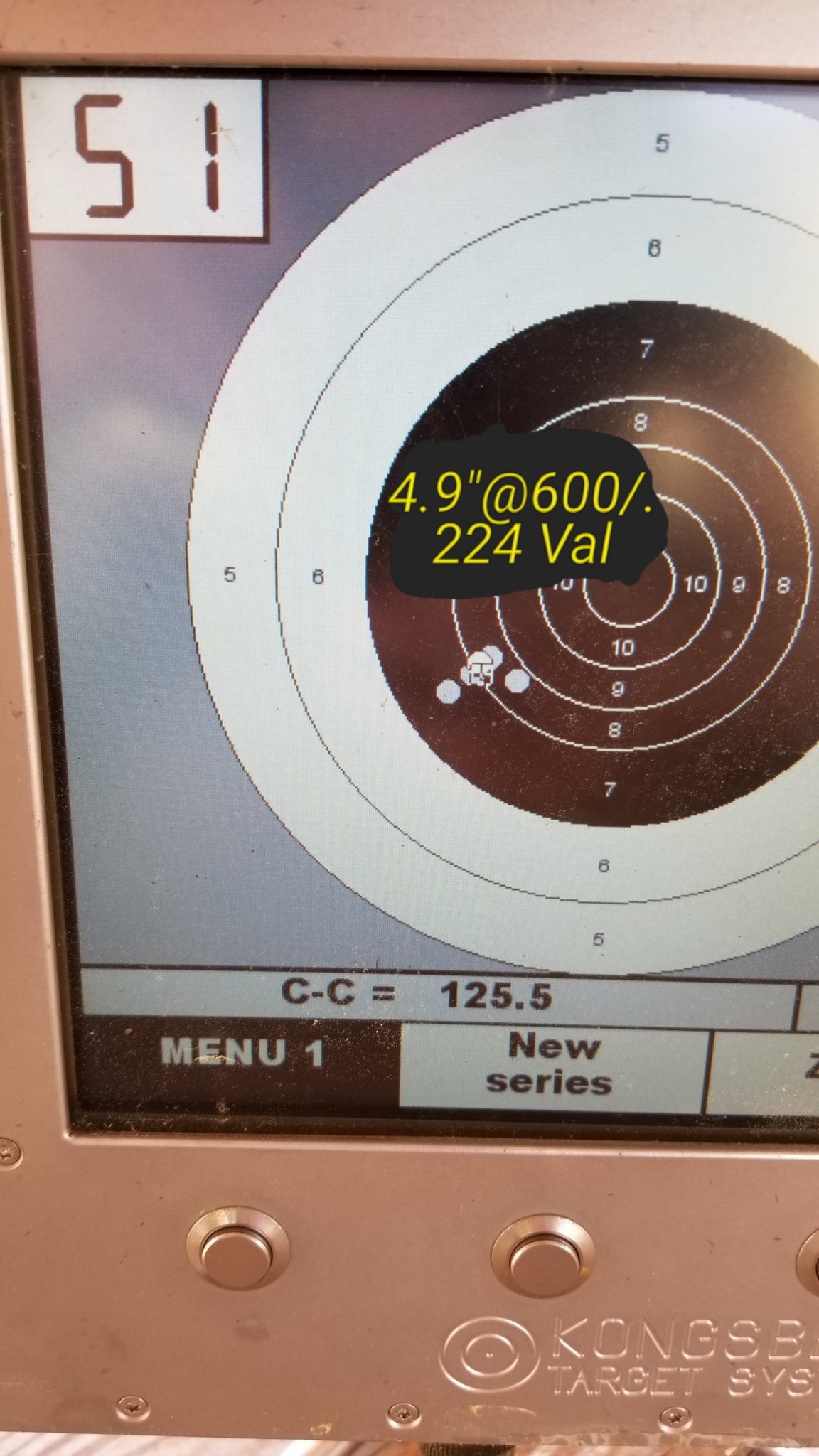

I put 80 rounds of the 90gr FGMM through mine today with no issues. Mine 1:7 twist Savage barrel does like the 90s. I had several sub moa groups when I did my job.

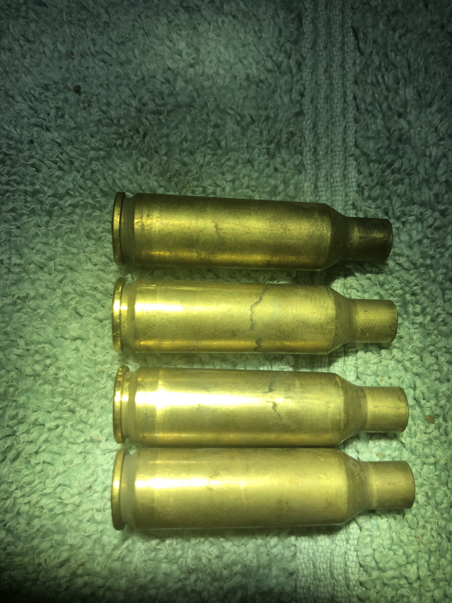

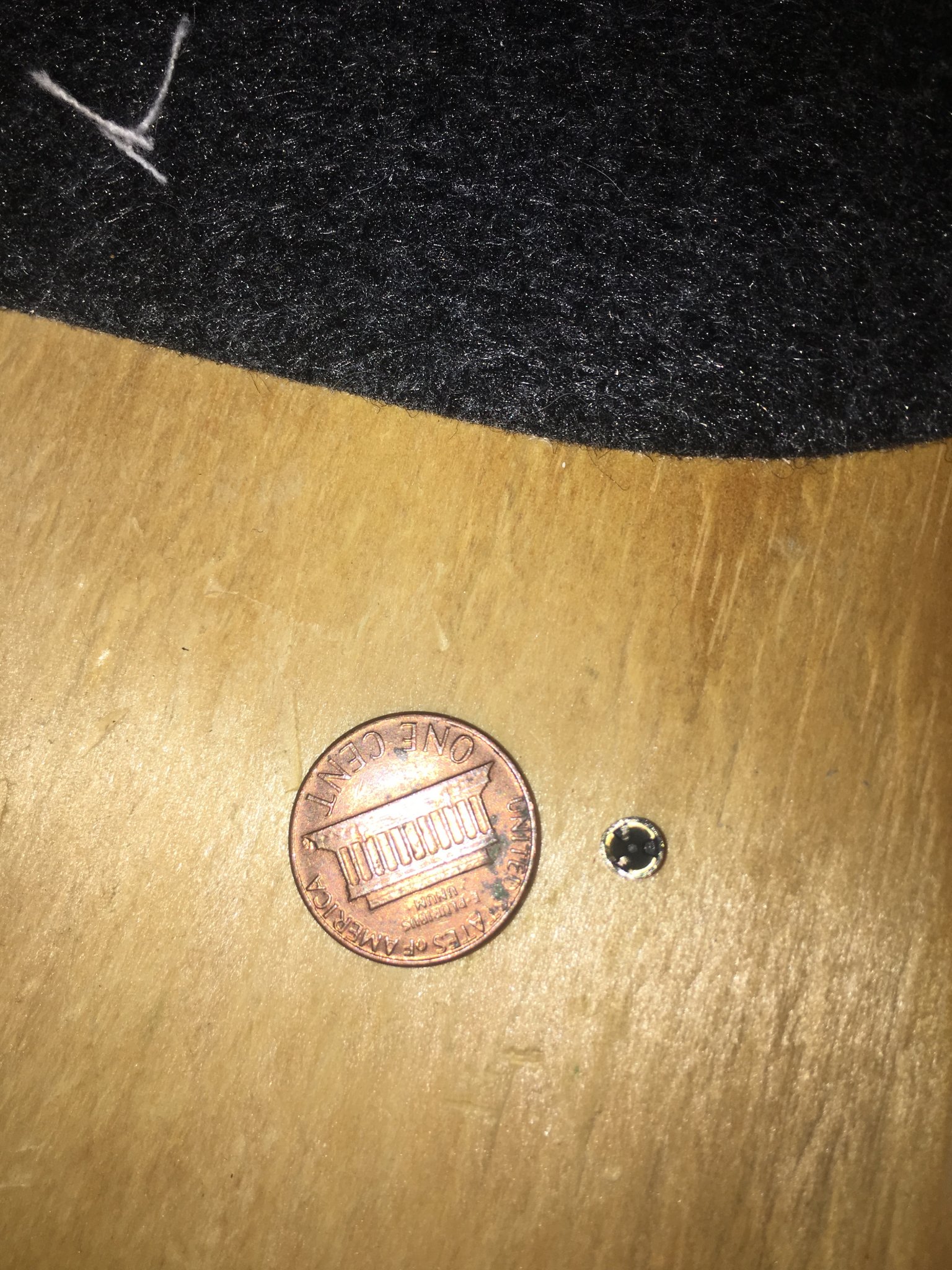

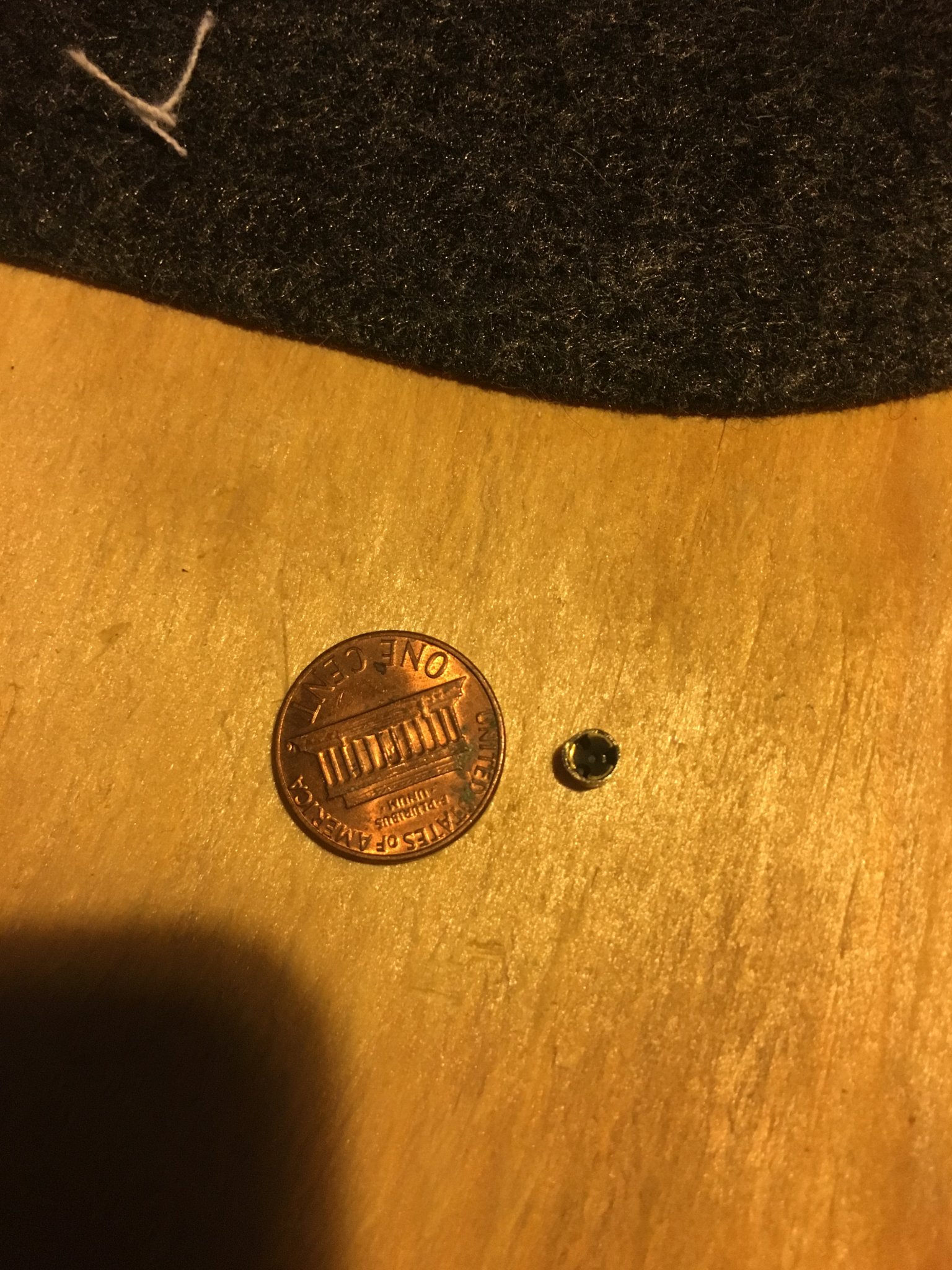

I just got 300 new unprimed federal .224 brass. The primer pockets felt sloppy and loose when placing primers. I bet I will pop primers with moderate loads. The brass quality is crap. I had cracked necks fresh out of the bag!

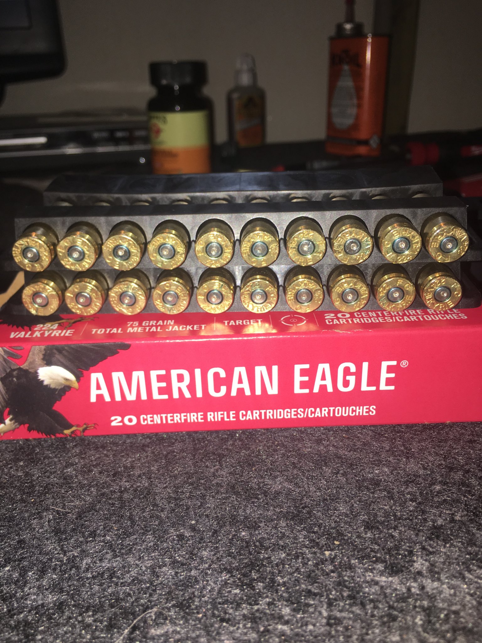

I got my first 224 Valkyrie Savage rifle back in the end of Jan fired 10 rounds had 3 primers out, Called federal and shipped it all back on feb 8th because they thought it might be a ammo issue plus sent all my boxes of ammo, they got it made a decision that it's something in the chamber, so off to savage it went. They received it and I got a new rifle sent with no explanation from Savage what went wrong at the end part of April, fired the new one 2 weeks ago and 2 out of 8 primers came out. So the 2nd rifle is back at Savage and haven't heard anything yet on what we are going to do yet so I called two days ago the rifle has been there for 2 weeks and they are waiting on a gunsmith to look at it! Needless to say I'm in the customer service biz and I'm not very happy right now. Good thing I have a 22 nosler that works! Maybe I should have waited to get bugs worked out?
I put 100 rounds of 90g SMK through mine yesterday. I didn’t see any blown primers but my primers all had blue sealer on them from the factory. Does anyone elses? With factory loads I was seeing 1.25 to 1.5 MOA groups. This needs a hand load and decent brass. My head stampings showed swipes.

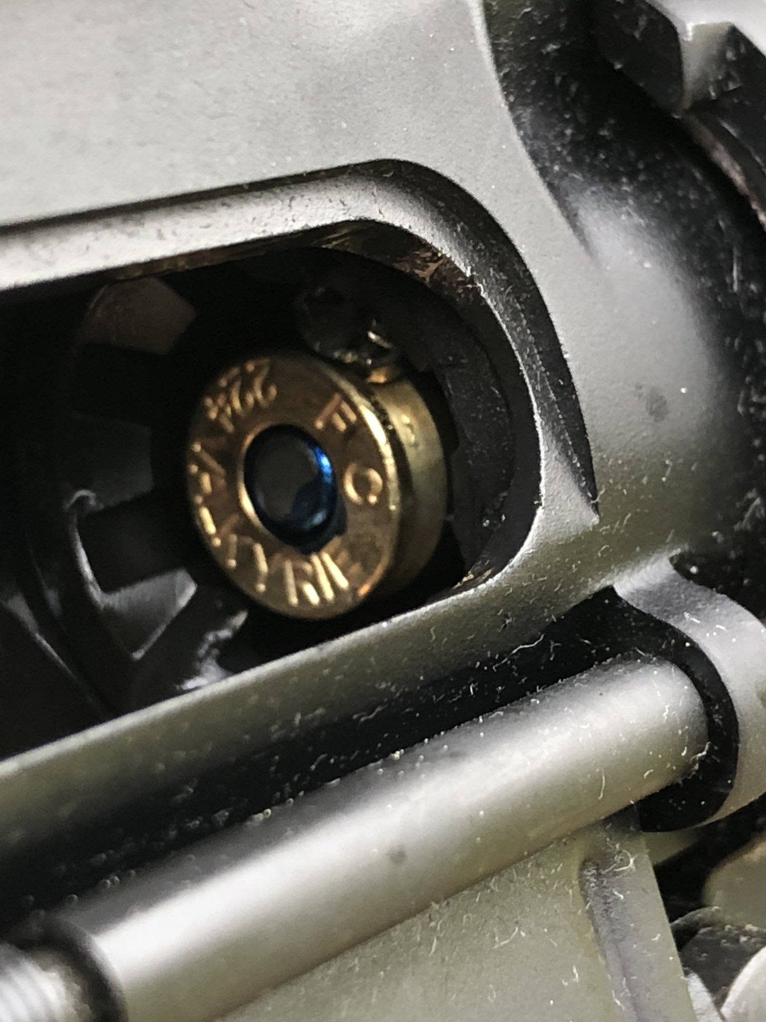

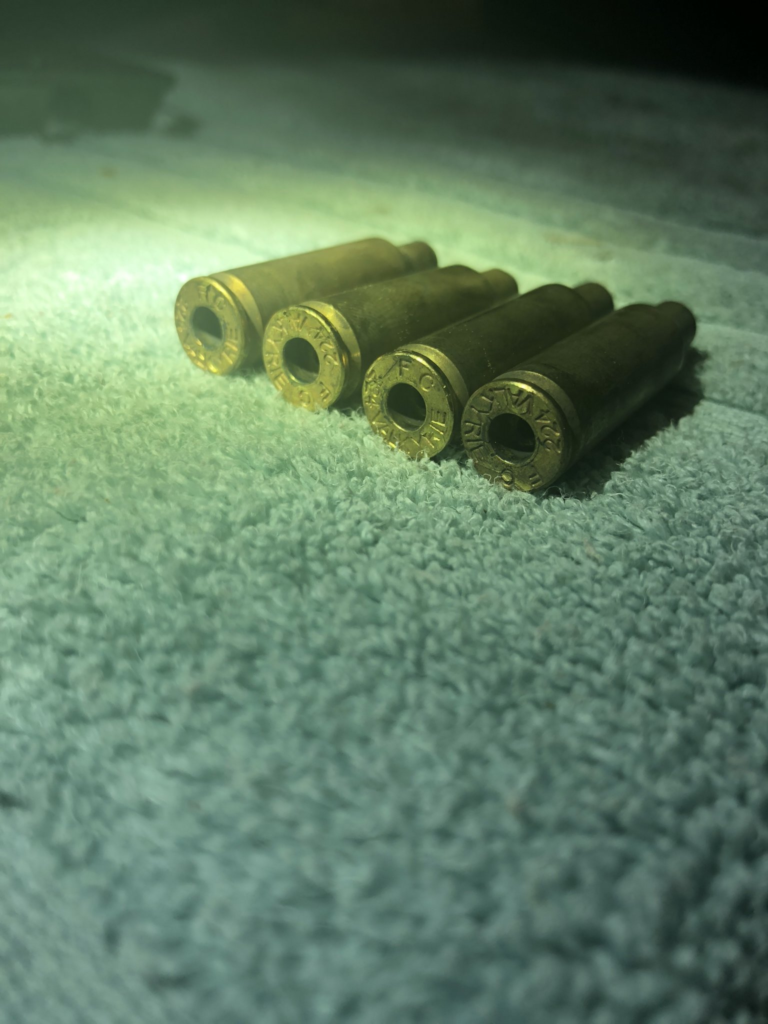

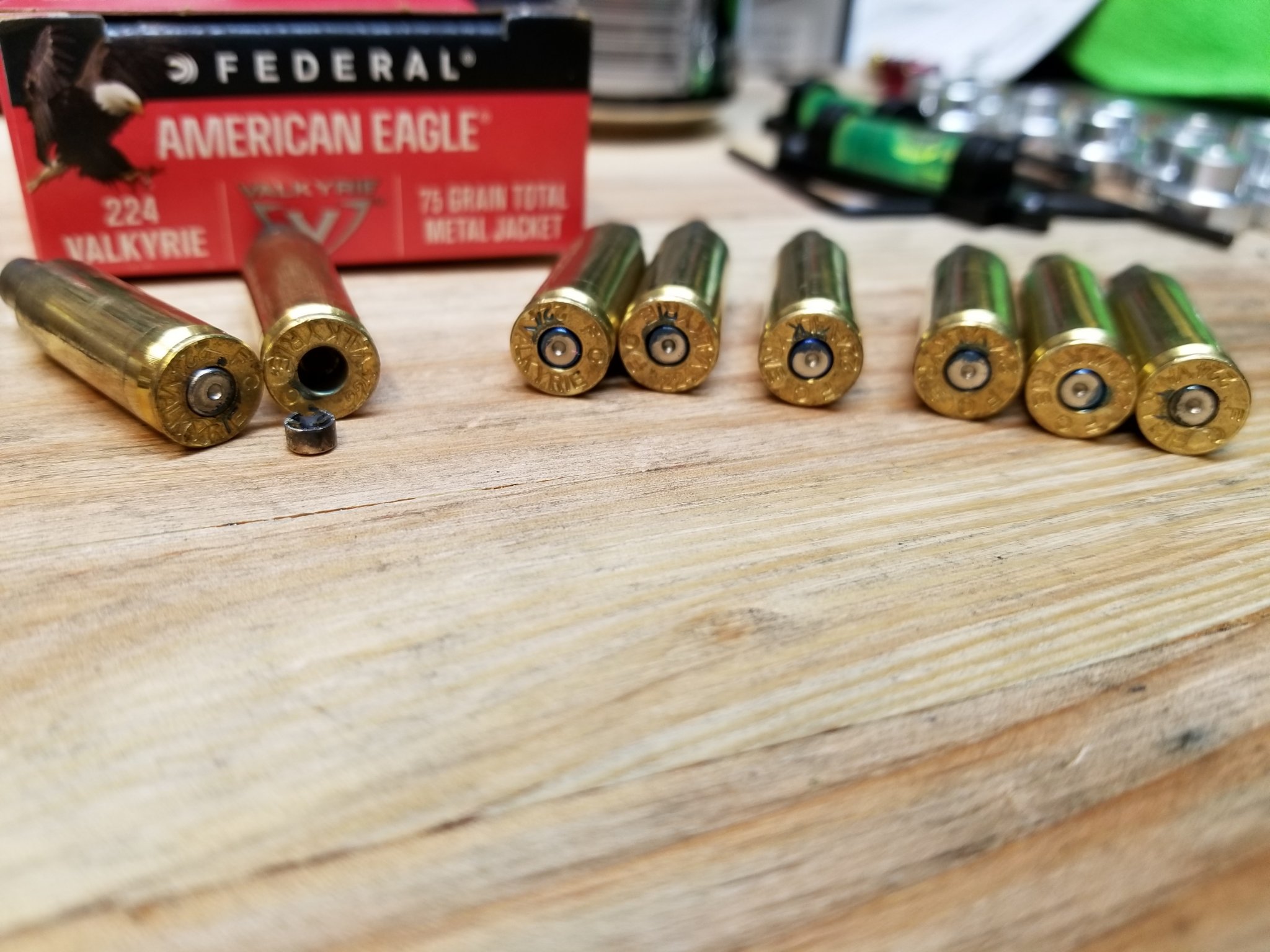

all of the ammo I have blue in primers has anybody tried any other brass?
Lol they’re not glued in, it’s a sealer applied after the primer is seated to prevent moisture from penetrating the round. Has nothing to do with primer retention.
The primers are blowing out because you’re rifle has a shitty chamber. Typical Savage quality.
This statement makes no sense. If a primer is seated properly you won’t need a sealer. How does a chamber cause blown primers? Let’s apply logic and science. Primers popping out are ONLY due to one law of physics - the pressure being generated is greater then the force keeping the primers in place. A chambered with a go/ no go gauge is incapable of “causing” blown primers. The head of the case is against the bolt face. It’s called crap factory ammo. Take that savage and find a buddy with star line brass that can reload for you. I bet you will be fine.
Perhaps you should call Federal and educate them then because they seal all of their primers for this reason. Any military ammo is also sealed for the same reason, to keep out moisture. No, a properly seated primer is not water tight.
As to the chamber, yes it's the chamber. Savage has even admitted this and recalled all of the rifles from dealers. Tight headspace and short freebore can both cause overpressure conditions and that's exactly whats happening.
You say crap Federal ammo but the irony is that this problem is centered around Savage rifles, no others. I'm a member of a few groups on Facebook for 224 valkyrie and nobody is having these problems except people with savages. Mine and my buddies Craddock barrels all hammer with factory Federal. Even the cheap American Eagle hovers around 3/4moa but has ES's of 40-50fps which is still tight for what's considered plinking ammo. The Gold Medal is sub half minute with ES's in the 20fps range and SD's below 10... So yes, totally crap ammo.
You bought a piece of shit rifle, got shitty results, and want to blame the ammo that people who bought quality rifles are getting good results from.
Reactions: Jeffd
Redneck answered this pretty well above. Have you ever looked at Federal ammo out of the box? All of them have the blue sealer.
And as stated, a bad or out-of-spec chamber will most definitely cause over-pressure. It's no different than when you improperly form or head-space your brass while loading or if you develop a load for .020 off the lands and then jam the bullet into the lands when reloading. It's called logic and science.
My week old Recon going back to savage :( . Half dozen or so blown primers also every few rounds it would not go into battery and had to use the forward assist. I am using the American Eagle loads and was seeing an avg of 3000 FPS using magnetospeed. I hope they get this right or this will be my last savage rifle.
I spoke with savage arms today the agent acknowledged there was a problem but could not tell me what it was only that they were waiting on parts to fix the firearms they had. And they could not give me an ETA on when the parts will arrive so I guess when mine gets to them they will have it for a while so I am bec and they could not give me an ETA what the parts would arrive so I guess when mine gets to them they will have it for a while so I am going to consider it a lost cause and go a different route and hopefully someday I’ll get the rifle back and it will work.
There's a lot of people who have sent there rifles back are are told the same story. Some sent there's back months ago and I haven't seen any reports of anyone getting their rifles back. You're probably in for a long wait.
