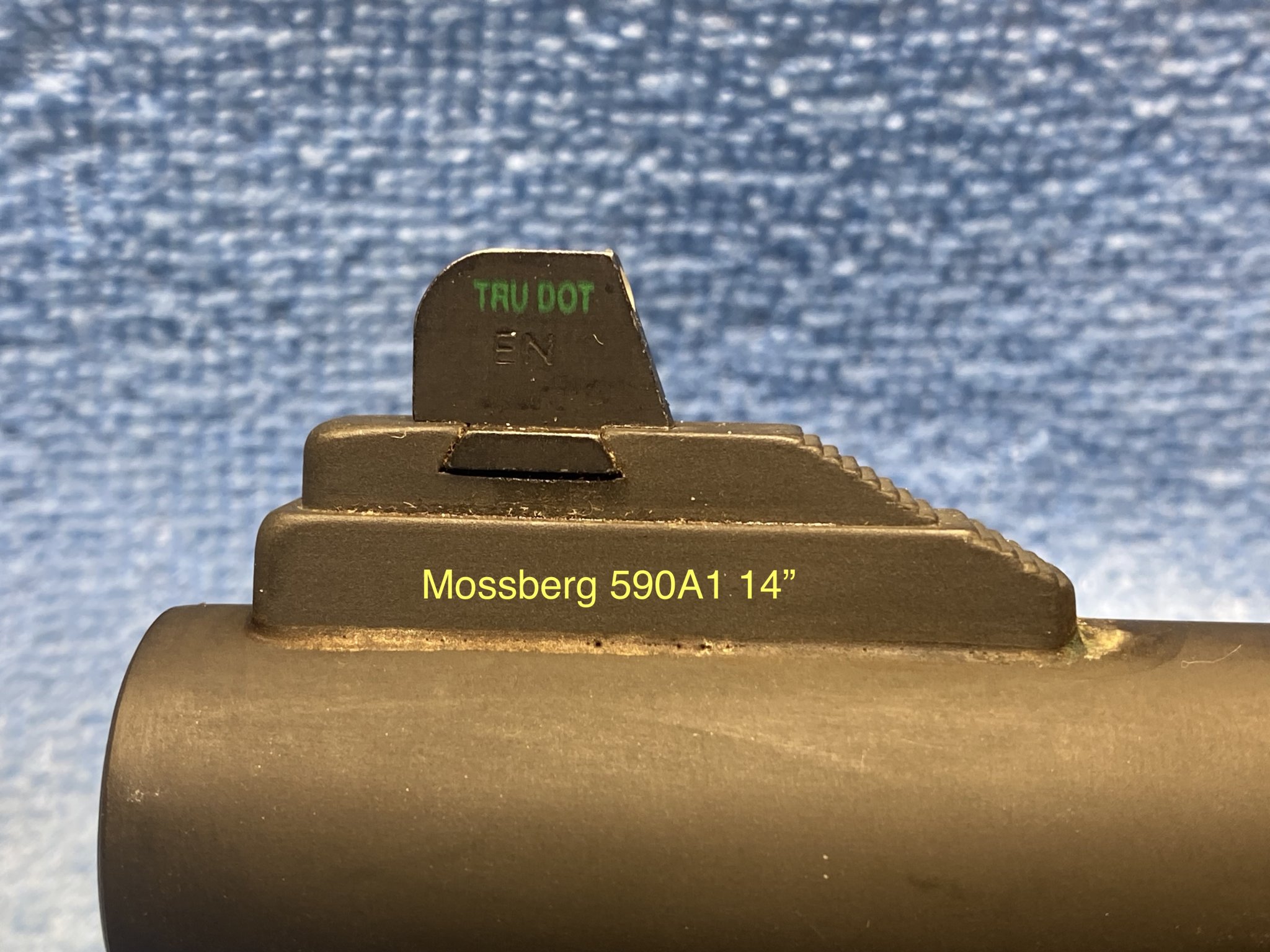

Hey all, been trying to get more information on the Mossberg 590A1 SPX ghost ring setup. I'm trying to find a part number to install a tritium dot but even Mossberg's own customer service couldn't help me. The 590A1 comes in like 4 different ghost ring setups so finding the correct part I need is proving to be rather difficult.. Mossberg can't even tell me if a fiber optic front sight post ships with it or what... :/

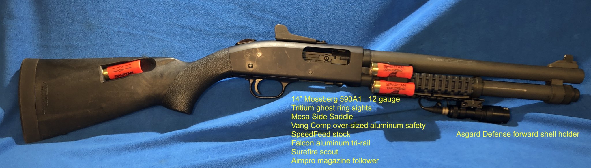

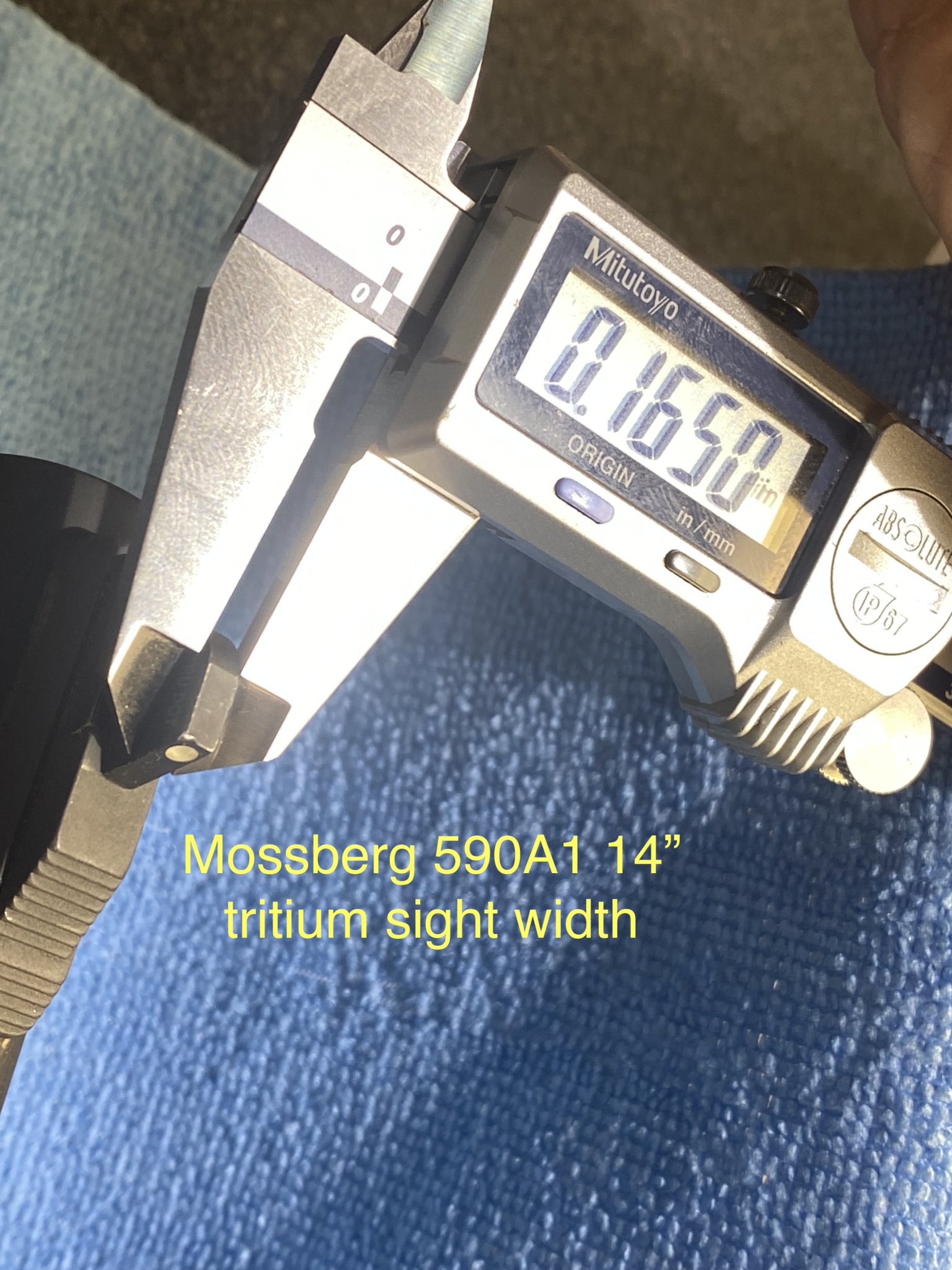

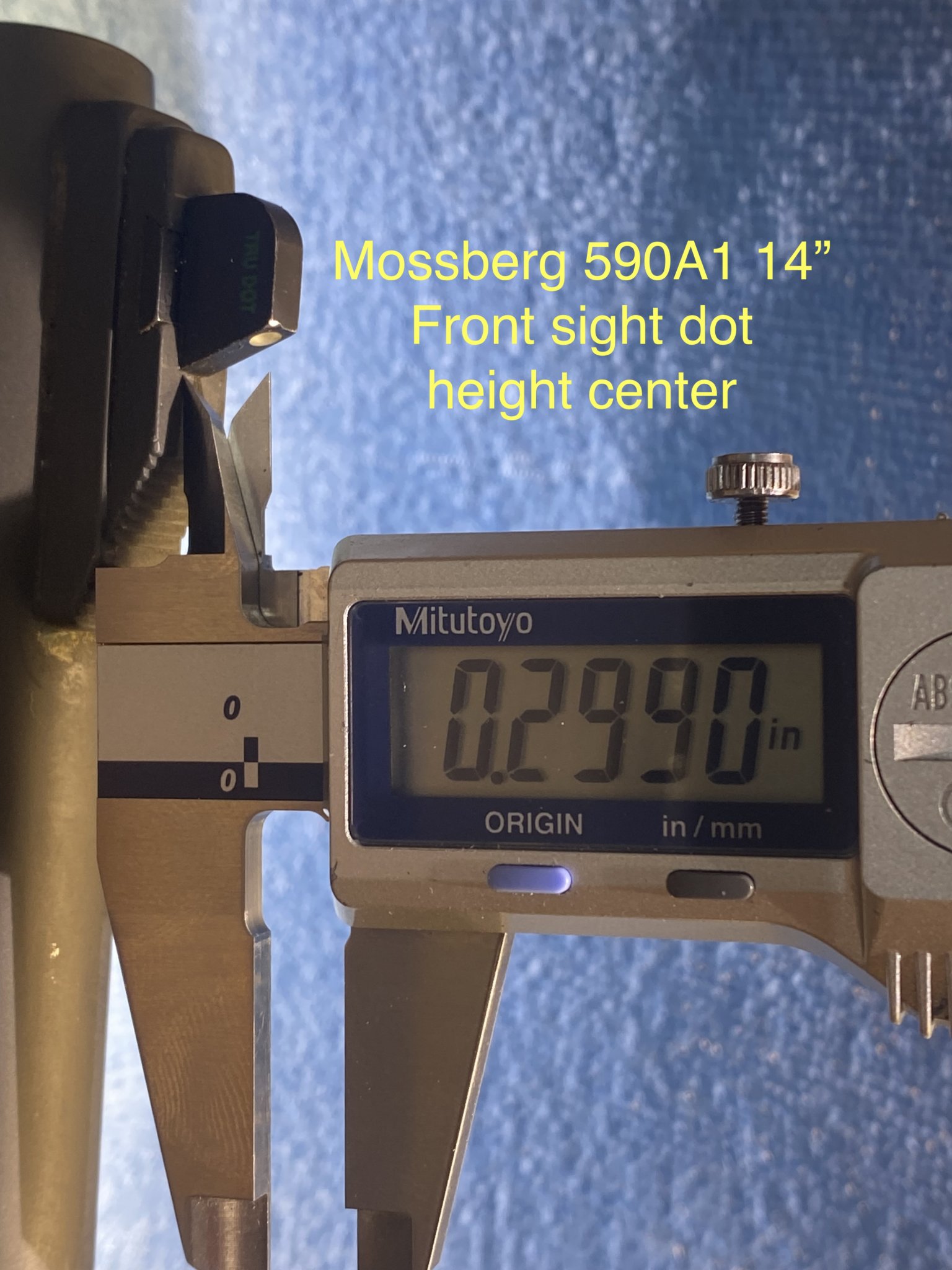

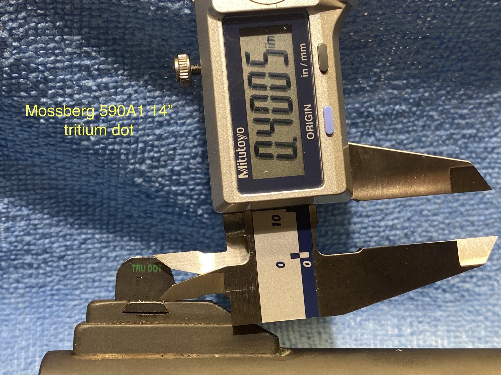

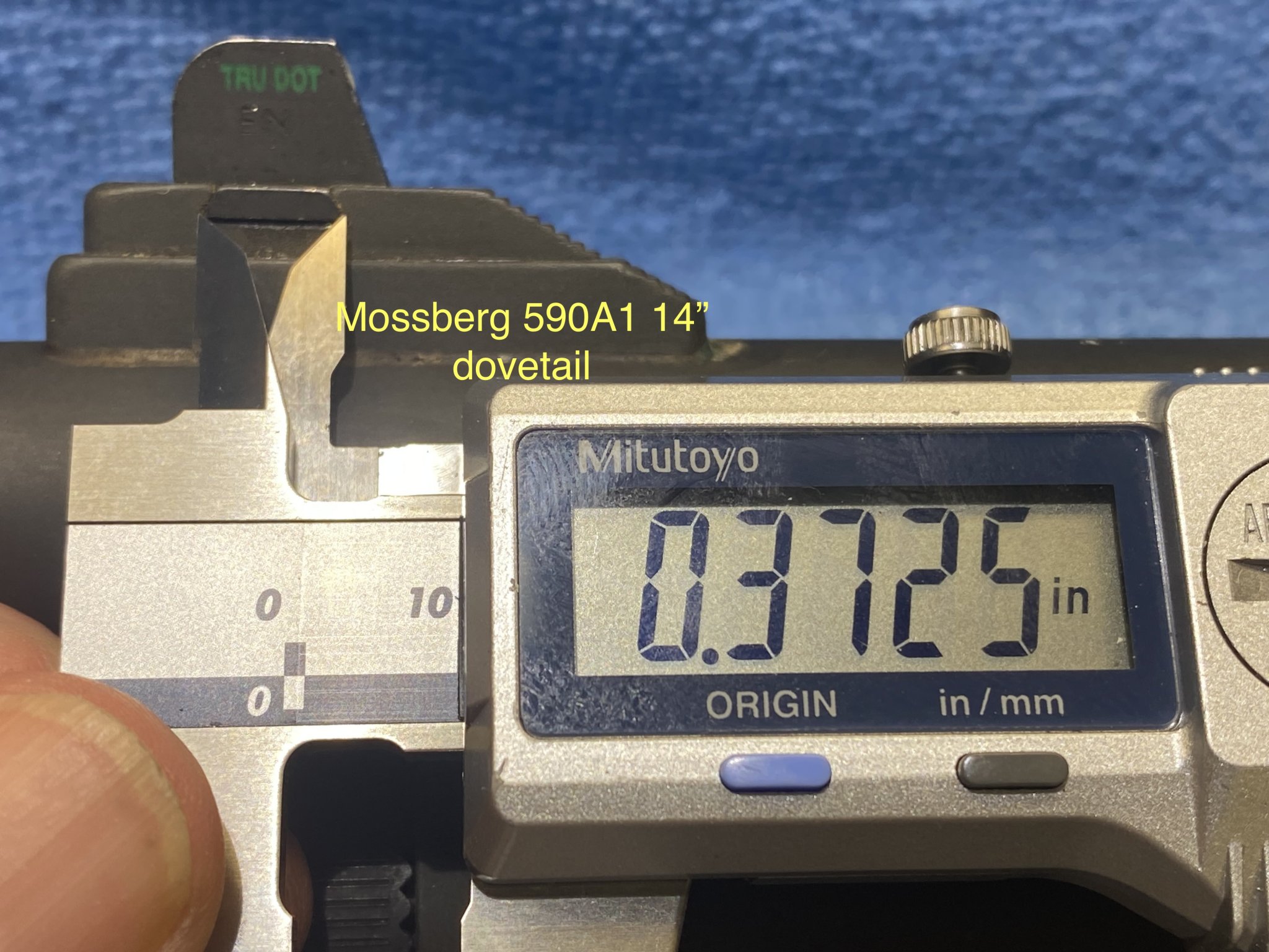

Here are the front dimensions from my Mossberg 590A1 14". Any other brand of
sight close to these dimensions can be fitted to your dovetail. There may be several front sight options based on the factory barrel length. I have had several SBS shotgun barrels (mossberg & remington 870's) ported etc. by Vang Comp; consider contacting them to see if they have any sights for sale; they routinely sell the rear ghost sights +/- rails etc.

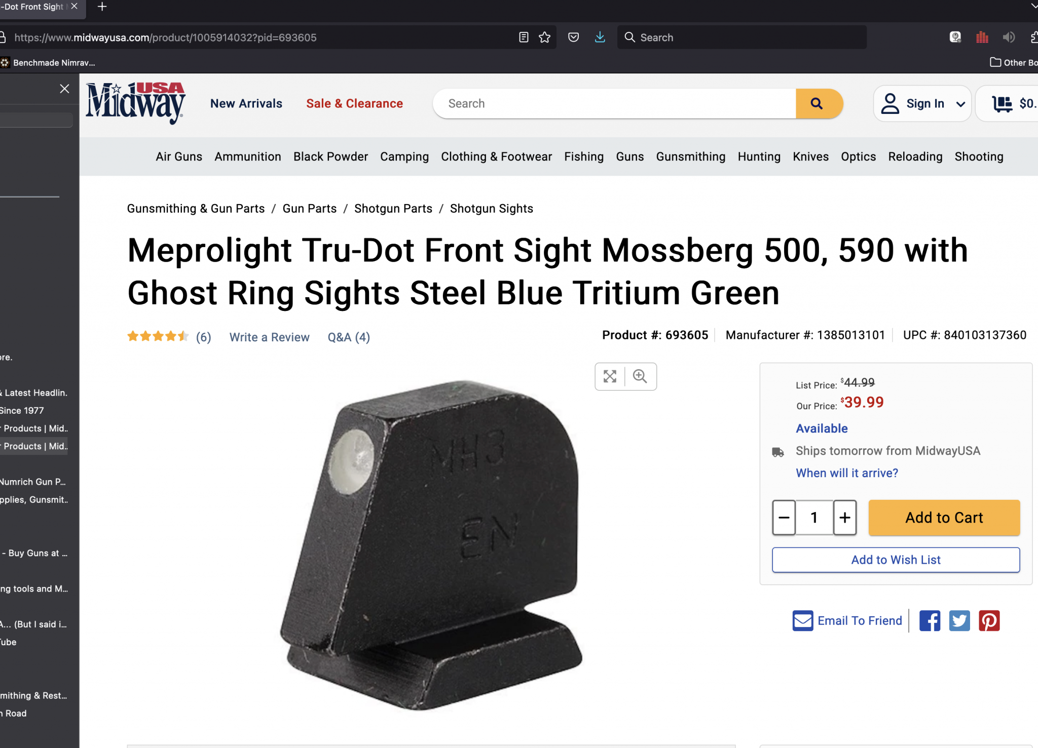

I looked @ Numrich but no front sights available. Bingo- Midway USA!

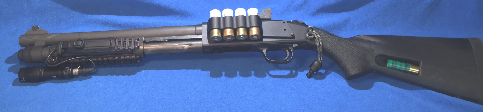

IMG_3347Mossberg 590A1 with Asgard Defense Forward Shell Holder Photos copy 3.JPG
