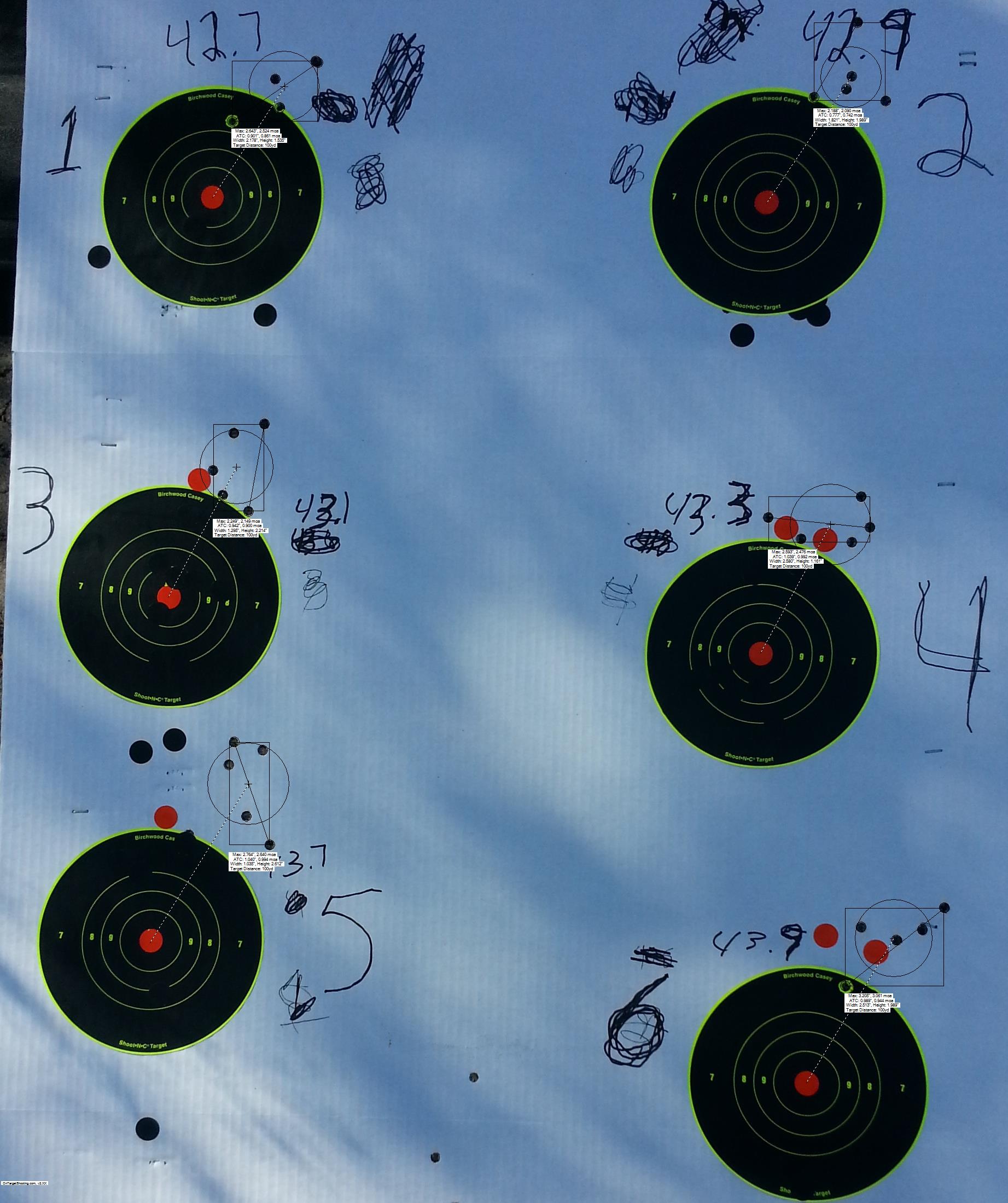

well now if it I can get it to group...
testing today went..
42.7gr
AV 2736 ES-28 SD12
42.9gr
AV 2754 ES 40 SD16
43.1gr
AV 2768 ES34 SD12
43.3gr
AV2783 ES12 SD4
43.7gr
AV2797 ES35 SD13
43.9gr
AV2799 ES41 SD 20
nothing seems to want to group. I'm wondering if I changed seating depth? I'm at 2.800 maybe go to 2.820?
well I've tried 2.800, 2.820, 2.830 and 2.840 and no luck with groups. Very frustrating, the accurate powder was slow but had really good groups, the h4350 is fast but won't group worth crap! I'm at a loss, any ideas?
