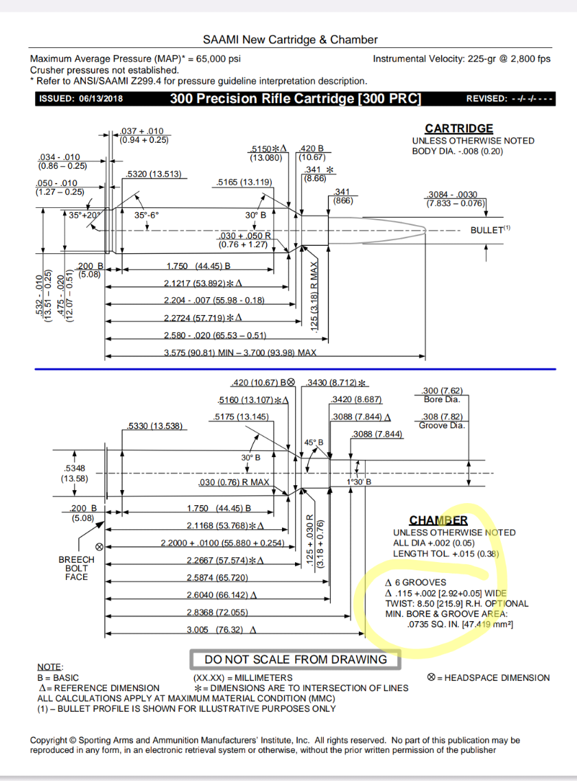

Here’s a nugget for you…
Hornady based the
300PRC cartridge on a 1-8.5 twist.

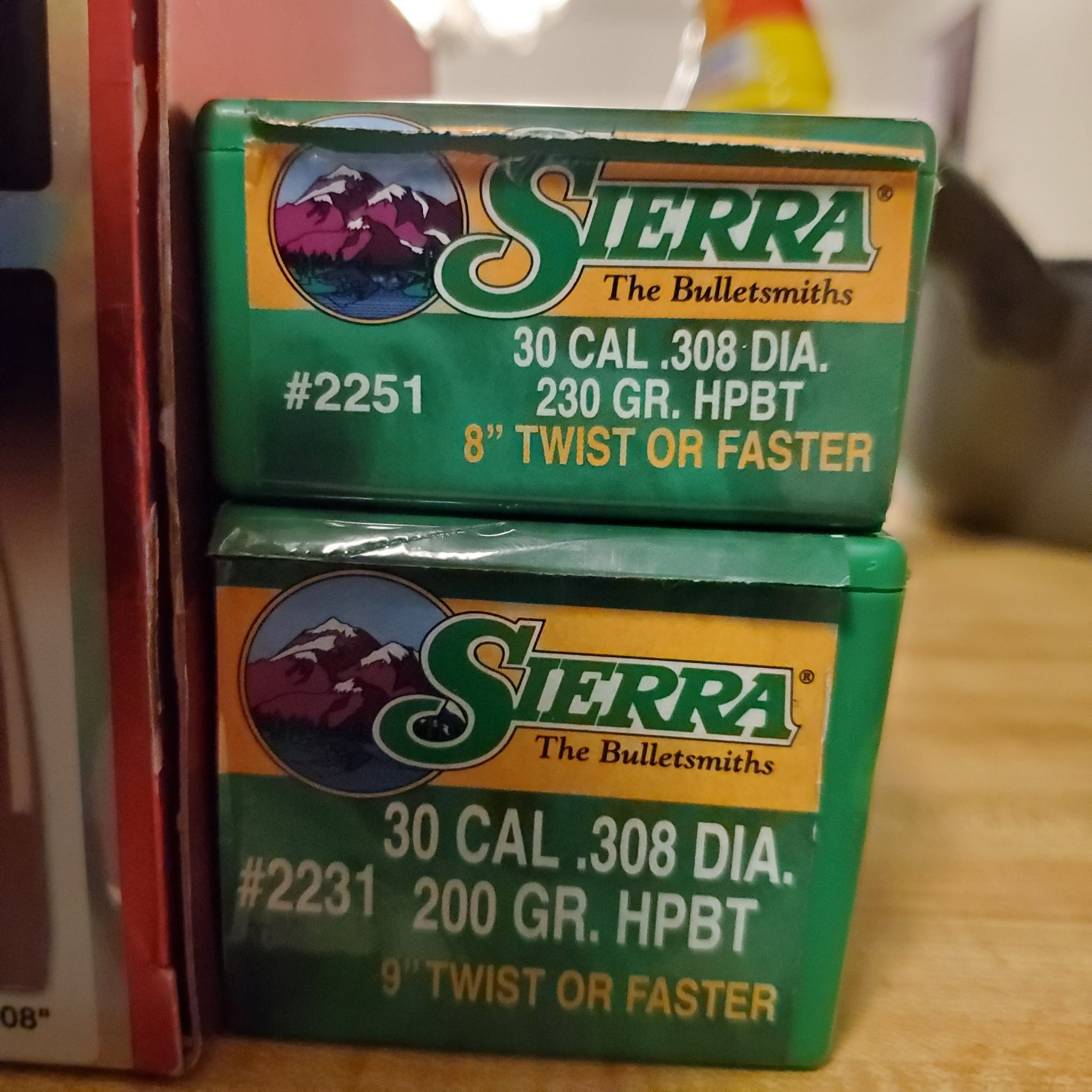

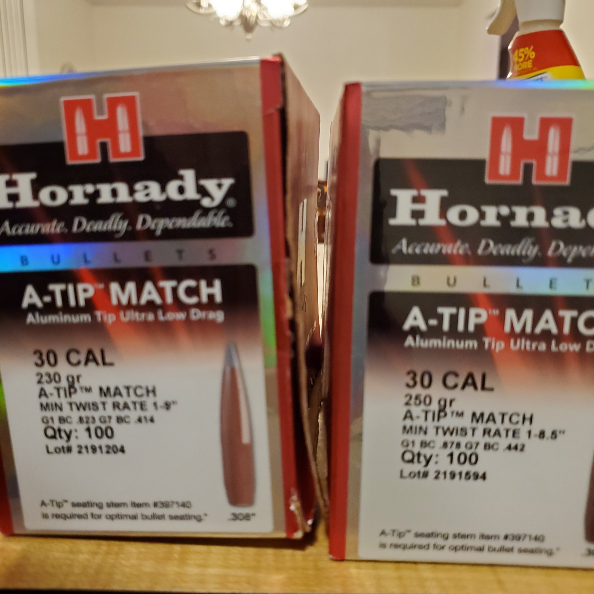

Exactly, and these match bullets require a minimum of 8, 8.5, & 9 twists... there are a bunch more high BC bullets that you may want to try in this category, but the correct twist rate is needed...get the 8 twist and most available common bullets used in LR are covered... Or not. Altitude and temperature can help or hurt the barley stable bullet.
I just rebarreled my 300 PRC (as in just... I got to stand with Marc at Spartan Precision and watch his mastery on Friday), and I moved up from a 9 twist to a 9-8 gain.
A 10 twist is fine for a 308, it's on the edge for a 300 PRC, especially with even more heavier bullet options out there now. So, why gimp yourself from the go?

Twist rate, 1:8 if you want to shoot anything over the Berger 215's and 1:9 if you are only going to shoot the Berger 215's and lighter bullets. I would also go with 1:8 if you plan to shoot the monolithic bullets.
