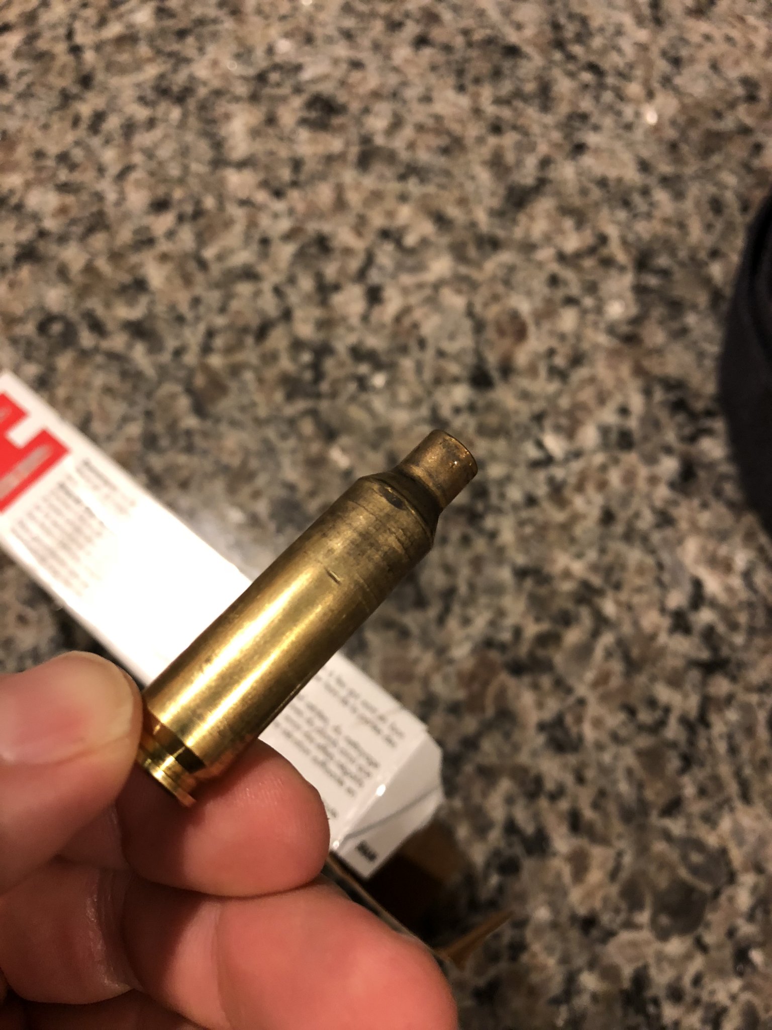

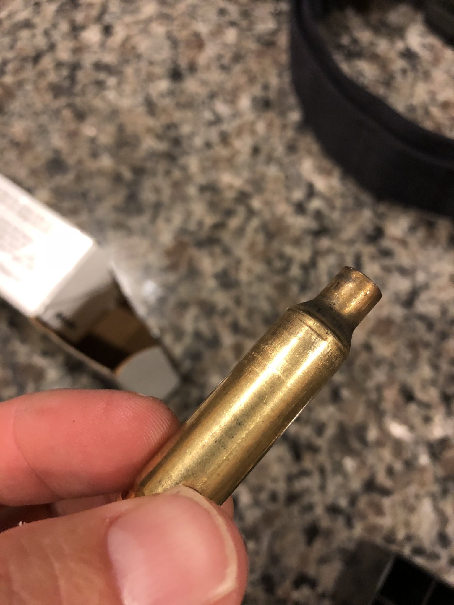

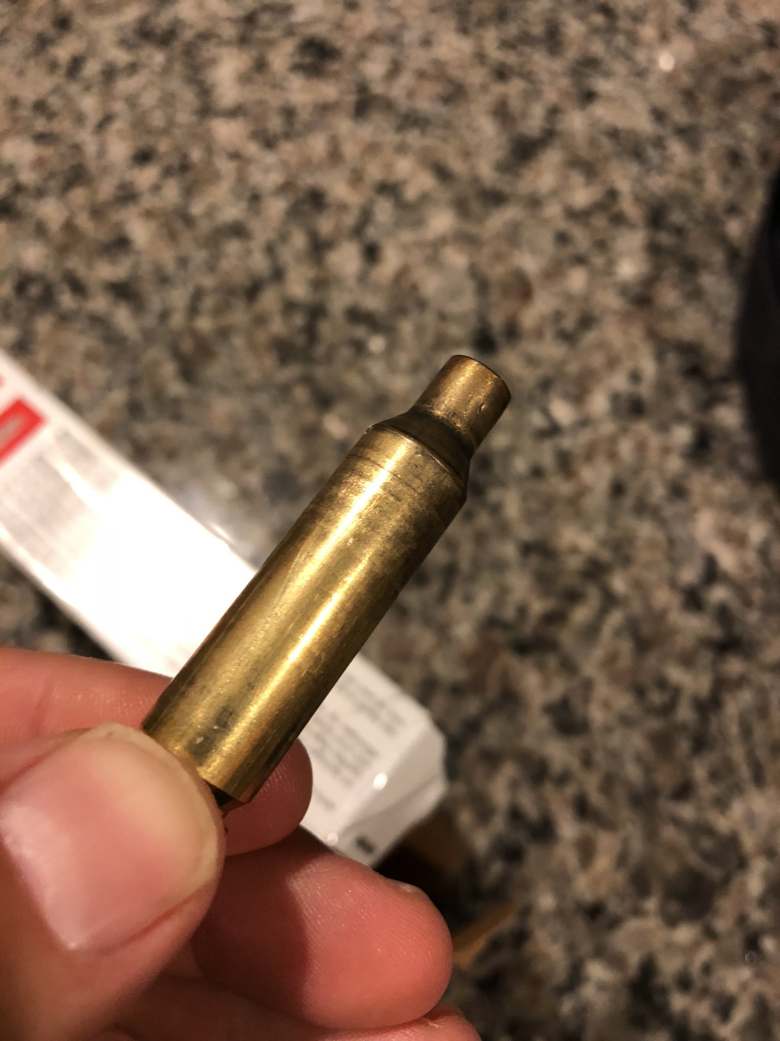

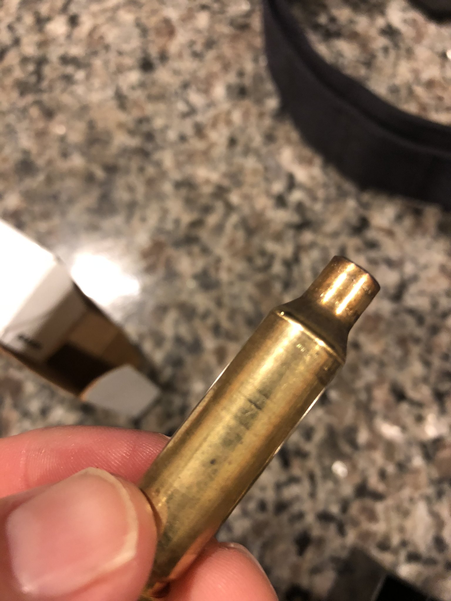

So from the very beginning the brass has been coming out with rings just below the shoulder and continue down just above half way on the brass. They are concentric rings around the brass.
The chamber also has the rings from what I can see inside. I can’t get very good pictures of the chamber, but I have pics of the fired brass.
I think the chamber was cut incorrectly.

Looks definitely like tool marks in the chamber to me. Might explain the cycling problems but it should still shoot okay, at least a rifle of mine that had really bad tool marks in the chamber did.
