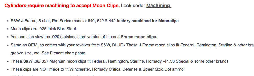

Do you have any of the clips that came with the 640? Maybe they are thinner than TKs. Are your clips marked .020?
Federal is supposed work.......a number of choices are eliminated with the Clip; might try a different box of Federal. Also TK offers two thickness sizes, which one are you using ?

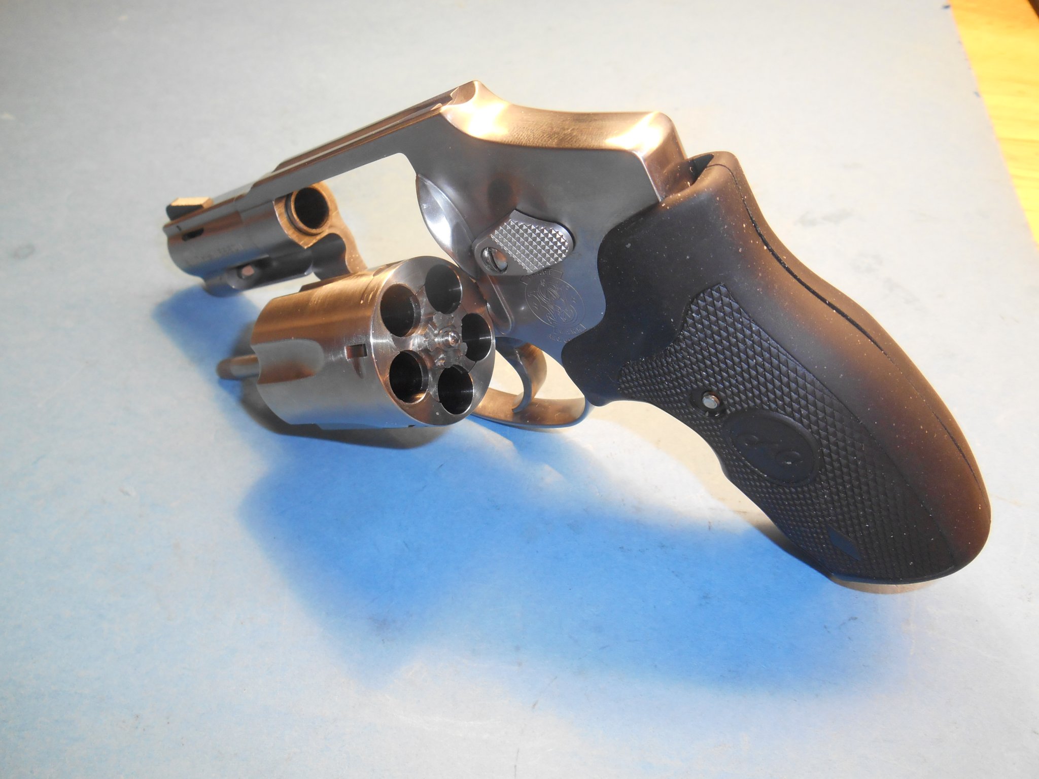

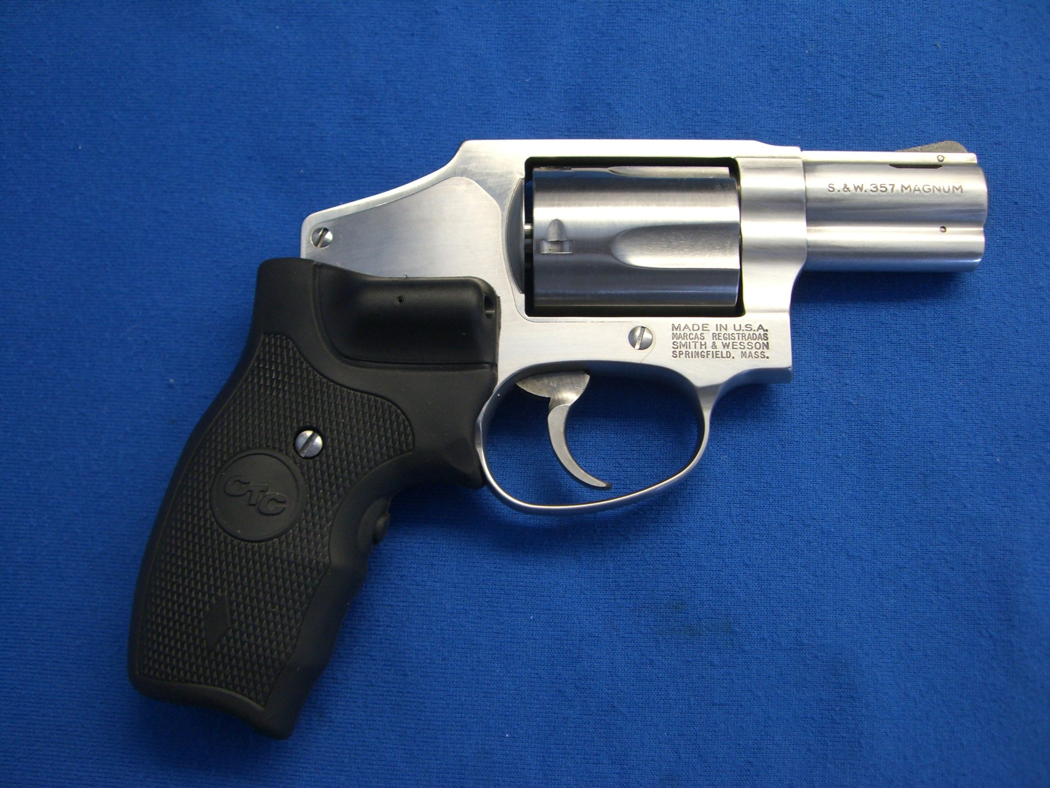

For those interested, the pistol under discussion is a 640-1; shown below is mine that does not have the cylinders machined to recess the moon clip.

(S&W makes a number of different models of the 640. The standard versions are not cut for moon clips. The performance center version, in addition to the action work, etc., is cut for moon clips. I have a performance center version.)
TK does make two different sizes of J frame clips. I think .020 and .025. If you think it's the extractor, sending it in is your best move.
