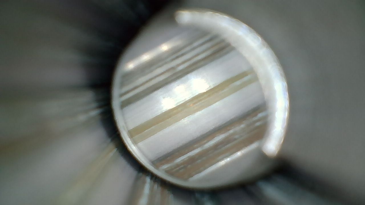

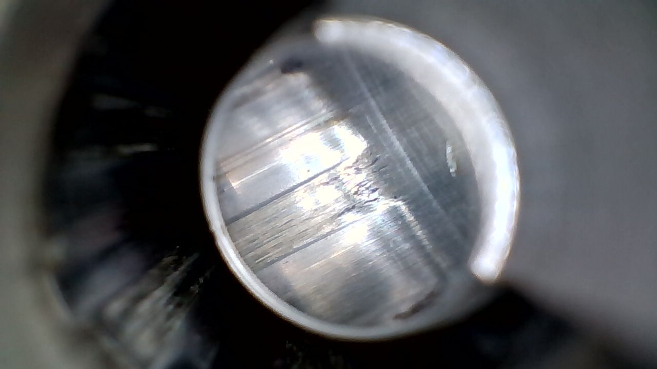

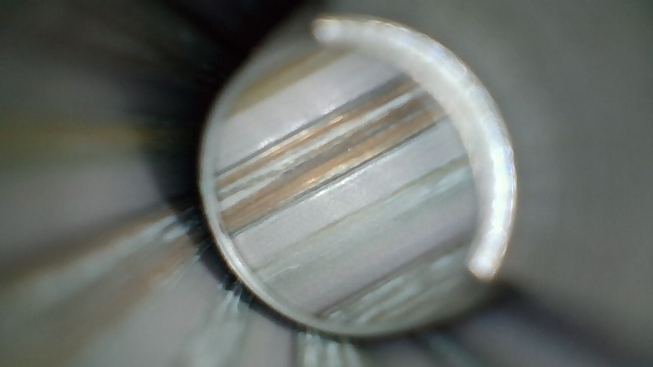

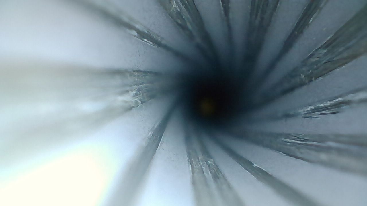

Can you guys please tell me what your thoughts on this barrel is. It was sold to me as new and Im a little concerned. Looks like some copper fouling and the throat has some strange marks. Maybe Im making a big deal out of it (isnt that what everybody does with a borroscope), but when I buy a barrel that is expensive and sold as new I want it to be new. It's a Desert Tech barrel .260.

It's definitely been fired and then cleaned, but it's hard to say how much it's been fired. Maybe just factory test shots?
Was it purchased from an individual, or factory, or some third party retailer?
From a guy on here who I think is a gun dealer. He said he took it on trade. I don't think dta test fires but not 100% sure. Maybe somebody will chime in.
Agreed that it’s been fired, I’d probably clean it down to bare metal then see how she looks. No fire cracking so it’s not like it’s actually been really shot up, and the lands look pretty freshly cut unless I’m reading that photo wrong.
Reactions: ____________
The brownish/golden/orange coloration is copper fouling. The reason why the copper fouling isn't bright is because it is oxidized. Think of it like a shiny brand new penny versus one that is old and brown.
The black in the grooves is remaining carbon residue (can also show up as dark grey depending on lighting). Doesn't even look like there's a carbon ring groove.
That barrel looks test fired and basically still new (I'd estimate under 20rds fired). The throat and leade picture doesn't show any erosion (edges of lands/grooves look well defined), pitting, or cracking (think cobblestone wall texture) that you would see on a moderate round count, let alone high round count barrel.

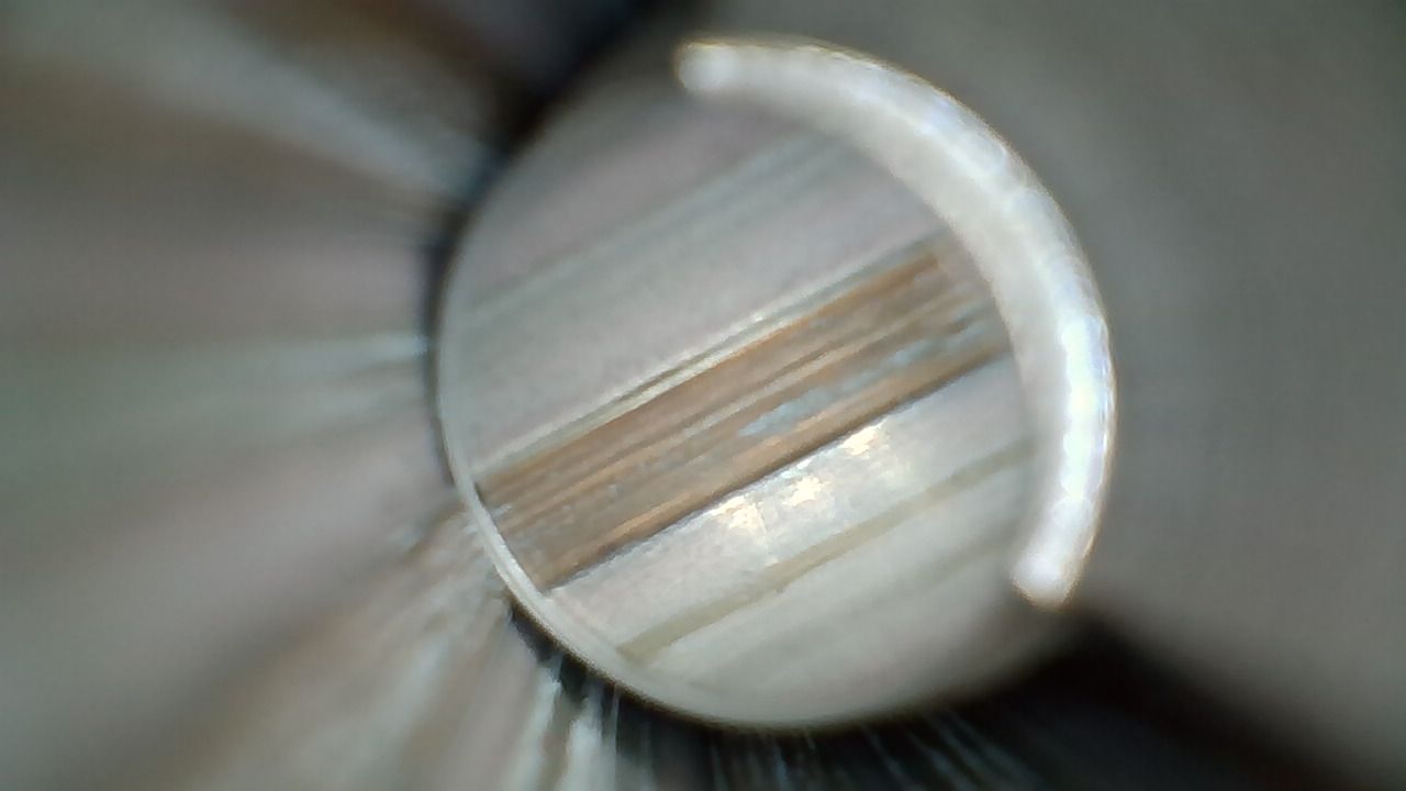

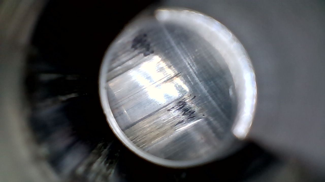

Here is a new barrel from desert tech, test fired. If you compare it to the original not in same ball park in terms of copper fouling.
Maybe Desert tech sold you a used barrel but that one has defiantly had a few rounds down it.
