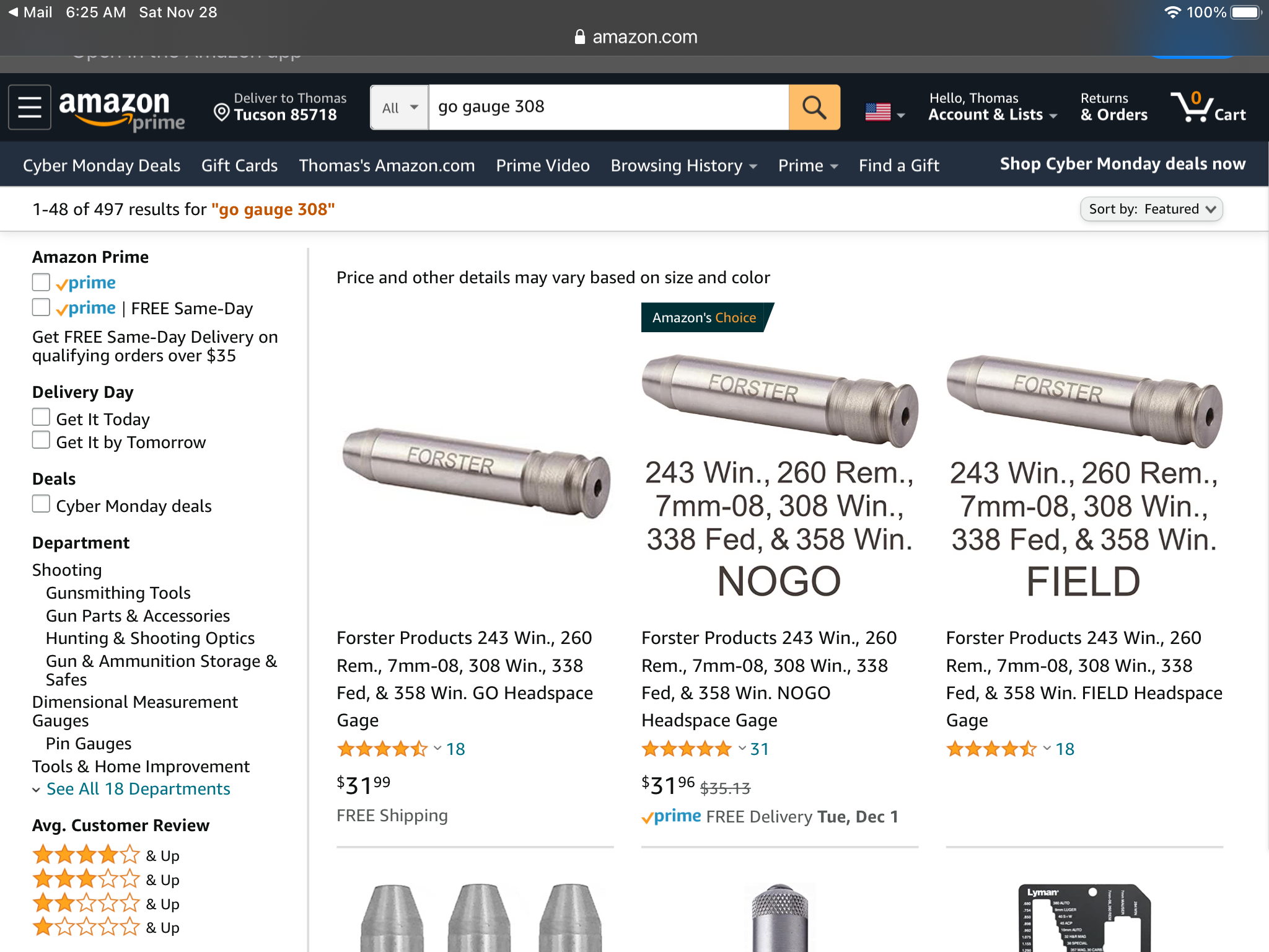

The barrel is not in the receiver. I'm ordering gauges.
..I would suggest you contact the barrel maker and ask what reamer they use, then purchase the GO, NO-GO gauges made by the same maker of the reamer. A large amount of the mass production industry uses PTG (Pacific Tool & Gauge) reamers, but again, ask your barrel manufacturer what they use then buy accordingly. Gauges can run approximately $30-40 per gauge, depending on source of purchase. Most offer "sets" of GO, NO-GO or GO, NO-GO and FIELD which lowers the individual gauge price a bit. IMHO, a set of GO, NO-GO is the minimum, FIELD would indicate it's still safe, but already on the way to not safe (erosion, depth over-reamed).
I emailed the manufacturer, auto replied they are so backed up it will be awhile before a response. I ordered some gauges.
