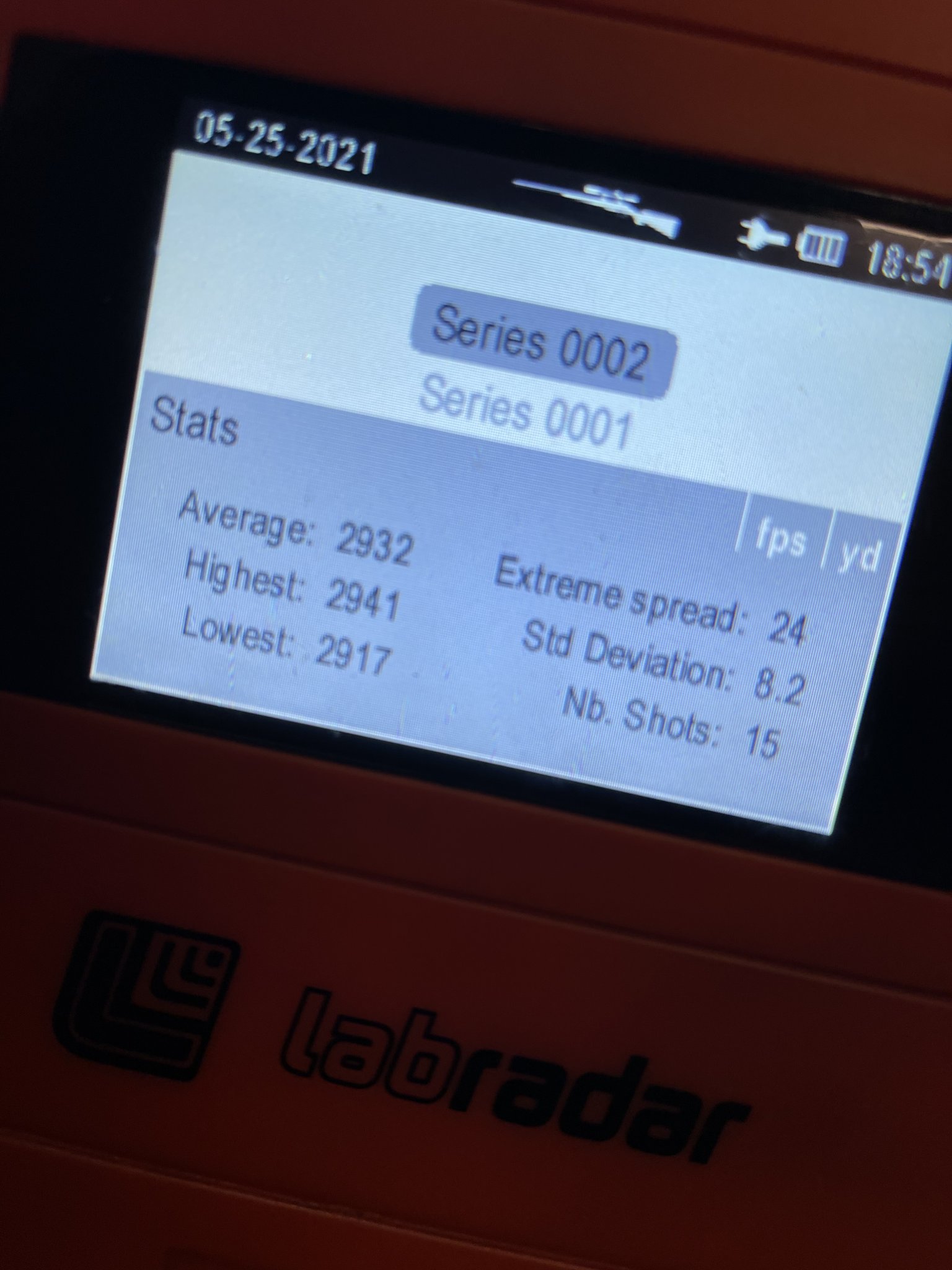

This is 15rounds through my 6BRA with CCI 450’s, 31.4gr varget, 109hybrids using an expander mandrel. Powder thrown on an Autotrickler V3. This is my match load. Shoots 1/2moa for the most part. Sometimes better.

24fps isn’t the worst. It’s certainly good enough for MOA targets out to 900yds. It’s a 6BRA, I’m not shooting out to a mile with it. Especially with my lack of skill 😂😂😂 and just the die with the mandrel. Don’t neck turn. Not worth it for your application.

Set the sensitivity to normal. Put fresh batteries in it. Move the sensors closer to the bore.
Battery and unit are brand new. Had it at normal. Increase sensitivity to 9 and used a smaller spacer. I guess it helped because the second string had one error instead of 3.
Any tips on what to do next. Work up more about 24.3? Drop back down in the 22s?
