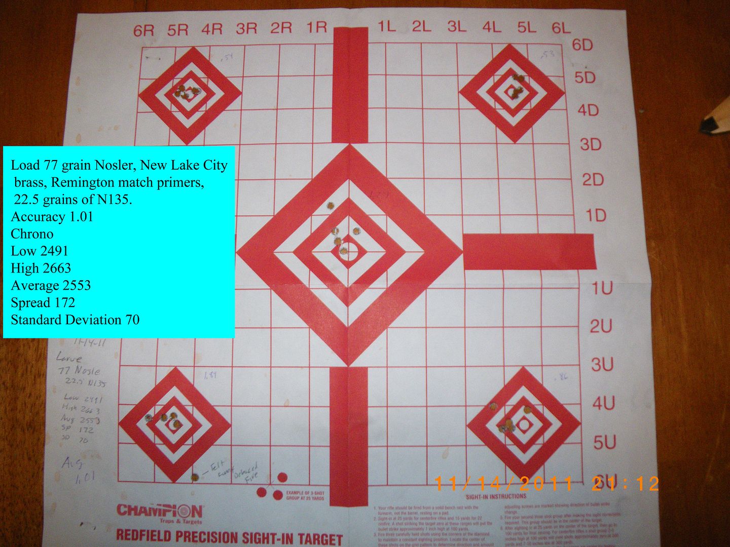

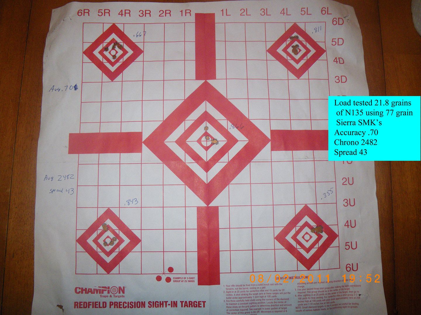

Tell me how the same load in one rifle has a standard deviation of 9 and in another its huge
Noveske target
Larue target.
The shot that is low right on the lower right hand target had a different report almost like a hang fire but not that delayed. I am using new Lake City Brass. I have noticed that my Larue will some times push bullets in the case if I don't use a bit of crimp while my Noveske with M4 feed ramps does not have this issue. I used a small amount of crimp on these bullets. I was thinking that the feeding cycle in the larue could be causing some of my problems. Not really sure what is going on here.

Don't know how to explain this big deviation, but judging from the groups the gun doesn't care. In fact, other than the 1 flier, the massive deviation gun did better than the other one. I'm absolutely no expert, but I've found the more info I have sometimes distracts me from the main goal of my quest for a better load. In other words, if I didn't have access to a chrono I'd never know the deviation was different from 1 gun to the next and I'd be pretty happy with the results on the Larue. We amass more and more tools to help us figure this stuff out, but sometimes those tools get in the way.
Did you deburr the flash holes inside the case? I have found that LC brass is my worst offender about leaving massive curls of brass around the flash hole and just the other day found 1 hole half obscured by brass. This was on new LC brass from Natchez Shooter's Supply. Other than a low powder charge or something, this would be my best guess on the squib load.

Until the brass is fire formed for the chamber don't worry about SD/ES, took much energy is being used to expand the brass, after the first firing and resizing can the true SD/ES be examined.

+1 to this. Also, what are you using to throw the powder? What chronograph are you using?

I agree with this, I assume you are shooting a .223, and in two diffwerent AR's? And judging by the way the second target looks it doesn't matter, it groups better. It is rather bizzare though.

Your groups are representative of semi-automatic rifles shooting unimproved brass.
For minimal Standard Deviation and Extreme Spread you're going to need to tune all cases for uniformity (like benchresters do). As recommended (even though new) you're going to need to tune the Lake City cases (run them through a neck-sizing S-die; trim to length; true the flash holes) and hand-throw and trickle your powder charges -- all steps not required for a semi-automatic rifle or carbine designed for combat and harsh field conditions.
Crimping raises your risk of core-jacket separation, which won't help your coaxial uniformity.
Do both rifles have the same round count? This may account for velocity variations and how much your jackets are getting roughed up in case-mouth to leades jump.
22.5 is a little low.

22.5 grains is listed as the max in the manual I was using.

That still would not account for why the good results from one gun and bad from the other. As an experiment I did hand weigh some loads a little while back and this is what I got.
Going over my targets the brass seems to be the issue. These loads I tried with Remington once fired brass.

The denominator for the equation for standard deviation is "n", the number of observations. You haven't told us how many observations were in each string, so a greater S.D. can be the result of fewer shots fired in a string.

Same load in two entirely different rifles, am I correct so far? I can also assume the barrels did not come from the same manufacturer?
Your loading problem is very simple. You cannot expect a load that produces low SD in one rifle, to produce the same numbers in a completely different rifle. I thought this would have been pointed out long before now. You have to develop different loads for different rifles. Your results have absolutely nothing to do with reloading practices beyond failing to tune a load to a specific rifle.

He's right. Unless the barrels are identical manufacturer, twist, length, and came off the line right behind each other your likelihood of one load working well in both is pretty slim.
All the lower spread means on the one rifle is that load is closer to being 'in tune' with that barrel. The fact that it produces a larger spread in the other rifle only confirms it is not 'in tune' with the other barrel.
I would focus more on the SD than the ES anyway. How far you stray from the baseline average is more important than the spread between the fastest and slowest rounds.
