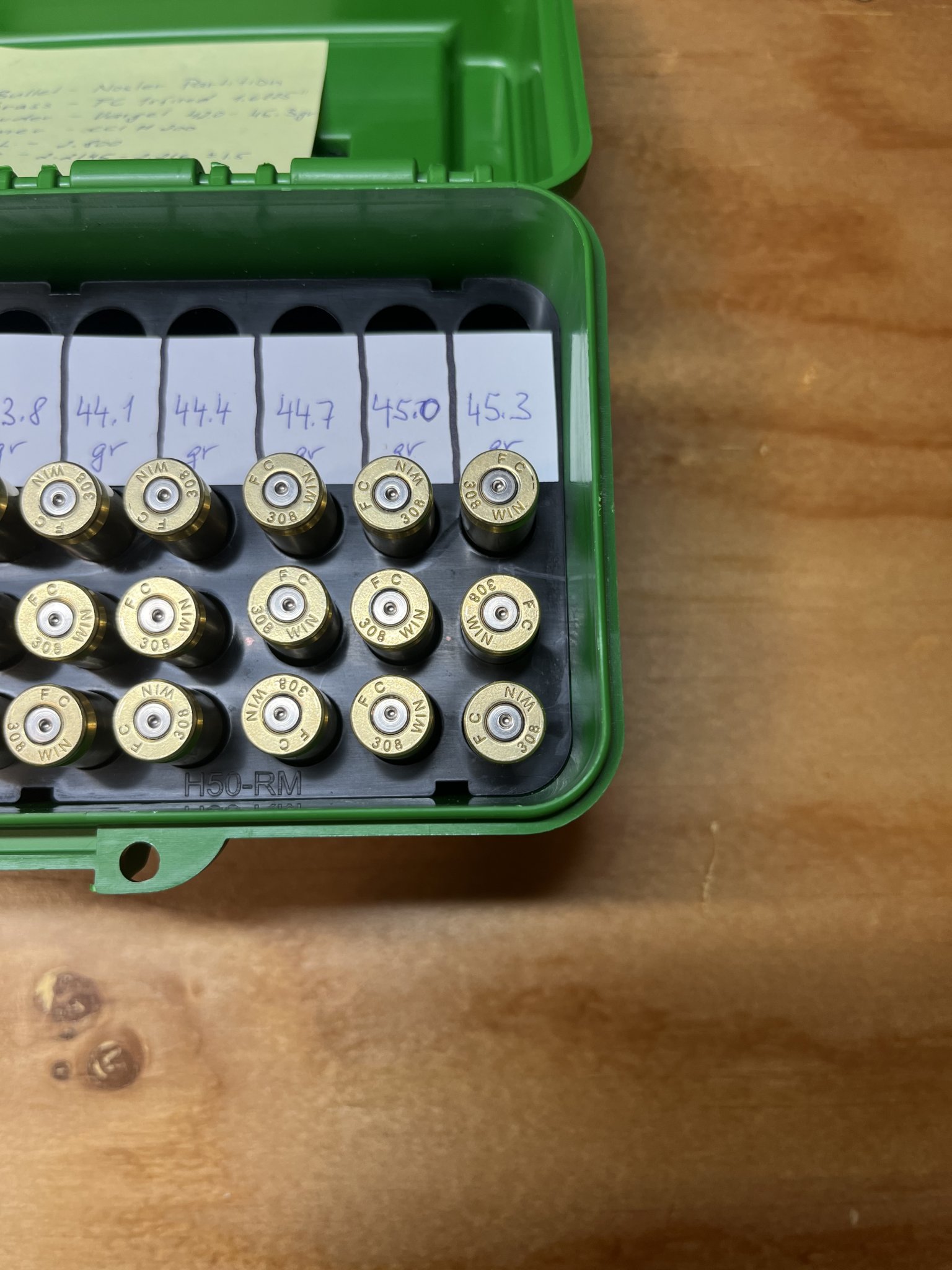

Thanks for your response. Just popped t primer out of 45.3gr load. The primer pocket is identical to previously fired brass at .2080. Picture attached. The 3 shots fired of 45gr had nearly identical velocities with ES of 3fps measured with Labradar and the new Garmin with slight variations between the two, around 2748fps on average. CZ 550 26” Varmint barrel 1:12 twist. The 45gr seems would be a no brainer but it concerns me that the window is so narrow.

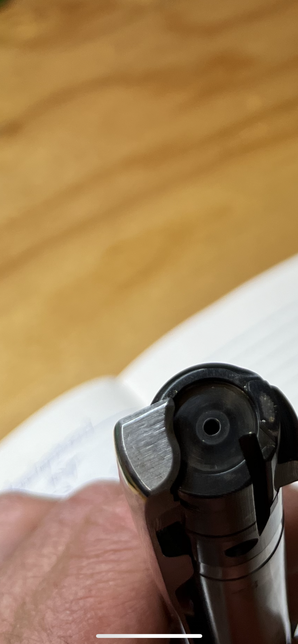

That's some of the prettiest fired brass I've seen in regards to fired brass in general and pressure. 26" barrel hell yeah 2750fps is a solid velocity. You could push to pressure loading 1rnd each of 45.4-45.7-46 and might stretch the node after 45gr and also find where over pressure starts.
Edited to add: I am seeing some primer cratering and extractor shine on the 45.3 loads. The primer still looks great as well as primer pocket size reported.
That shiny smiley face you’re seeing is caused by this shiny spot, kind of a burr in my ejector groove if you can see it. I find it even on mild loads but it gets more pronounced and shinier hotter the loads get😁. The 45.3 group looked terrible over 1.5” so idk if it’s worth pursuing higher node. 45.3 produced velocities 2757-2776. It’s definitely getting little hot. I’m new to reloading and still little bit scared and not confident in my ability to correctly read pressure signs 😬😂
