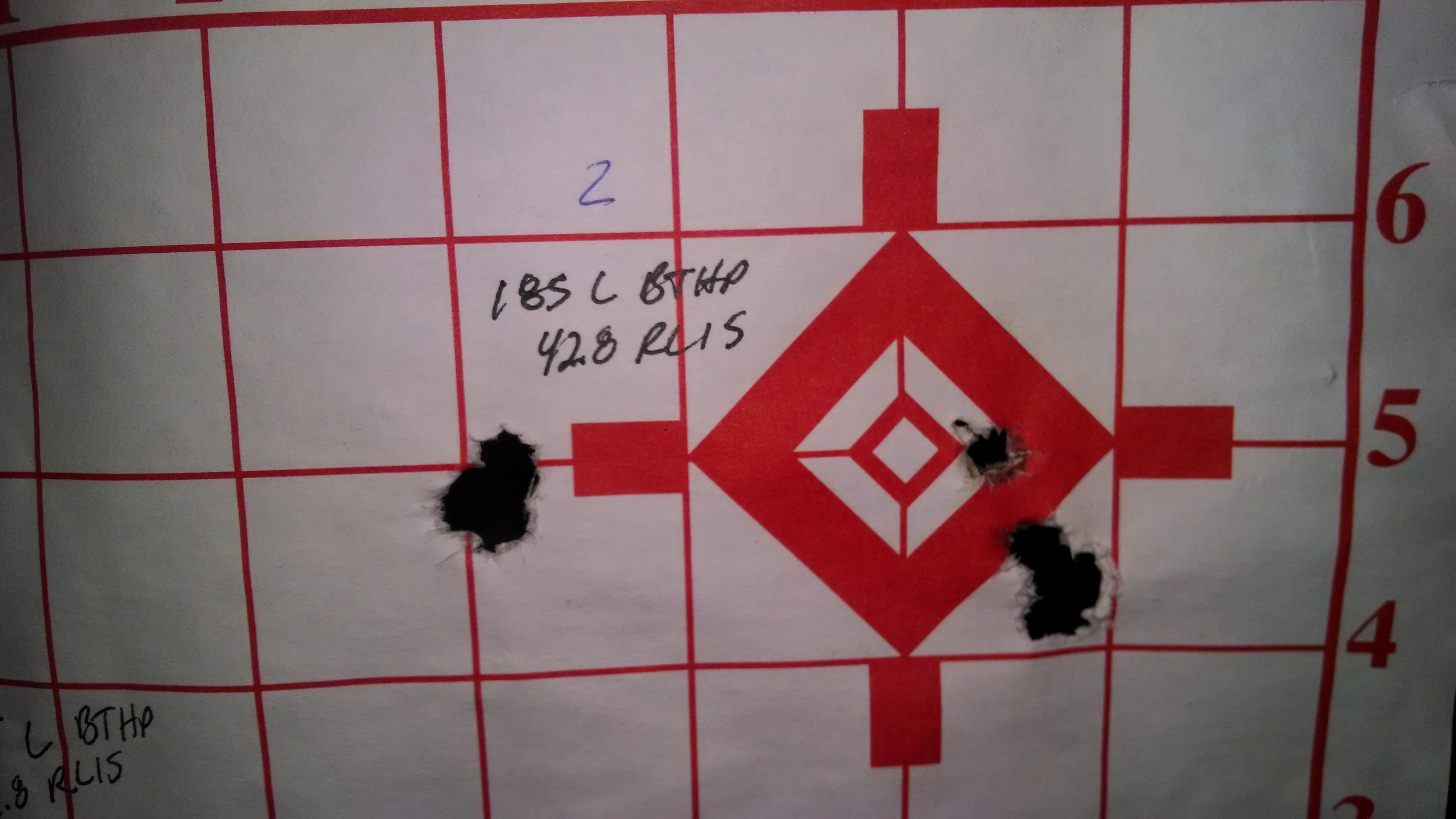

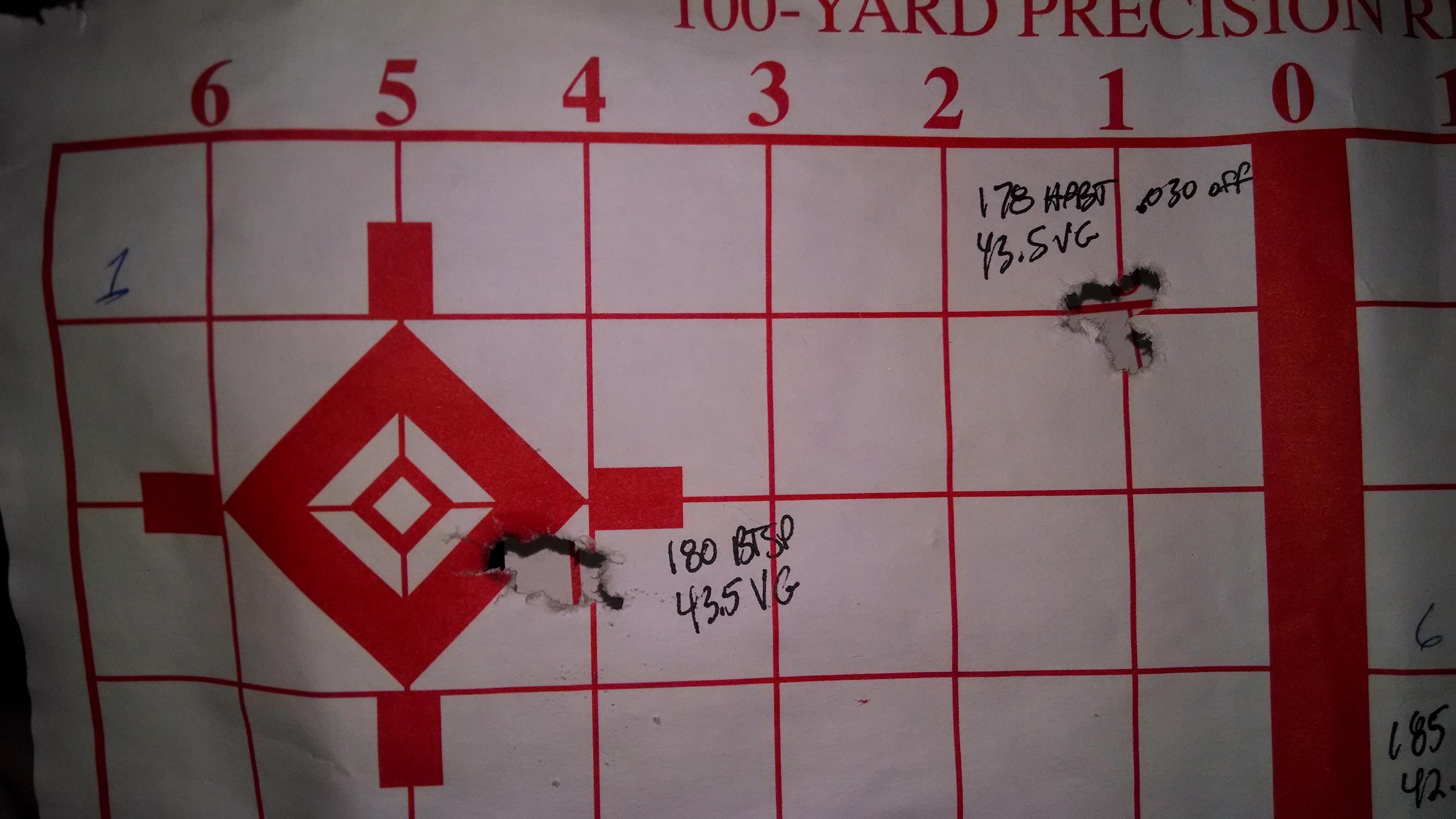

I was unable to attach these in the pm. Both are set .030 off. Fired from Accurate Ordinance 308, 22in rock creek 1 in 11.25tw AICS 1.5 stock. bipod up front sand bag in the rear
185 L is Lapua scenar bthp
178 is hornady bthp, VG is varget

View attachment 34041View attachment 34042
Nice shootin'! Your velocity can't be too high with either of those powders, now try some 2000MR and watch your velocity go up 200fps, figure around 2700ish from a 26' bbl.
