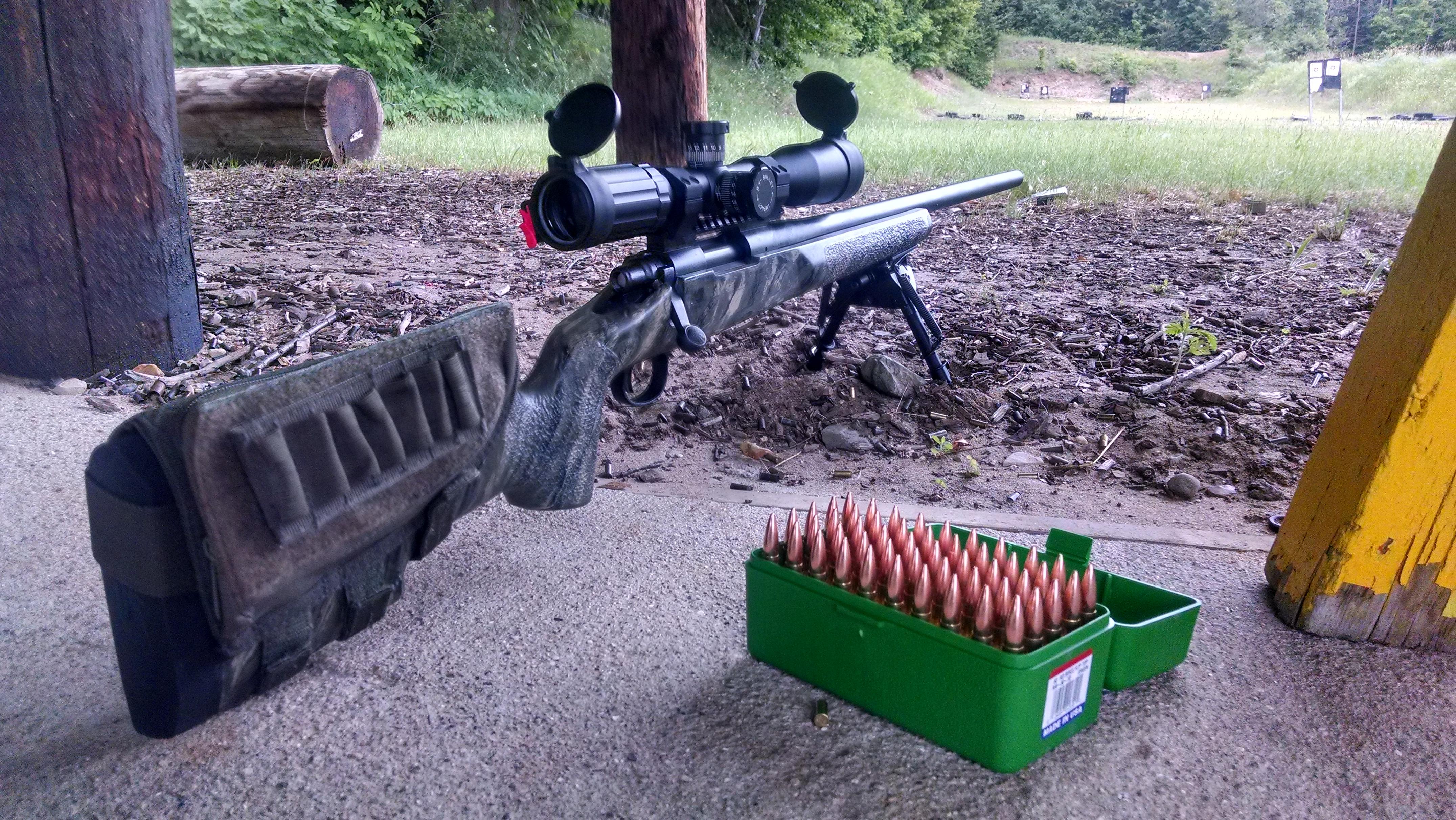

I bought factory .308 Remington 700 SPS Varmint. Rebuilt it. Highly recommend going with the McMillan A5 for stock. I got mine here off the hide for $600.00 ...For a practical hunting/long range rifle for me, I went with a SWFA SS 10X42 ... Purchased Seekins 30mm low (.82 in.) scope rings for $120.00 and EGW Remington 700 Picatinny Tactical short action 20 MOA scope rail mount for $32.00 ... Also bought used bi-pod off here as well for $100.00 ... When I first bought the rifle, I didn't mind the heaviness of the trigger pull, which was somewhere between 5-6 pounds... I was considering buying a new trigger but found that you can adjust it. It is now adjusted to 2.5-3 pounds. Huge difference and money saver at this time. I reload using Sierra 168gr. HPBT Matchking and Hodgdon Varget... I shot different charges of it to see which shot the best group and 45gr. of the Varget was best fit for my rifle. Not sure if any of this helps, but wanted to share the love of my gun and how proud I am to own it. Good luck, welcome to the hide, and happy shooting!
Thank you Caycee Oakley, do you know if the trigger in my rifle is adjustable and how far have you been able to reach out with your build? Your rifle looks gorgeous and is making me all the more eager to complete mine.
Should be no different in your rifle than what mine is. It hasn't been that long since I've rebuilt mine so the furthest I have stretched her out was 340 yds. I plan to shoot up to 600 yds in the near future though at a range. I'm competing in a tactical shooting comp next month and will be shooting 600+ yds there. It can shoot that far though no problem with the right load. I understand that feeling of eagerness as well. All along the way, the more I added, the better she not only looked, but shot.

Beautiful gun mate
