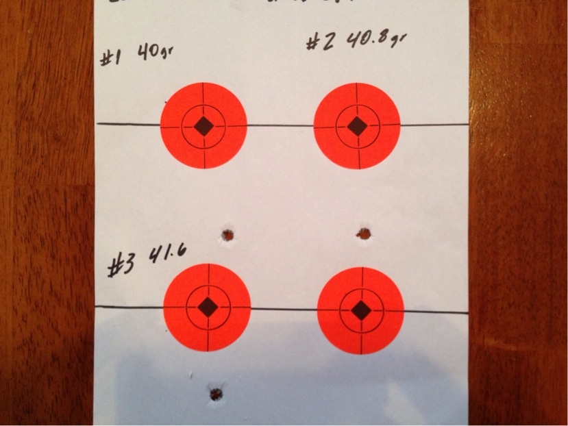

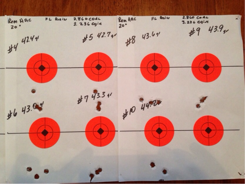

Well, I just got back from the range and the results were a little more promising. I still need to adjust my POI, but will do when I get a load dialed in.
My new set is 1 at 40, 40.8, 41.6 and 3 at 42.4, 42.7, 43,43.3, 43.6, 43.9, and 44.2.
So do I focus on the 43.3-43.6?

Looks like Dan was right. 43.8gr is right about where I would tune things. Your POIs between 43.6 and 43.9 are about the same.
Gonna look at 42.4-42.7 and 43.6-43.9. Then hopefully I can pick a clear winner. Thanks everyone.
I've been playing around with quickload with the same components. Given your barrel length and seating depth, you should be on an optimal barrel time node at ~42.6g. Does it chrono at ~2475fps? Mostly trying to figure out of this darn program works.
43.3 to 43.9 are starting to look good. Please remember that you are shooting a factory Remington and there is nothing that you can do to improve accuracy more then replacing the barrel no matter what ammunition you feed it. Shoot a 10 shot group with 43.6 and be happy with 1.5 MOA and call it a day provided your ES is 50 FPS or less for out to 600 yds and 25 FPS or less if you want to shoot 800. You can also buy and shoot a box of Federal GM match ammunition and it will provide you a good baseline or shoot a 168g with 41g H4895. I also suspect you will get slightly better results with a 168 or 175 BTHP bullet, the AMAX bullets are kind of long and pointy for a factory rifle.
Did I read in your first post that you are shooting at 100 yards? If so, you might try backing up another hundred or two and see if the results become easier to interpret.
The loooooooonnnngg throats in my Remingtons always seem to prefer Sierra bullets.
