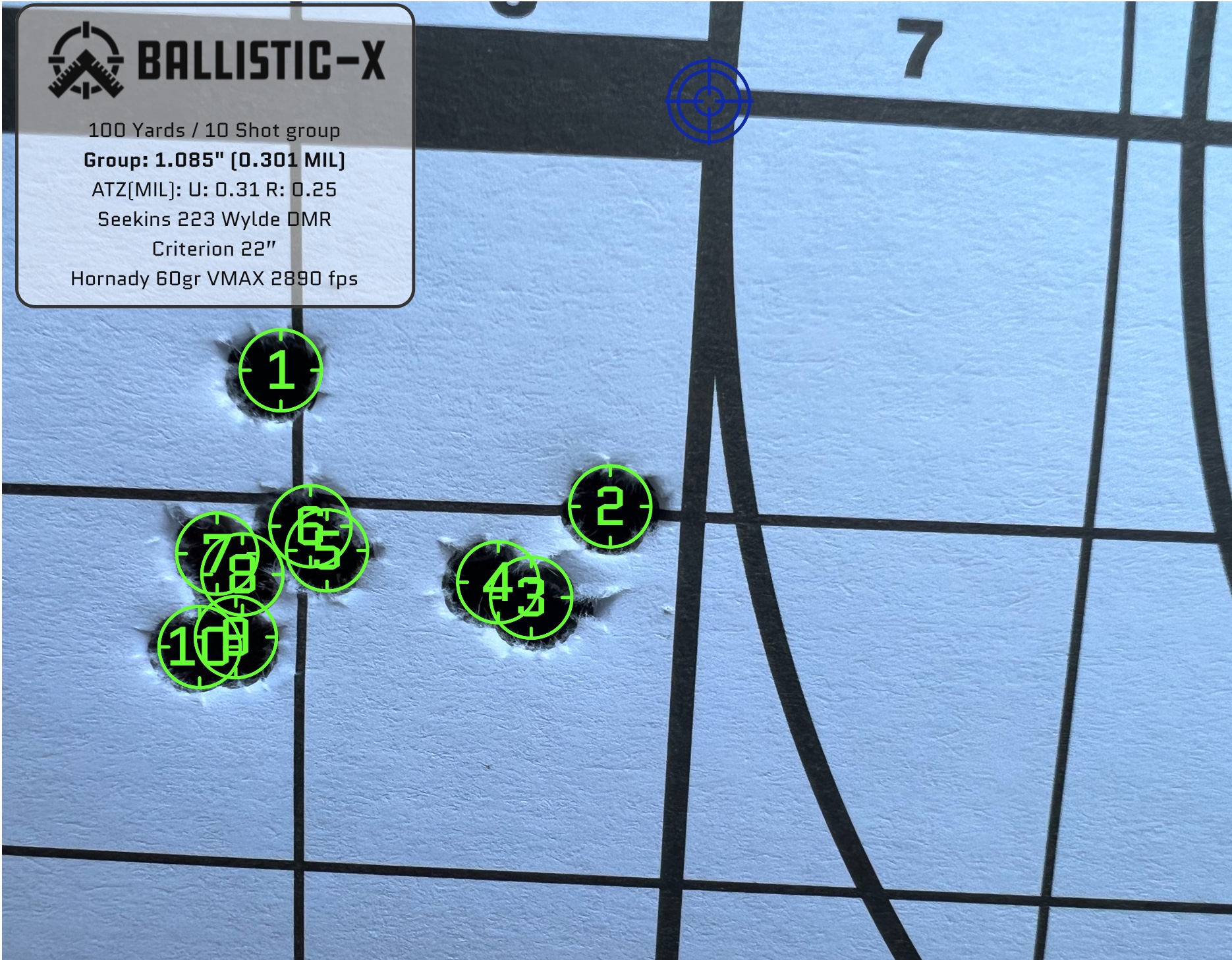

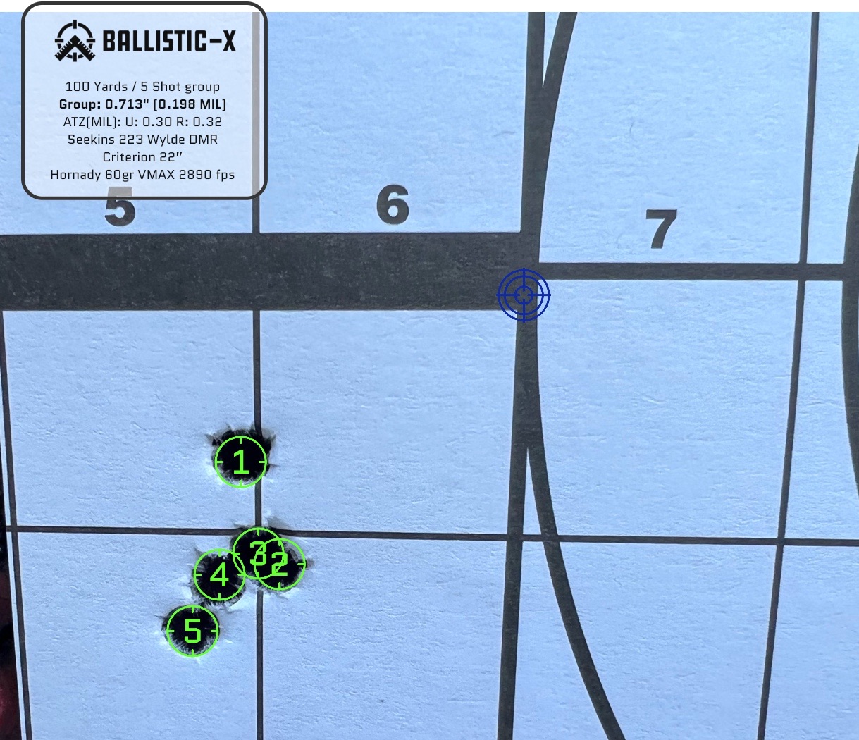

FWIW, some have more experience than me in the variety of barrels listed previously. I personally can attest to Seekins (Rock Creek), Proof CF, BA and Criterion SS HBAR in AR platform. My buddy swears by Douglas, and their legacy certainly speaks for itself.
Agree with the wait time and Criterion comment above. Here’s my experience with one I recently bought. Seekins IRMT-R w/ 20” Criterion SS HBAR. Frankly, it shoots about the same as shorter BA barrels and 16” Proof CF that cost as much as this whole upper I bought in the PX. The pic is mislabeled “22”” but it’s a 20”. 5 and then 10 shot string.
16” CF Proof barrel Seekins IRMT-R upper
