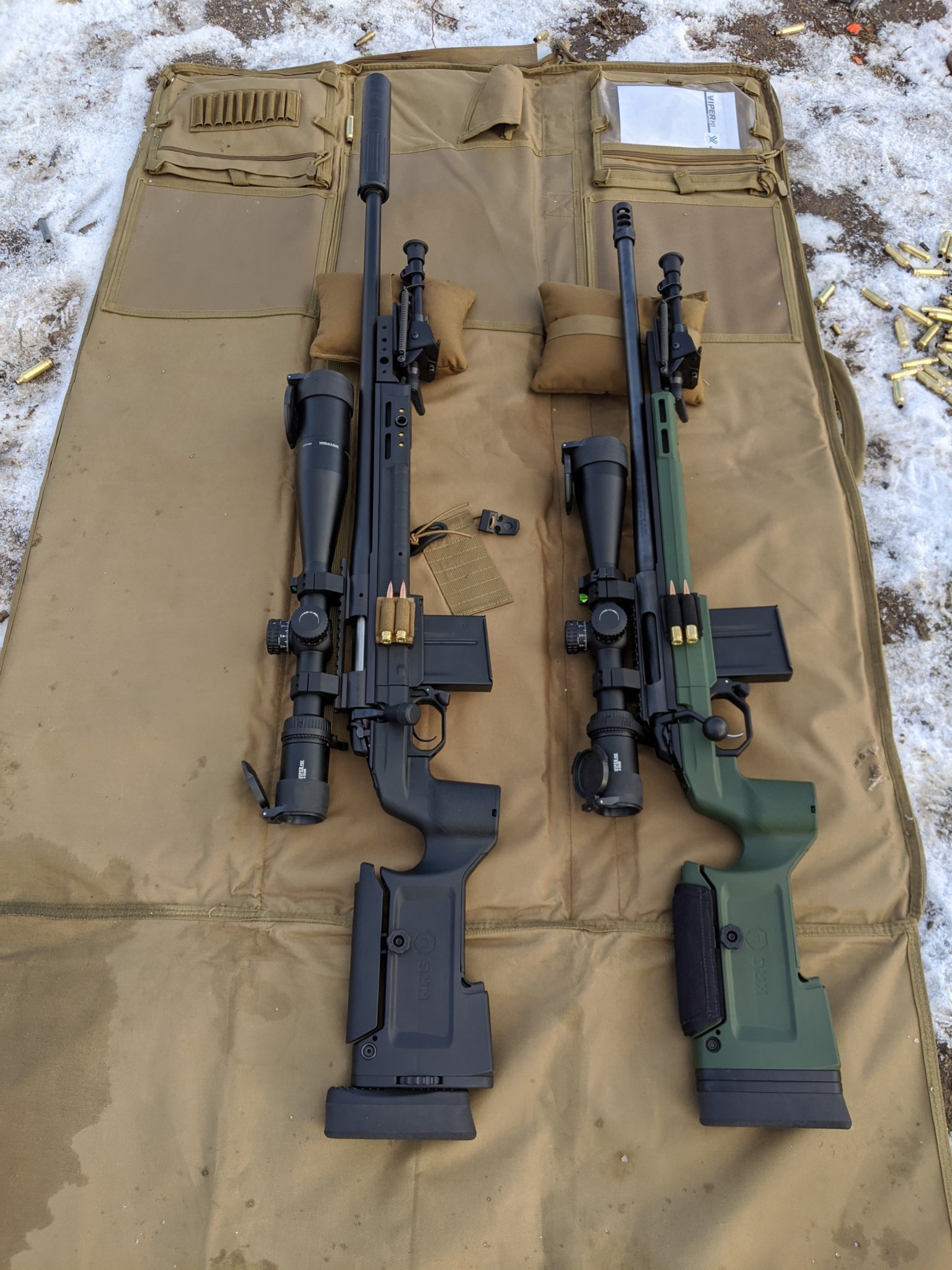

1" should be fine. I have a CTR 6.5cm in a Bravo chassis with a PST Gen II 5-25x50 with Vortex PMR 0.87" rings and Area 419 20moa rail. It just clears the factory barrel with the Vortex Defender scope covers.
Mine is the green bravo:
