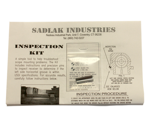

    Not sure what receiver you are mounting to but if you haven't mounted the Brookfield go SLOW and be very careful when you are tightening the mount to the receiver. I think Sadlak(?) sells some pins to check if your mount/receiver is in spec.

    I assume this would work with BF mount?

    The problem that I had ran into is the interface grove on the left side is not parallel with the bore of the receiver itself.
    I mount the barreled action in my mill and use a test indicator and sweep the groove from front to rear.
    If this groove doesn’t run true there is no good fix.
    LRB’s in my experience are good quality.
    The receiver inspection kit will not help with determining if this groove is parallel and true.
    I hope this makes sense?
