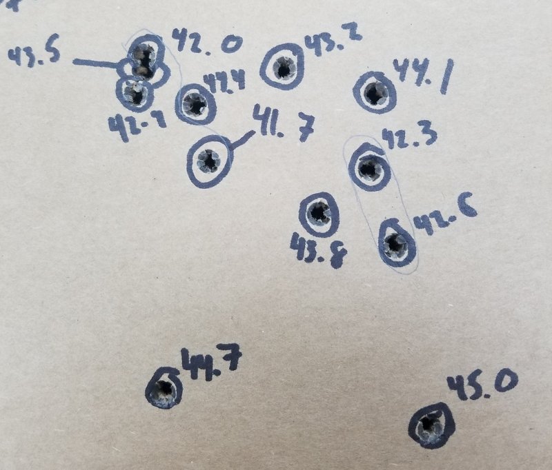

Hey guys, should the ladder test be one, 12 shot group all at once or 12 cold bore shots? I ask because my barrel isnt the heaviest and I dont know if doing it all at once will heat the barrel and make me throw shots.
Shoot three foulers to get it warm and then shoot them leaving 4 minutes between each shot so it stays warm but doesn’t get scorching hot. That should give you time to walk down range and mark each shot.
What I see if that 42.9, 43.2 & 43.5 are all about the same elevation so I would say that’s the region you would want to be looking into further. How far was this shot at? I’m guessing only 300 which would explain why they are still so close to one another.
With a ladder what you’re looking for is shots of a close powder charge range all having similar point of impact with regard to elevations. Because you shoot it over numerous hundreds of yards you don’t pay much attention to the horizontal as that’s wind or something that can be dialed out with seating depth later. You just want them elevations the same.
The theory is is that you want to time the barrel vibrations so as the barrel whips up and down that the slow bullets are coming out as the barrel approaches the peak of its wave getting thrown up and the fast ones are coming out as it begins going down from the peak. That way they all reconvine at a similar point down range. The further you go the more the effect comes into play. 200 is too close really for it to work properly.

Load up an ocw of 42.6-43.6 in .2 gr increments. http://optimalchargeweight.embarqspace.com/
Good luck! I’ll be curious to see how this turns out for you. The OCW and ladder tests Spife7980 referred to are great methods and I second his suggestion to use a longer range than 200 if you can. Although, I do quite a bit of load development at 200 simply because I have a 200yd range about 10yds from my reloading bench. Lol. It works for initial development, for me. I’d get yourself a MagneetoSpeed chrome while all the holiday sales are on, if you can swing it. It’s made my life a lot easier than my old Chrony optical chronograph. It’s very consistent in all weather and lighting and when I get a velocity spike, I know where NOT to look - my chronograph! Lol. I’ll bet dollars to doughnuts that the velocity spikes you were seeing were related to your chronograph unless you accidentally loaded a round differently. I would find it very difficult to shoot with out accurate velocity data, at least on my final loads. I depend on my ballistic calculator to deliver 1st round hits since I’m a hunter, first and foremost. Without that velocity data I’d have to go out and shoot every distance out to 700yds (or more) in 50yd increments to come up with a decent dope card. Heck, that’d cost almost as much as buying a MS.
