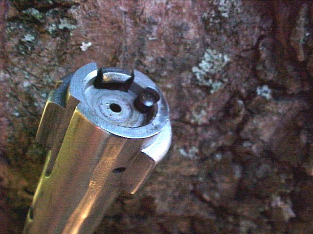

    In the lower left corner of this pic you can see one of the three characteristic Howa 1500 pressure relief holes on the underside of the bolt. They direct gasses from a case rupture down into the magazine. Also the anti-bind slot in one of the lugs. The rest of the bolt head looks identical to my Howas.

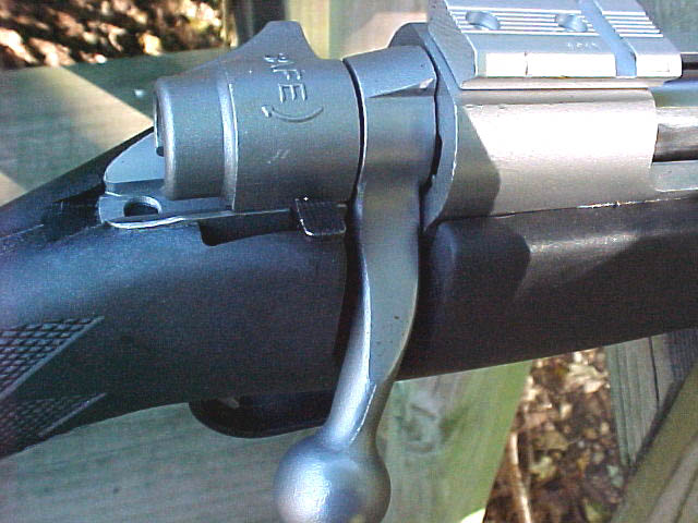

    The bolt handle is identical to the one on my Howas as well. You can see the forging die parting line running from the scope relief down into the knob. Don't know why Howa didn't clean it up...….
