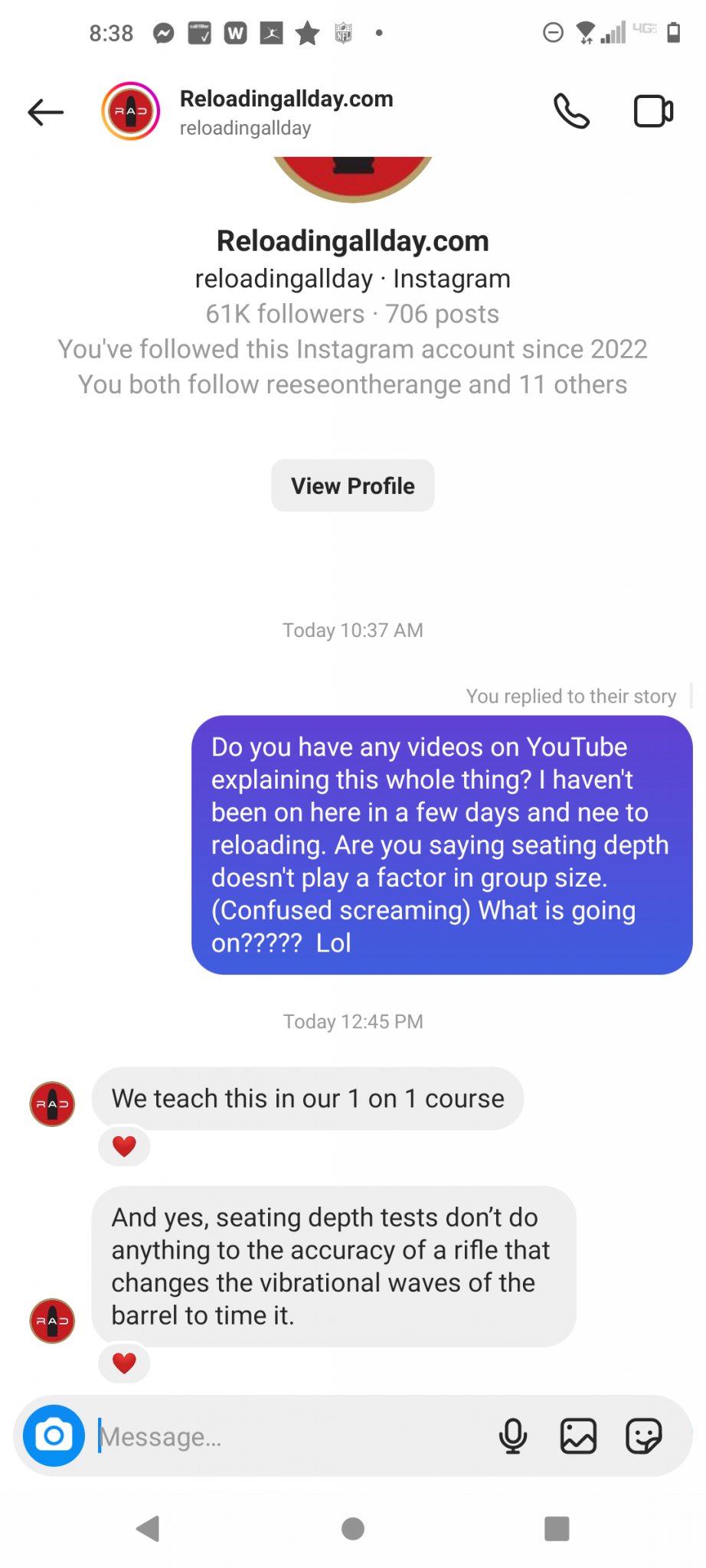

    Hey guys. Blake here from RAD. If you have any questions I’ll help as much as I can. What the OP is referring to is that I’ve been lucky enough to be mentored by our internal ballistics ballistician and witness some really neat things, among myself when challenging under high sample size testing and proofing.
    I’m not sure how to tag on here cause I never use the hide, but @BuildingConceptsllc is on the right track. I’m talking about in relationship into vibrational waves among optimal barrel timing.
    There are ways, among a certain “seating depths” that have more to do with supporting the projectile before launch and engravement and using the barrel geometry to your advantage which is more vital than a “vibrational node” that one may be chasing with optimal barrel timing. We will be releasing data soon showing what’s going on in the internal and intermediate process of ballistics.
    I’ve personally done testing outside, among with our students, with mathematically calculating where powder charges will “yield” the most consistent ignition and results as seen attached with 90 rounds recorded on 3 separate days.
    This is a very sensitive subject and I know a lot of personal feelings will get mixed up in this. Not trying to start anything. And I hope individuals don’t get upset that I have an opposing view. However, I understand objective data is very important and will be more than happy to answer any questions as much as I can.

    Hey @BuildingConceptsllc! I cannot legally provide specific data that is not mine to give as our ballistican is actively showing what is going on in the internal process. Once it is available, I’ll be sure to link it here.
    If you are interested in reading about vibrations at the muzzle from other internal ballisticians talking about this concept you can find some material here, particularly page 10-15:
    As far as other topics such as tuners and timing, I would refer to applied ballistics, Bryan Litz Volume 3 where they show objectively talking about how tuners do not work.
    I would be more than happy to provide data from groups being shot. However, considering the rifle recoils before projectile exit, we have to completely isolate the shooter to show what is actually going on in the internal process for this to be proven in what we are talking about.

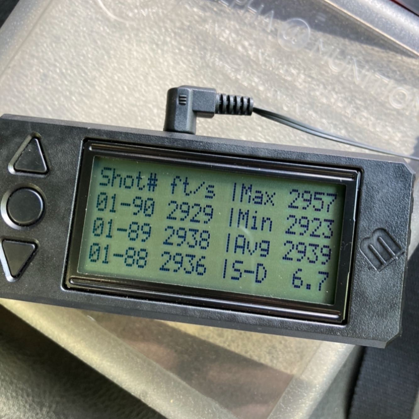

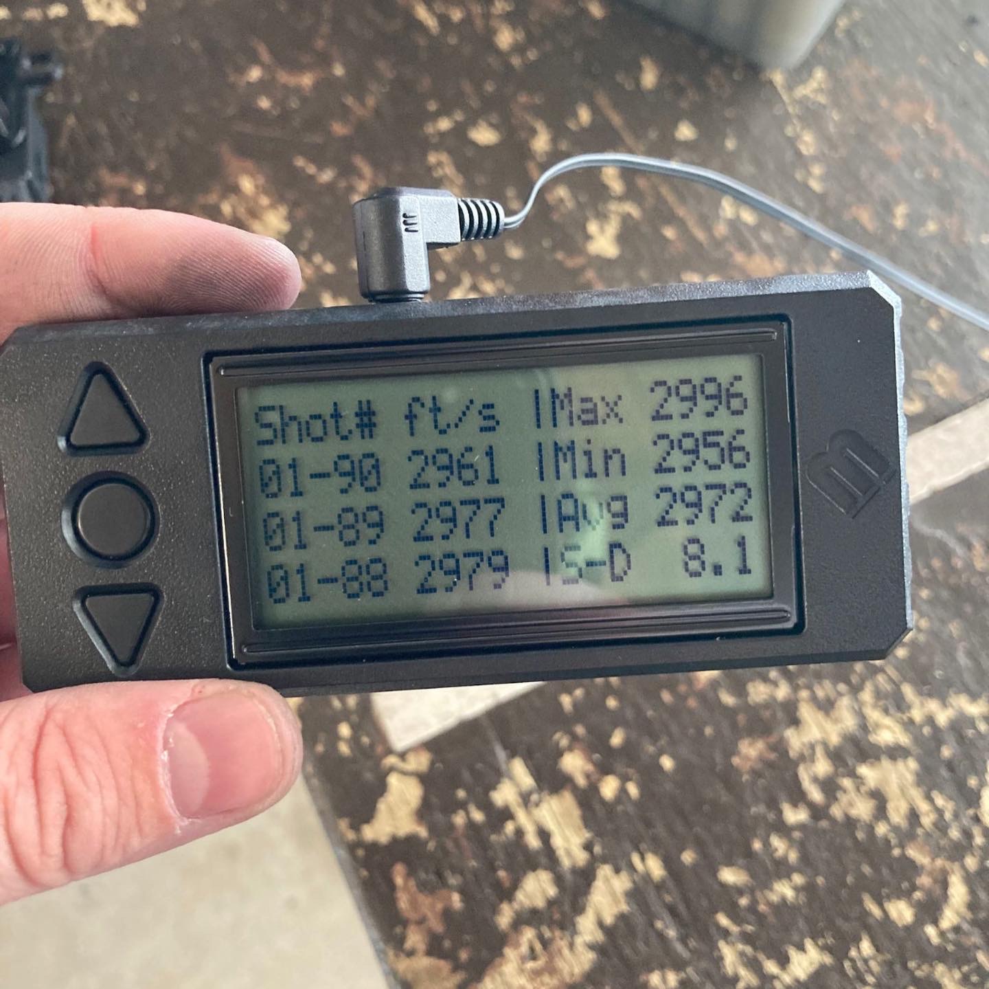

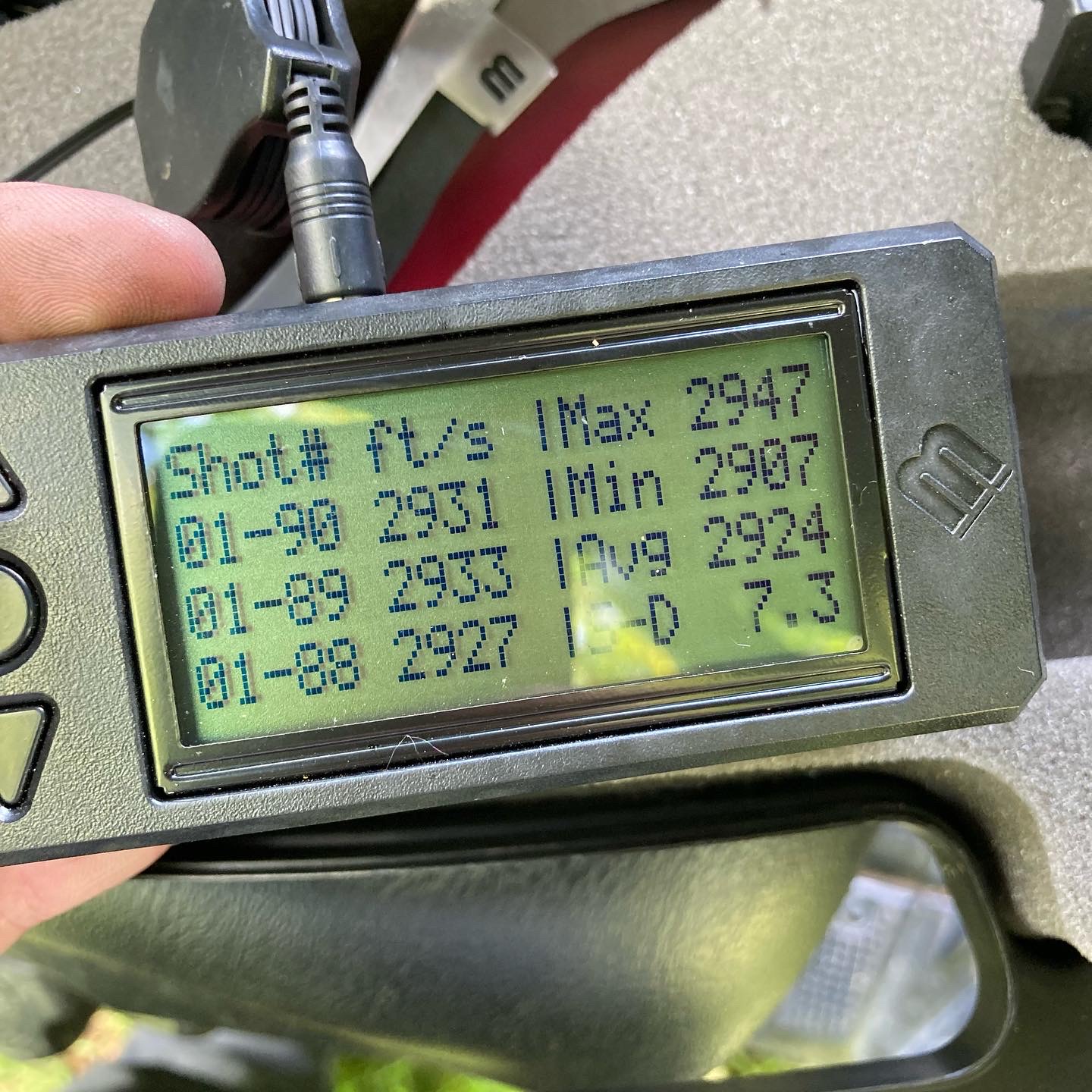

    What's important with a change in the seating depth is that it changes interior volume that the charge of powder has to work in. Lower the volume in the case for a particular powder charge and the spike in pressure goes up resulting in higher velocity. Increase the volume in the case and the spike in pressure goes down as will the velocity. This is a very easy thing to test yourself just by comparing a couple of seating depths at something like .020 or .030" apart with the same projectile and powder charge and see what kind of MV differences you get.
    Along with the difference in velocities you can see, you can also see what that amount of velocity difference makes on paper . . . particularly at longer distances.
    Besides a change in velocity that a difference in seating depth can make, there also what call "barrel time", the time it takes the bullet to fully exit the muzzle. Altering the seating depth changes the distance the projectile is from the muzzle. While that's a factor, it's in combination with a change in pressure/velocity, which is really not the only factors a place. But, seating depth is a major one.

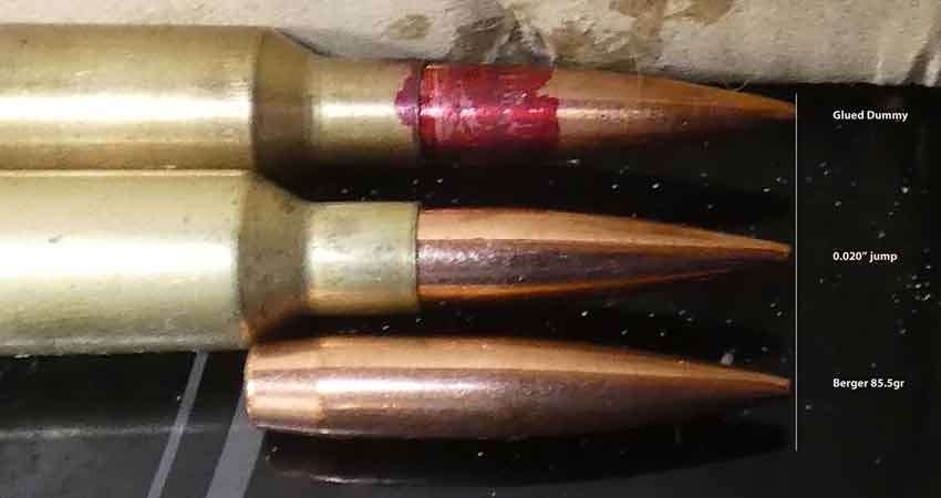

    I'll stick this article here also as I noticed my randomly picked COAL, with approximately 0.08" jump, showed great groups during charge testing. So far it averages 0.56 moa with average distance being 340yds. Groups of 5 and few 3 shots.
    I had scope loose / poorly attached for 2 groups, it printed 4 separate groups of .12, .17 and .11 and .12 moa at 300m, the shots stilI hit within 1.03moa.
    I have never been more puzzled as then. But it seems to work very well when the scope is attached properly. (0.68 moa overall average, with loose scope groups)
    This is what I found was the reason to the success:

    Here is my latest loadings for each barrel with Berger 85.5gr bullets.
    Old barrel, New barrel, 85.5 and 88ELD
    I tried to set jump to 0.020" for 85.5, 0.030" for the 88ELD. With practice/load work and F-Open matches being 60+ rounds, and the opportunity to rezero as the round count goes up I'll be checking length every few hundred rounds. Maybe I'll let jump increase some as I go.

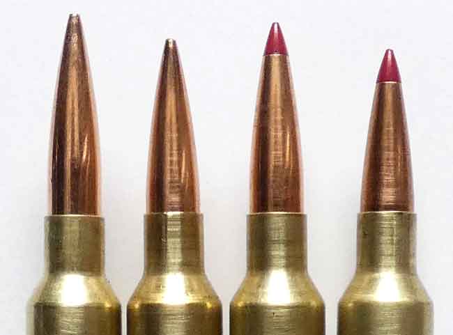

    Seating depth, jump, jam, bearing surface engagement, 0.002" to 0.005", or 0.050" to 0.080".
    With something like a .224" diameter projectile, 0.080" is a lot when it comes to bearing surface engagement of the bullet with the neck.
    For those that spec'd their chamber's freebore to JAM a particular bullet waiting for 0.080" throat erosion is gonna cost some points.

    From what I have tested , seating depth primarily effects 2 things . Velocity variation and also causes a random dispersion at certain depths . The volume of powder can effect this as well . At certain volumes the velocity variance can be effected less or more .I have not found a bullet yet that was not effected by this variable. Average change in jump has been approximately .004-.005 before small spikes in velocities start to appear again but again this depends on the volume occupied by the powder at the time .
