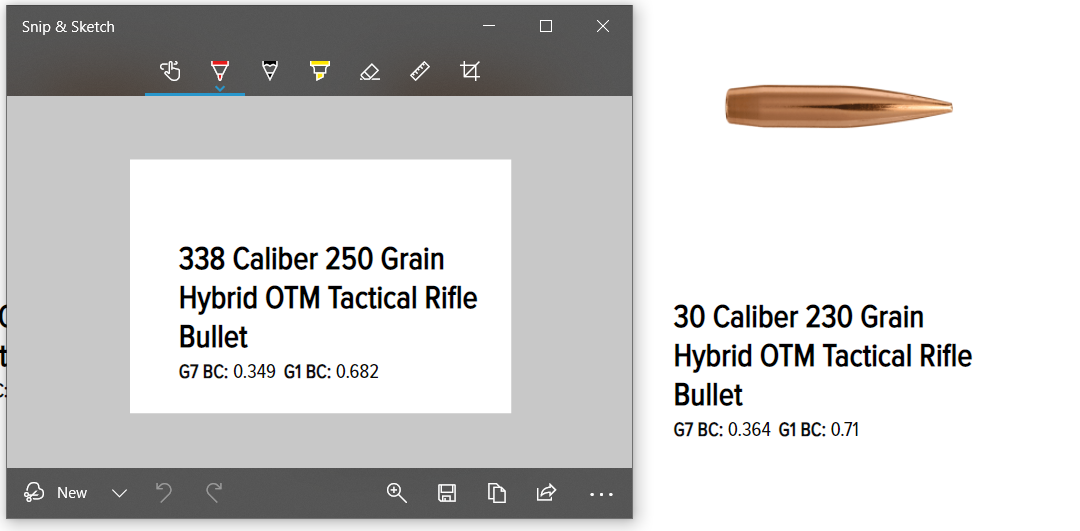

Posting this in the hopes that they are listening and that there may be enough interest in a .308 250 gr LRHT bullet. The more I play with a 300 Norma the more I desire this bullet. Mainly because I have been loading Hornady 250 A Tips and hearing about the bc variance and how Berger is spot on with consistency. I haven't shot the A -Tip out to distance yet to check for vertical but it seems like my buddy and others that have shot both favor the Bergers for consistency. I'm a heavy for caliber fan and it would be nice to have this as an option.
Thoughts?

So a .300NM throwing 250s at maybe 2850fps...how is that not the same as a .338LM with 250s?
Reactions: Steel head
The bc on the .338 250's aren't in the same world as the .308. Not even close.
I'm at 3000 fps with the 250 A Tip and N570.
Ok, I see your point.

One needs to consider form factor in choosing what bullets to shoot for a given cartridge. All other things being relative to bullet weight (velocity, powder charge), the lowest form factor wins in down range ballistics, if that's something you care about.
The only lead core bullet I know of that has a lower form factor than the 250 A Tip by a very small margin is the 230 A tip. And it isn't enough for a real world difference especially if you're considering things like impact signature or spotting misses.
If a 250 sheds velocity at a slower rate and I can't push lighter bullets fast enough to overcome that because the form factors are greater, it's a win at the target.
Whether or not Berger can make a 250 with a low enough form factor to compete with it's lighter weight options for caliber remains to be seen, but I like having choices.
