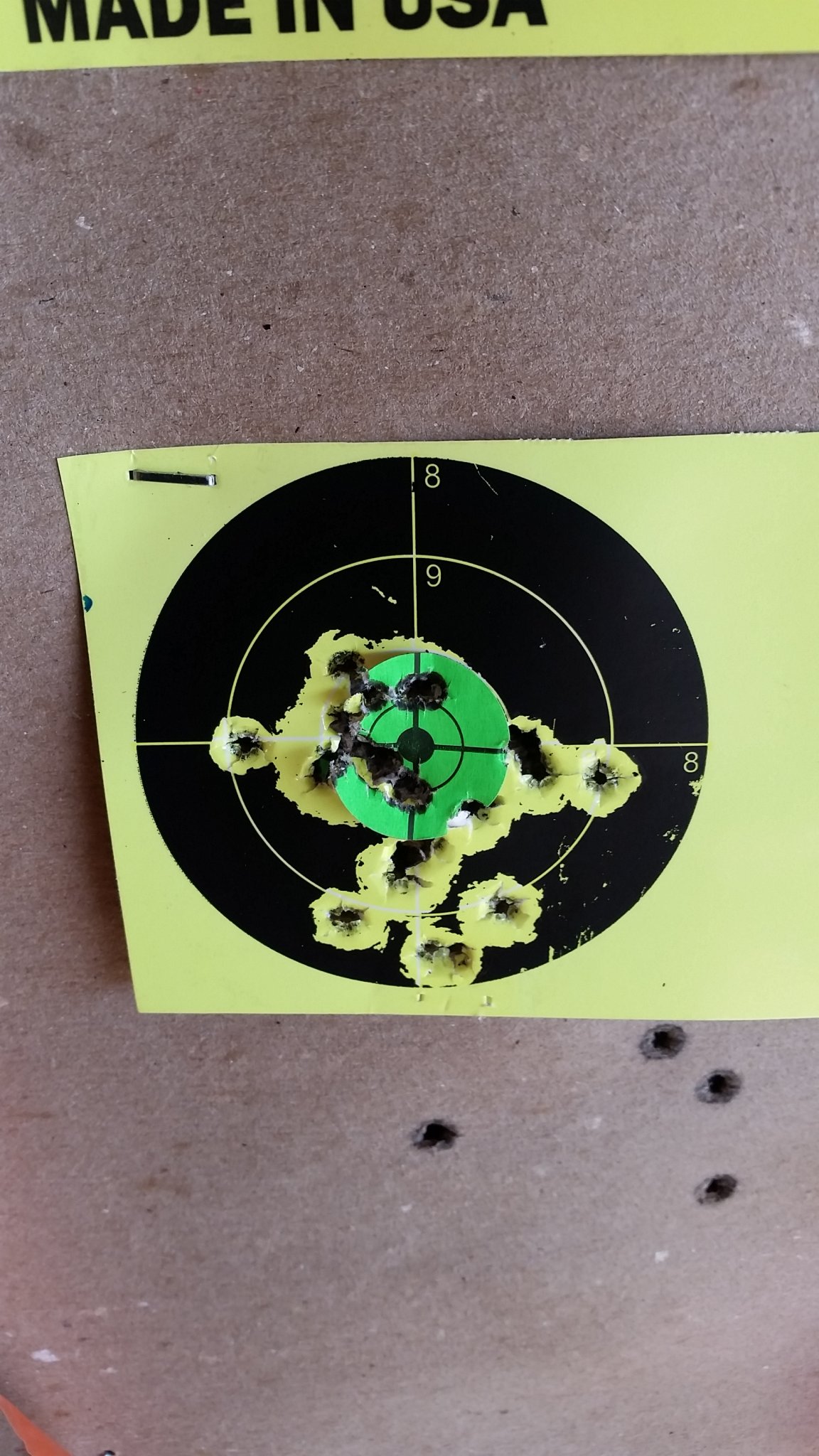

Well the proof is in the shootin'. :)
200Y 3" target. 15 rounds. Pretty bad. Granted I might have been slapping the trigger some to "get it over with".
On a happy note pre resize they are now (shoulder) the same length of their brothers. So that's a good thing. :)
