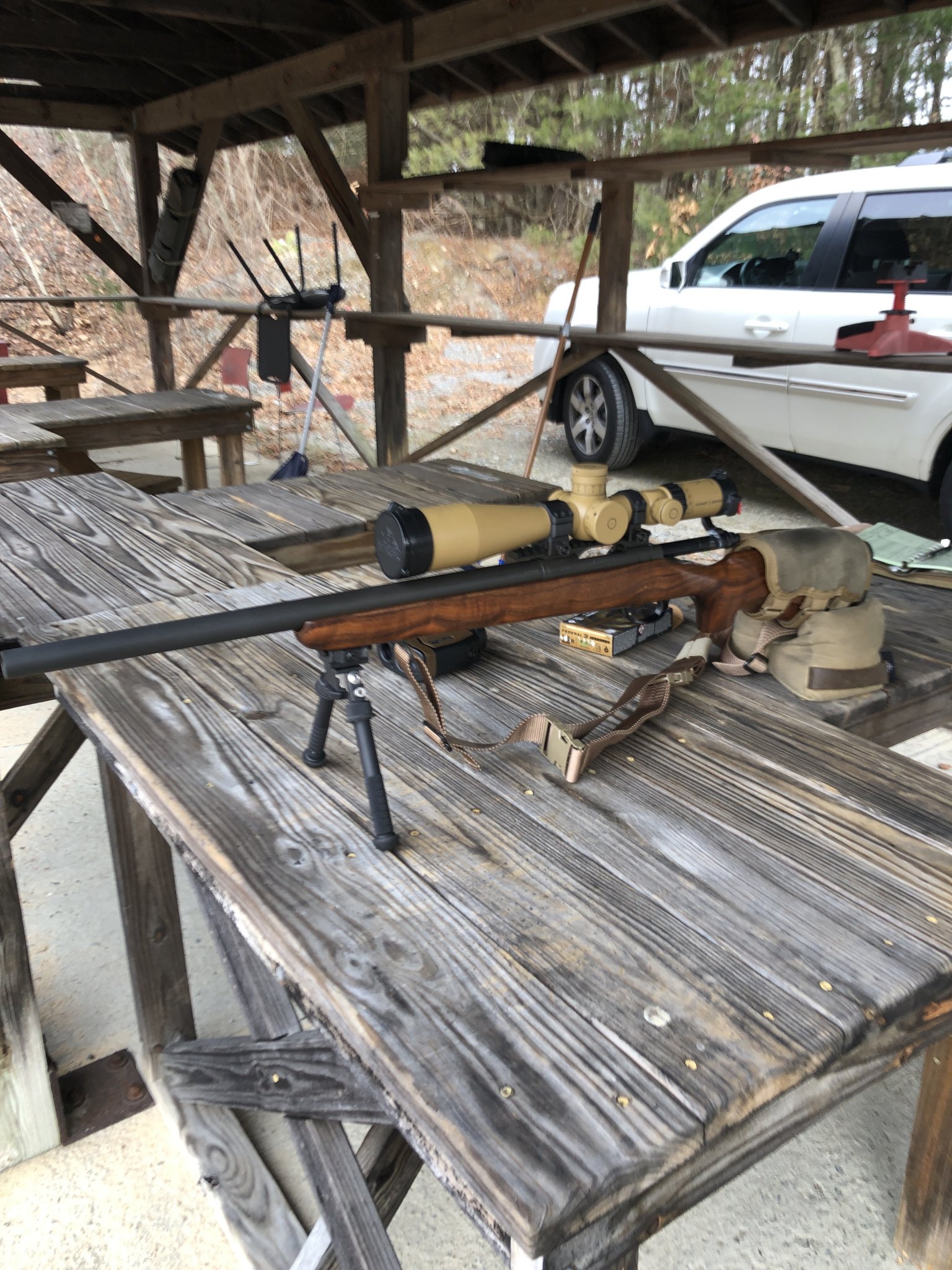

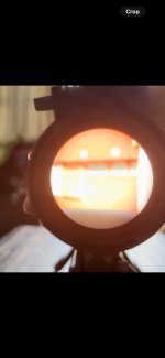

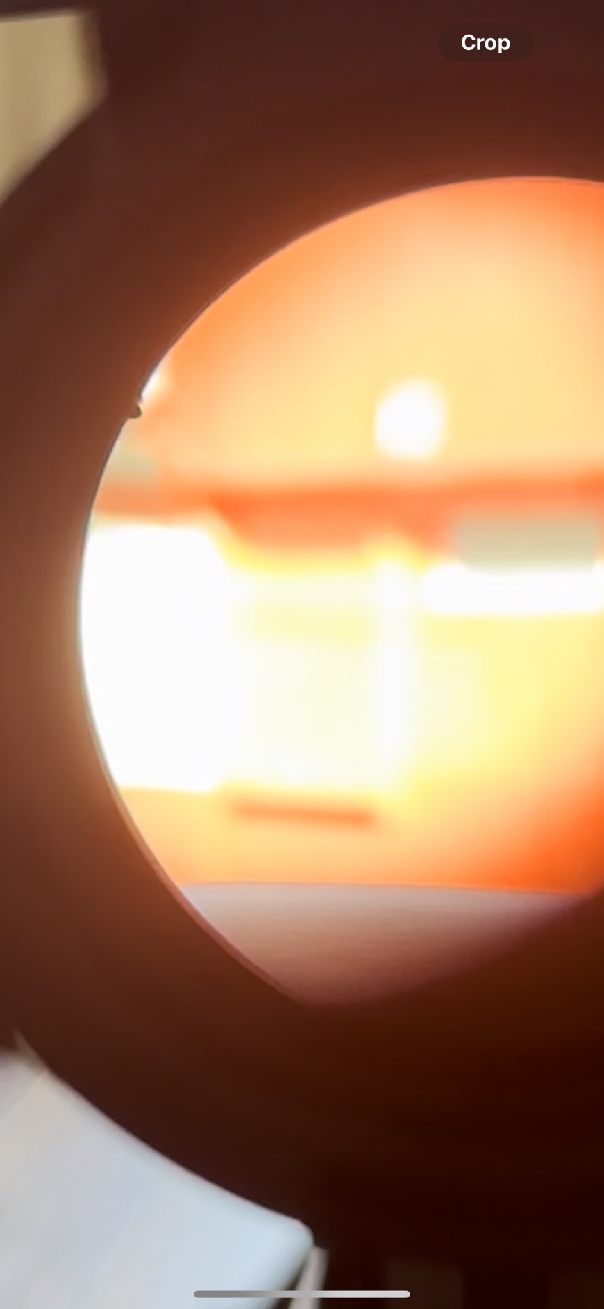

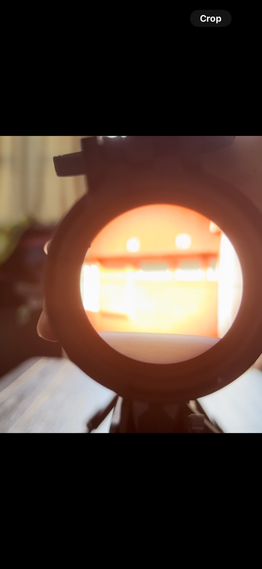

About last year! I sent the scope back for repair which is 5-45x56 high power, Serial number 478890. The problem was I found something at 11.00 (only at 5X) as i attach files to you.
Now one year! later I got back from S&B service and repair (I live in Thailand)

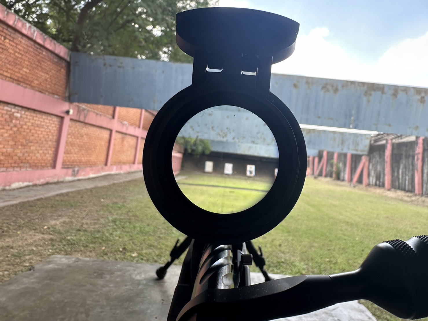

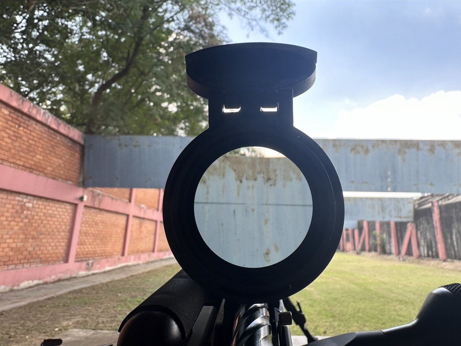

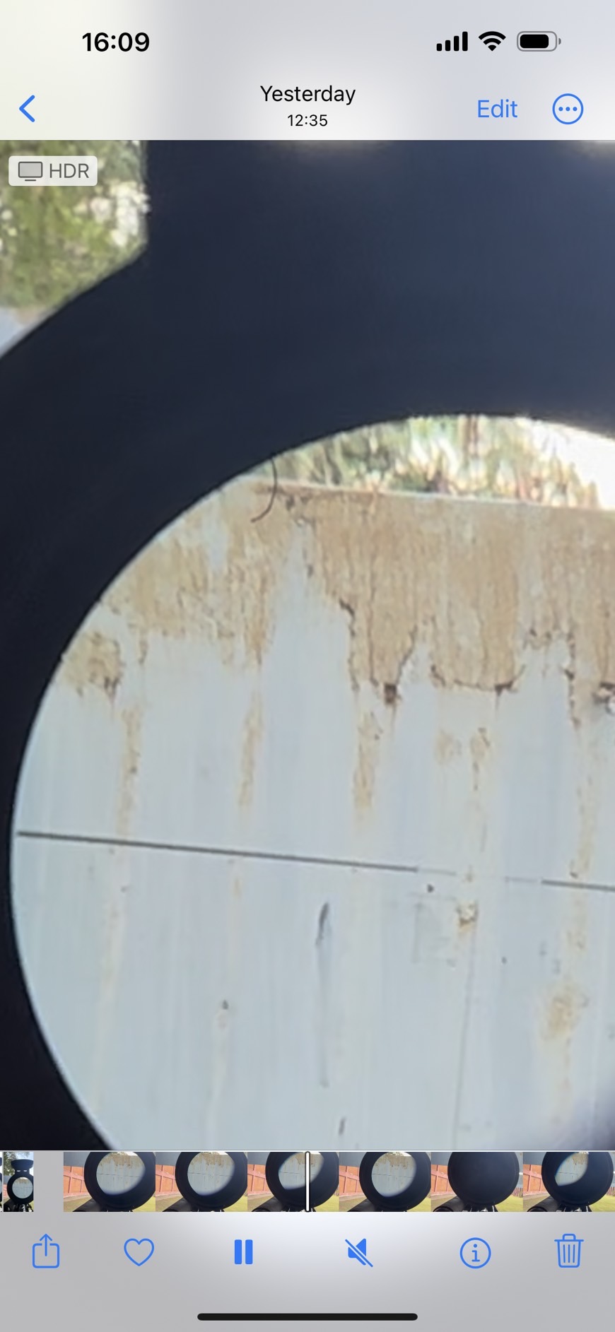

I thought the problem was solve but when I got the scope back i look it at 5x i still found something at 11.00 it look like J line at 5X (only 5X)
I'm so disappointed in S&B BRAND AND SERVICE because I have to wait 1 year for get the scope back and I have nothing to say and i don't know what wrong with the team service didn't check properly ???? Waste my time so much 1 year that i'm waiting.!!!
you can check who did repair this scope!? why still have something at 11.00
please email me back or do something S&B.
and right now I sent email to jerry ricker about 2-3 days ago and no one reply me back.
I have videos but don't know how to send in here. The picture with orange background about last year that i sent to S&B for repair and now at the range is current i still found something at 11.00 .

I believe thats a pubic hair.(Kidding--I think it's a hair from the super tight fit of two sealing surfaces) I had one in one of my old US Optics scopes.
If it's any hollow comfort, I would suspect the hair came out during transit, while things were still settling in the optic. Hopefully someone here can get you connected to someone at S&B and they can resolve this quickly.

I've seen that before in S&B's, we used to call it a fuzzle in the blend, a piece of lint or something that's on the leading edge of the reticle cell poking up in the field of view on low power only. Once you come off low power it disappears but to fix it the erector has to come out to clean the it. It's entirely possible that it got exposed to some other foreign debris in the process and what you see is the result. That little J shaped piece is probably barely discernable to the naked eye when the erector is out of the tube.

If that’s a hair, it’s part of the reticle. S&B first in the industry to do this….. No more dialing to shoot a hair off a gnat’s ass at 1k. Just hold over using the hair and send it.

Most of it has nothing to do with the function of the optic, more to do with things like small dust particles that work their way into view over years of hard use.

That and about 2019-2020 S&B got a bad lot of grease that would work its way into view overtime with use, it didn’t impact the functionality of the optic it was just annoying, so just send it in and they would replace the grease for you.

You will most likely have to send it back again for service and wait a time. Again, sometimes things get missed or were not visible at the time of last service. As many have said before, annoying yes, but this finding does not affect optomechanical performance. Whether to Germany or the USA, S&B service will get it handled.
