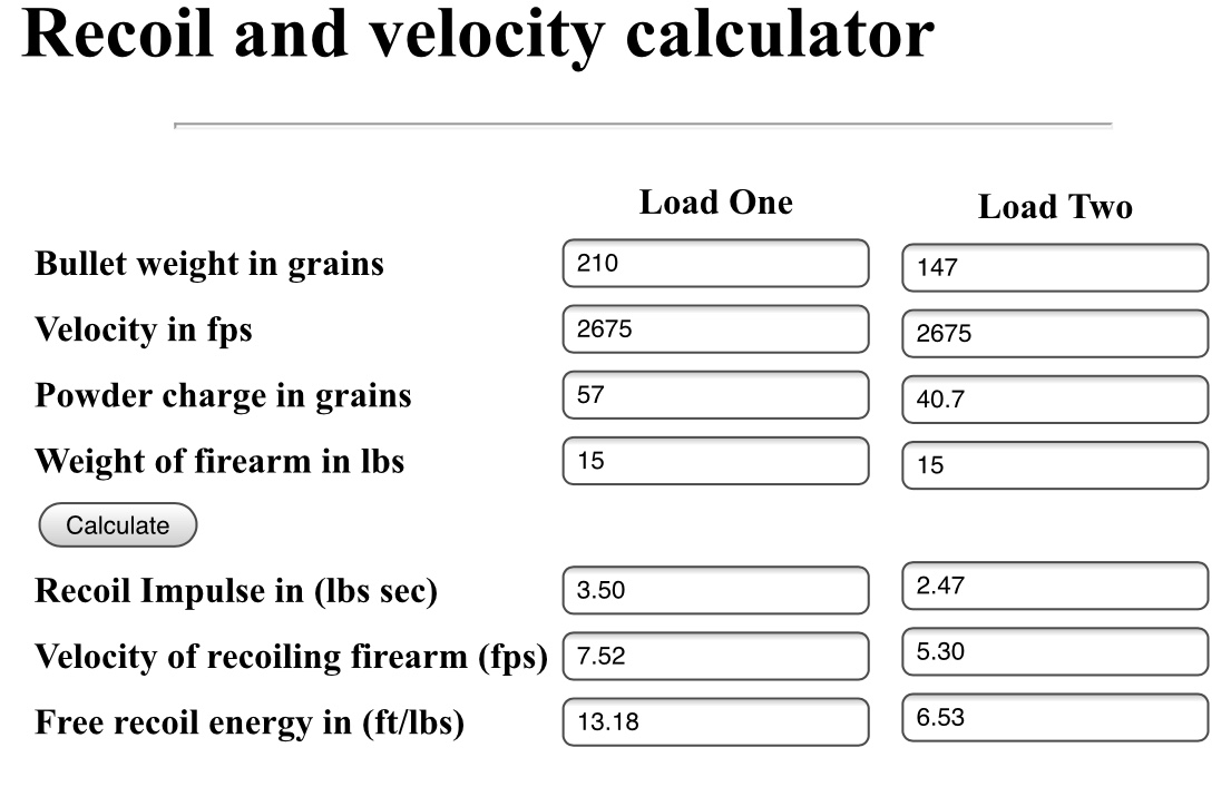

    Well, I was just looking at the new 200 grain .30cal SMK that has a BC of .700 and I got to thinking what does this give up to a 6.5? I'm sure I could drive it a little faster that what I am using now. I'm driving a 210 smk at 2675 and it has real world BC of .629 and it shoots pretty flat, I don't have my data in front of me but the last time I was out in 35 degree weather I was under or right at 31 MOA at 1000 yards.

    As said before 6.5s kill animals just fine. took two deer last year using hornady 143ELD-X. One dropped on impact, the other got about 3 steps before it was over, now these shots were relatively close so the energy was still high <250yrds It seems like now a days the variety in bullet choice is favoring the 6.5 over the 7mm. Lots and lots more available for all kinds of applications. .30 still has the advantage in the number of choices but to get the same or greater B.C you have to use a much bigger bullet. Some of which may be a little big for deer sized targets and smaller. As far as the recoil advantage. Again depends on use. In a precision rifle style match you’re going to want to be able to spot your shot, and probably don’t want to be quickly firing those thumping shots of the heavy .30 bullet from a 30-06 over and over and over again. Two things that might help you with that are your heavy rifle and a BIG BRAKE to bring that recoil down, now think about how much recoil you would have shooting a 6.5 out of heavy rifle and big brake. It be nonexistent. For a hunting application, I wouldn’t want to be carting around a heavy ass rifle mile over mile of terrain. All that weight adds up quick. it all depends on use and what your willing to sacrifice for $$. If it doesn’t make sense to go and buy a rifle for every possible use, from a medium-long range precision match gun, light weight deer rifle, light weight magnum big game rifle, long range target magnum etc etc etc then don’t. I like my 6.5CM it’s plenty enough for me to make an ethical hunting shot inside 400 or so yrds. Plenty enough to reach out and target shoot at 1200yrds, light recoiling enough to accurately spot my shot on a decent magnification at close ranges. There are better bullets and better calibers but for me it doesn’t make sense to go and build a rifle for every possible scenario and caliber. So to sum up. If it makes sense financially then buy one in something 6.5

    I dont think the practical relationship in bc between the two has changed much at all. Both bore sizes have seen improvements in bullets. You’re still left with the choice of shooting a heavy bullet(with a large cartridge to match) vs a light one. My current creedmoor load is a 147 eld at a pedestrian 2675 fps. 30 moa to 1000 here (2000’ASL), and a total pussycat to shoot. I’d choose it every single time over a 30 for target or hunting gun until the game gets big, and I have a dedicated hunting rifle for that.
