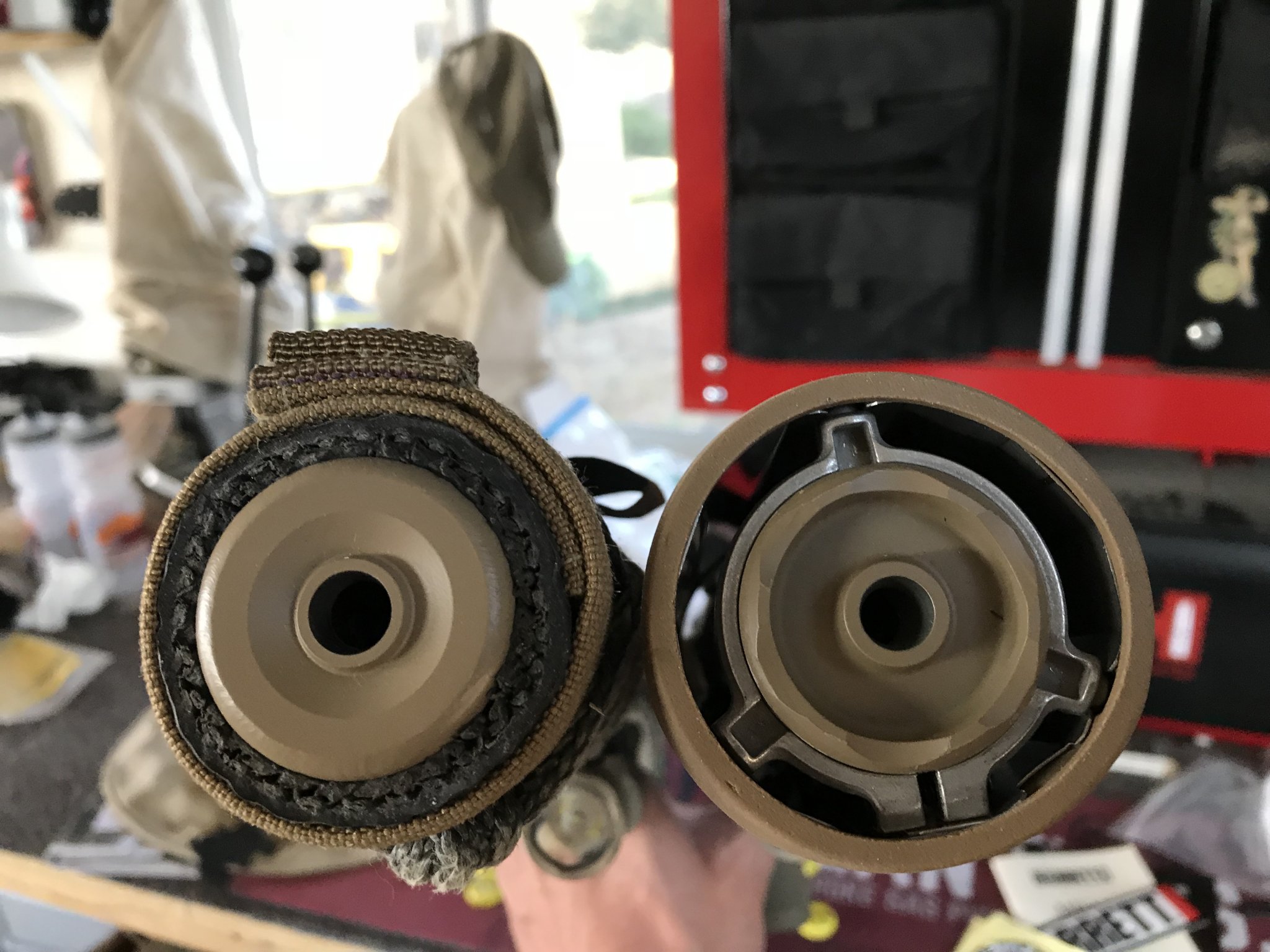

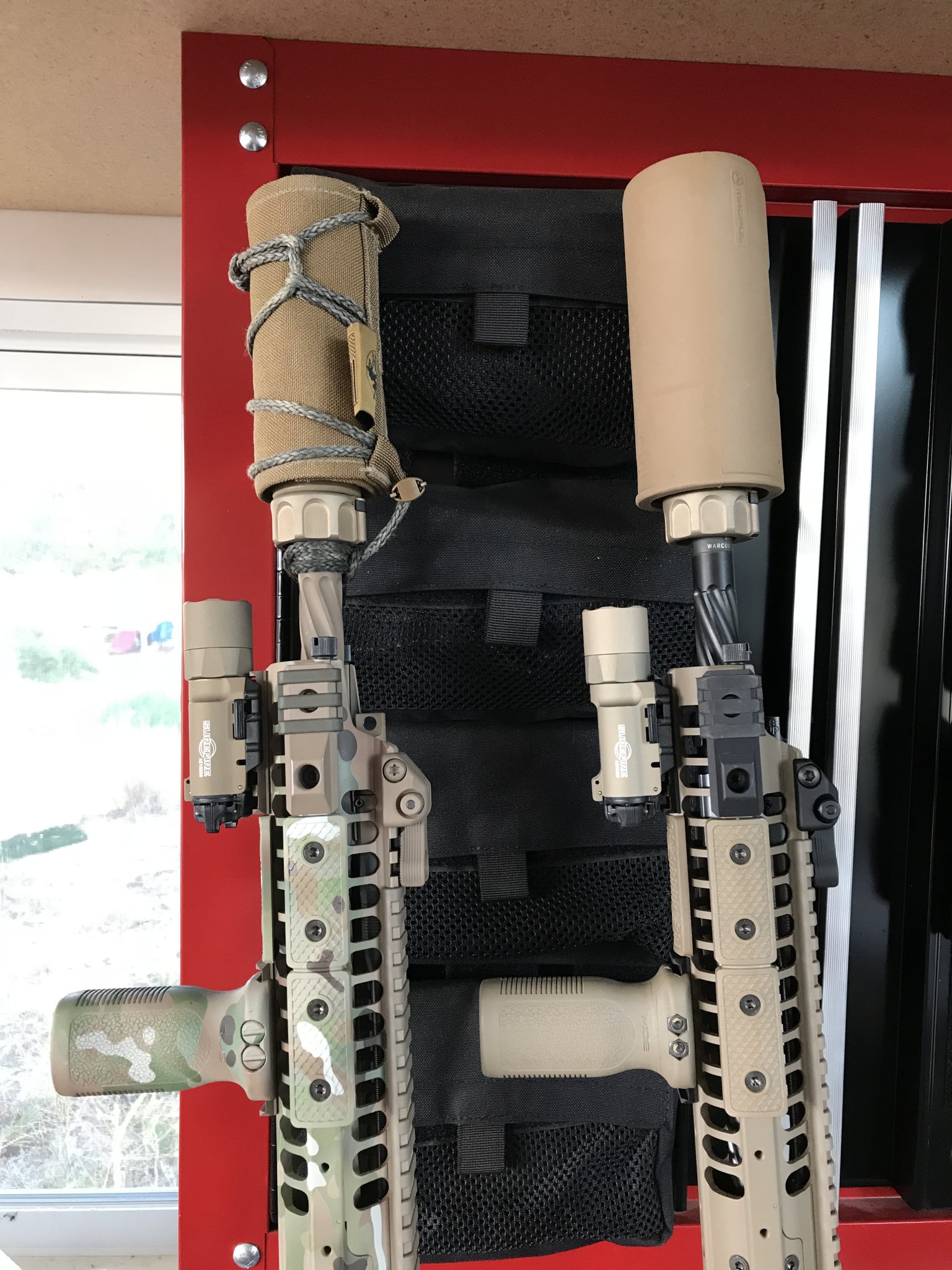

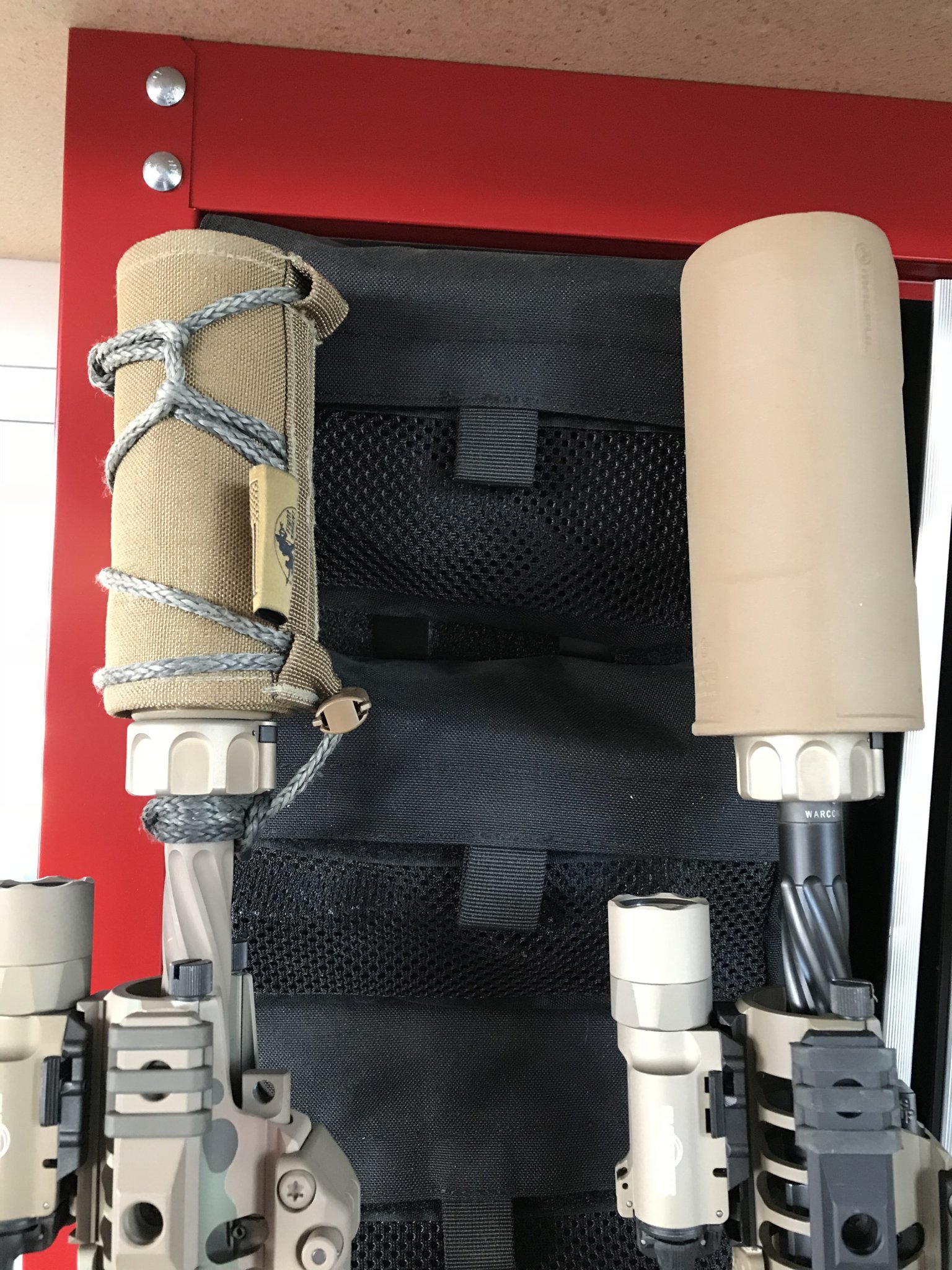

Got a new can coozy the other day, had a minute to screw with it this evening. Didn’t get to the range but will this weekend.
First impressions:
PRO: mounting is SOLID. I don’t think it will move a mm under any recoil
CON: lil bit of a PITA to get on. Won’t slip on/off easily to slip can into the SF pouch.
PRO: only points of contact are two slim, steel mounts. Vast majority of the can is open to air flow.
CON: it’s BIG. Looks Operator A F. I list that as a con because I’m not operator at all and stuff too tacticool makes me feel mall ninja.
CON: way heavier than it looks. Steel mounts and cylinder with polymer sleeve. Easily heavier than the HAD. I don’t have a scale tho.
I’m interested to see how well it abates mirage. I have a scoped Six8 that I can slip it on but I’ll only be looking at 6x. Hopefully magpul puts out larger sizes. Pics are of the magpul on a SOCOM 556 RC2 and the the HAD on a SOCOM68.

I finally got around to shooting with the magpul can coozy the past couple days at lunch. Not much time either sesh, but put exactly 300 rounds down range. LWRC M6-IC A5, SF SOCOM556, Aimpoint micro T-1, Federal XM193. Yesterday it was in the low 60s, today around 70F.
Day one I ran 7 x 30 round mags through it in roughly 20 minutes while moving through a 300yd course, so shooting fairly quickly and generating a good amount of heat. Controlled semi-auto fire at steel targets ranging from 50 to 200yds from standing and kneeling unsupported, standing and kneeling off of barricade. I suppose a reasonable approximation of a firefight with a standard loadout? (I dont really know, I've never been in one).
After the first magazine, there was barely any noticeable heat. After two the surface was only slightly warm. It wasn't until after the 5th magazine that the cover was uncomfortable to hold onto with a bare hand. Even after 7 mags I could hold the cover for a moment without pain. The locking ring of the can was way too hot to touch and would have burned skin immediately, melted cordura etc.
The polymer outer cover at its hottest was much more pliable, moved around quite easily on the steel sleeve. The cover mounting ring proximal to the locking ring of the suppressor moved slightly under heat and recoil towards the 'button' on the can and precluded unlocking of the ring until I could tap the cover up out of the way with a brass hammer/ punch. The screw was loose. I cannot recall if I used locktite when I put it on but I don't think so, so that's likely my fault. As with anything under recoil: thread locking compound required.
While shooting I definitely noticed the increased weight at the end of the 14.7" barrel. I'm not one to bitch about weight, but it's added in the worst possible place and the balance point of the carbine was significantly further forward. I didn't like that when shooting unsupported.
Subjectively, it seemed that the can did cool down much more quickly than when using a HAD cover, and I was able to remove the suppressor and set it down without fear of burning anything much sooner after cessation of fire. I don't have anything empirical here though.
Today I only had about 10min at the range and three loaded mags. The cover was not too hot to hold onto when I was done, the can definitely was. I was able to remove the suppressor from the rifle after only a couple minutes.
My conclusion is that the design is more efficient at mitigating heat buildup, protecting skin/gear from the hot can, and heat dissipation than other designs I have used. I cannot comment on mirage first hand (shooting only 1x) but I surmise that would be effectively mitigated too. BUT, it's not worth the weight of the current iteration for a service rifle/carbine. On a belly rifle with a high power optic perhaps, being supported by a bipod or rest, but subjectively it made an otherwise pretty handy carbine seem sluggish.
