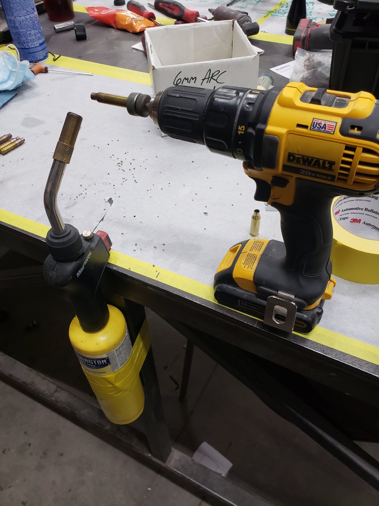

Is this method pointless or worthwhile with similar placement/timing of each cartridge?

I used to flame anneal and it can be done consistently. I found the trick to be moving the case farther away from the flame so you don't have to be as quick or precise to get the case out at the appropriate time. I also used a homemade holder/motor contraption to turn and "eject" the case when done. I set the flames so it took about 12 seconds. I say "about" because at that timing, you can see the brass change color as it anneals. I would set up so the flame hit just above the shoulder, and I'd watch until the annealing color change went just below the shoulder, using a metronome to time so I knew when it was getting close. I know people will scoff at this method, and give all sorts of reasons why it doesn't work, but when done carefully, it can be just as consistent as other methods. I moved to induction annealing because it's far less time consuming and there are no open flames.
I see no difference in results between the two methods - they both were part of a process that consistently delivers low SDs.

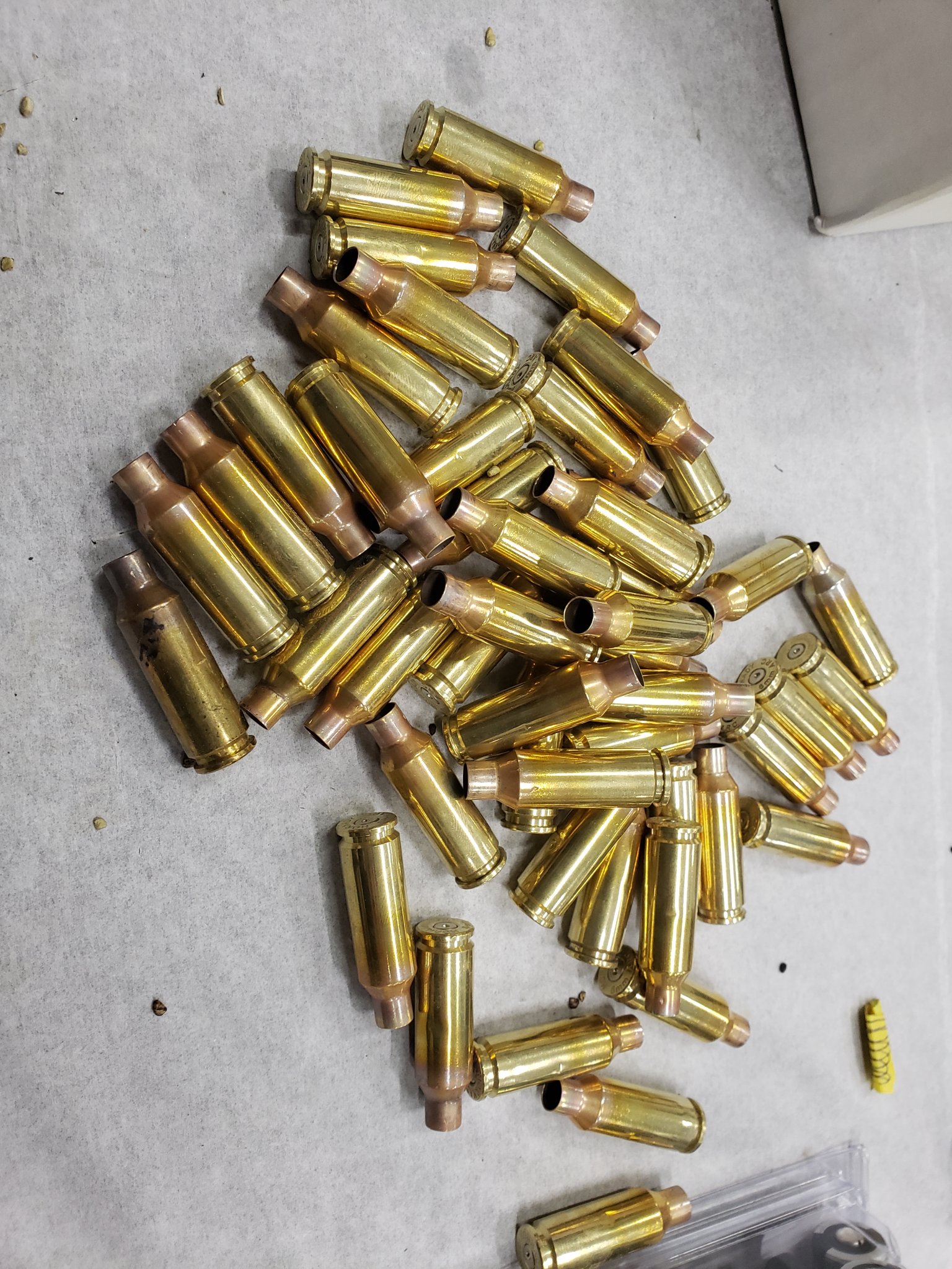

Gave it a try on a few..seemed to work fine
Looked like over annealed to me in that vid

I do it freehand as well, very therapeutic and Zen. However I only do fifty or so cases at a time. I have my eye on an AMP 'cause I love cool toys but can not justify it yet.
I use the drill/socket/torch method too, and for 100 cases at a time it's not too terrible. I use a timer set to 10-12 seconds and stop/start the timer with every case so they all have relatively the same amount of exposure to the flame.

I try to aim for (or hope for) ~90%, which I think is achievable using my caveman setup lol. Works well enough for me to keep my SD's in single digits, and my brass lasts as long as the primer pockets will hold on.
I did this exact same thing for a while. I had a hard time with consistency and I finally bought an annealeez machine from someone here on SH. I think if you could get the consistency part figured out it would definitely work.
I dim the lights and stop as soon as I begin to see orange regardless of time. I'm getting single digit sd's with all of my hand loaded cartriges and multiple reloads with all my brass. And that's the whole point. If I ever find myself needing to do more I'll certainly consider a machine. Guess I just dont shoot enough.
