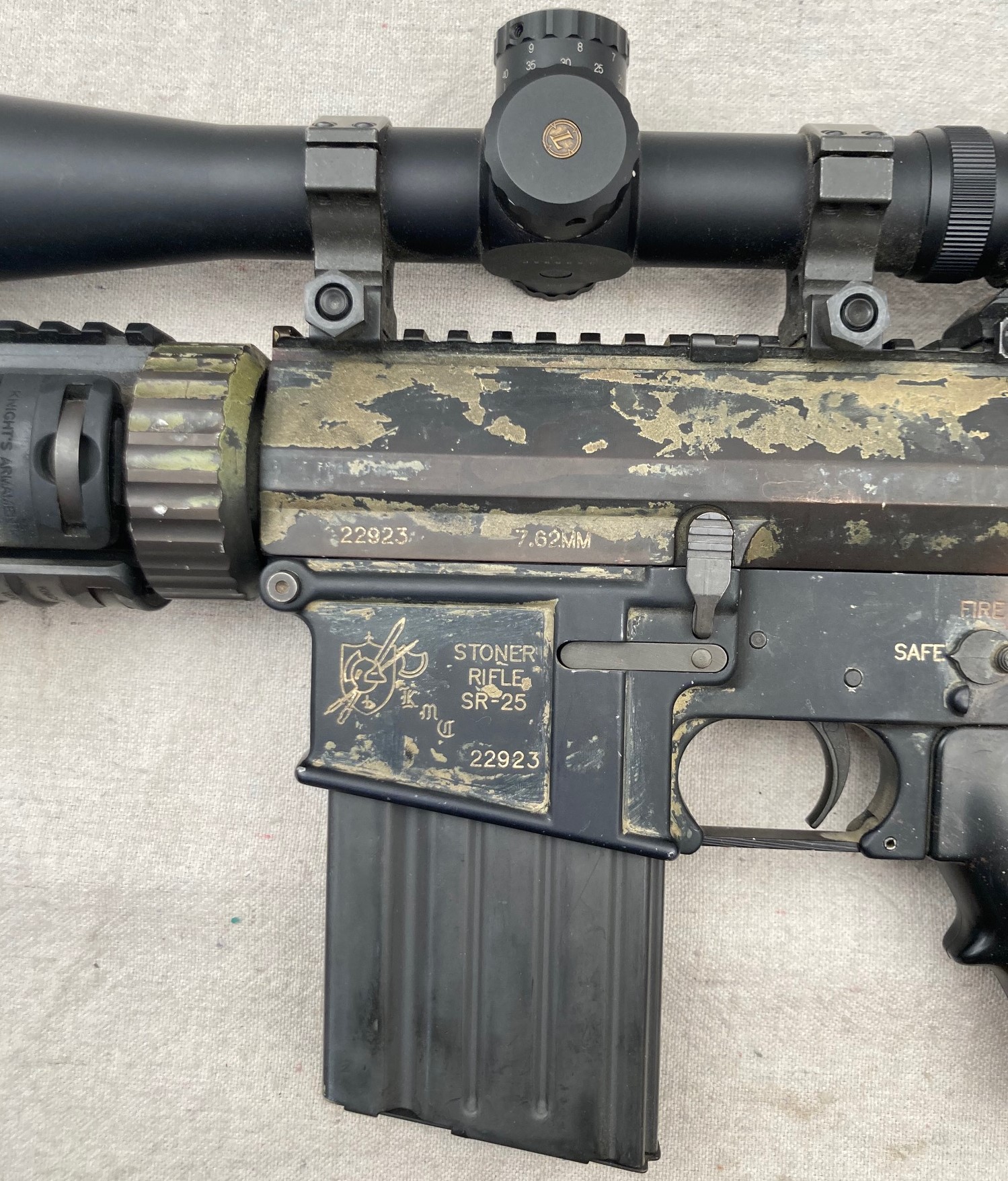

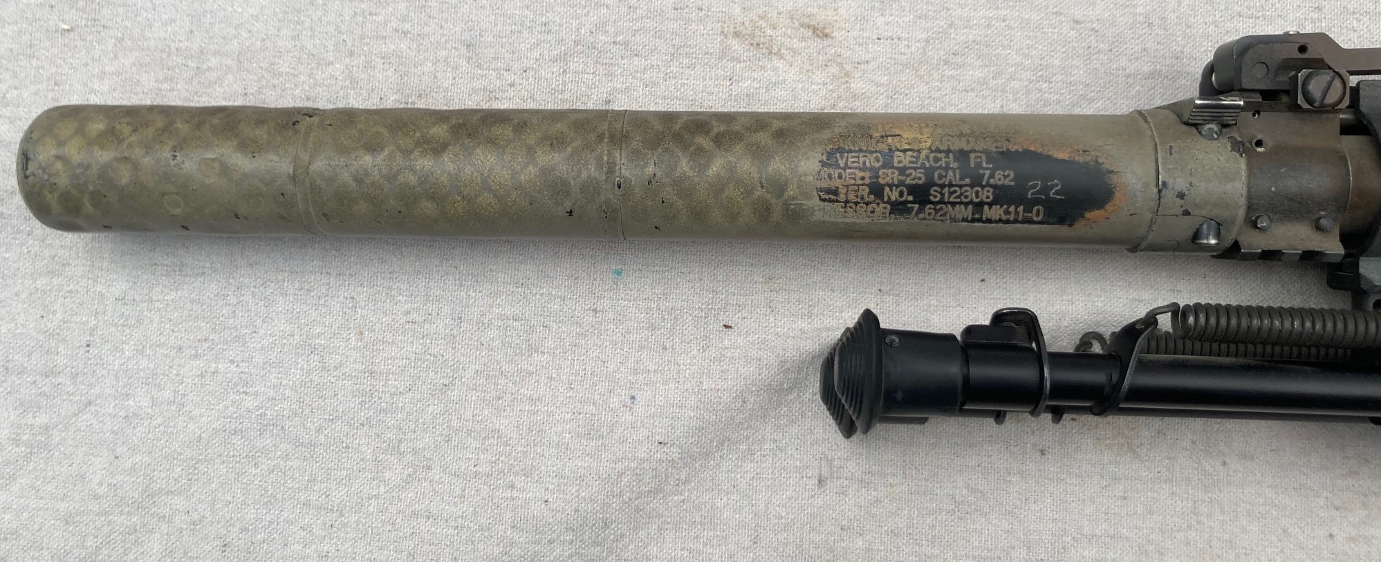

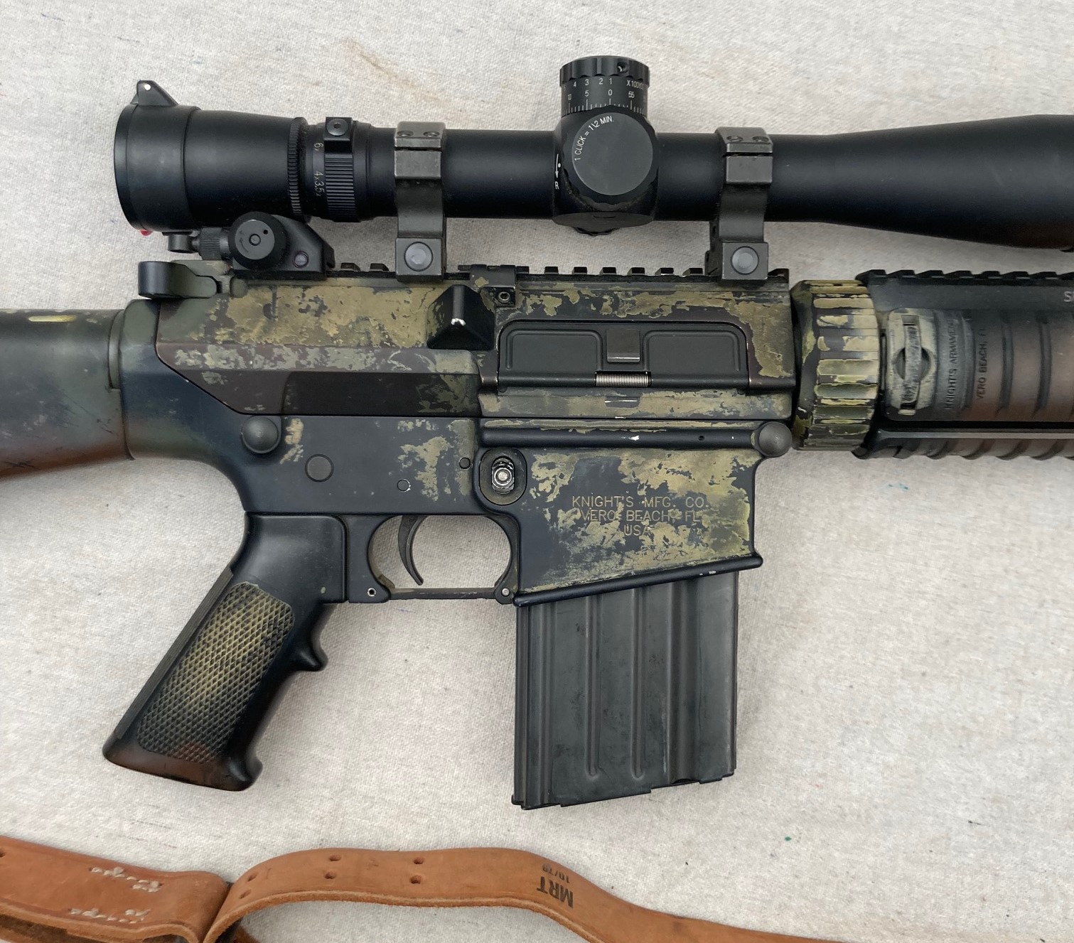

Very very early 25s.

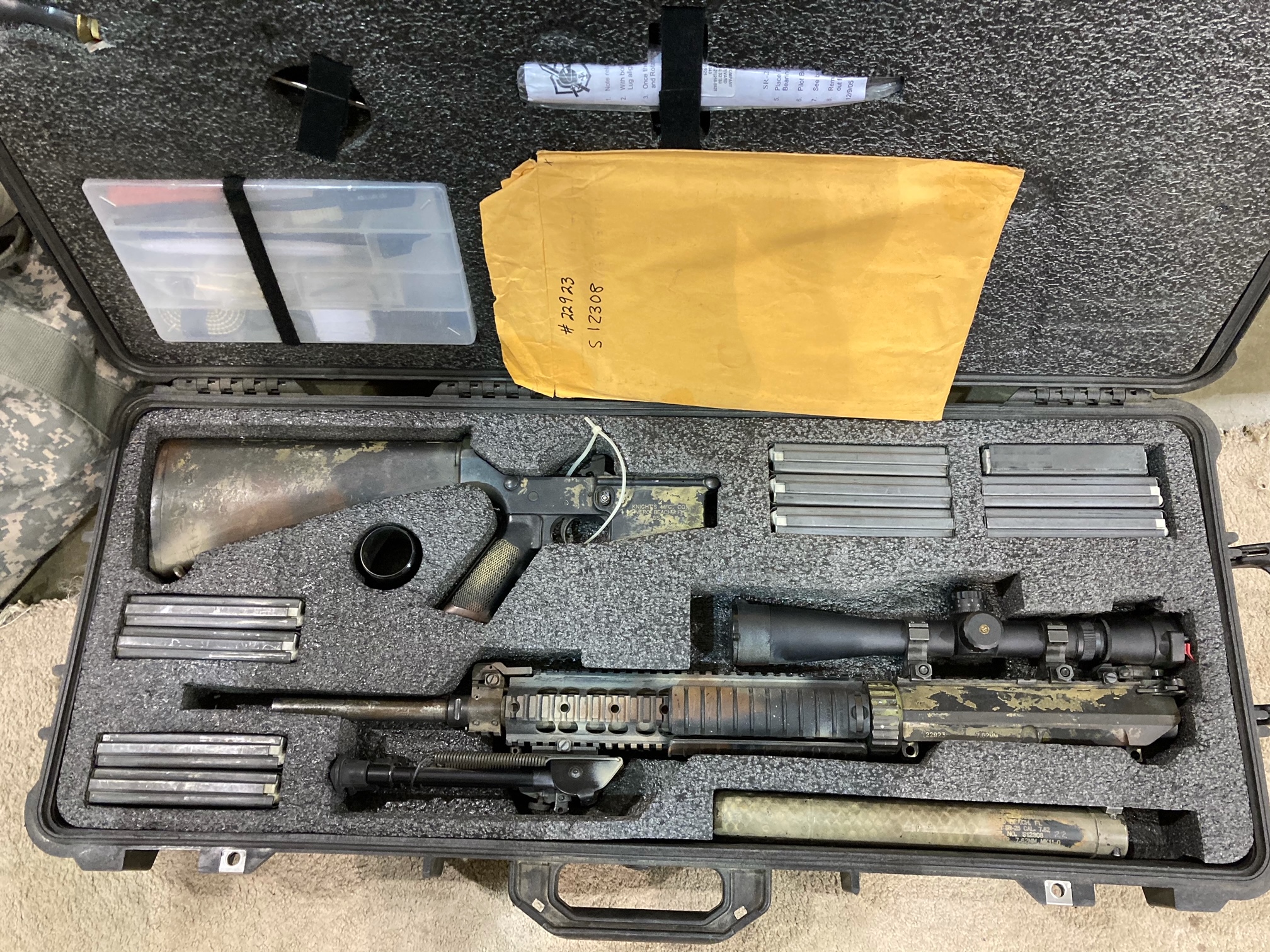

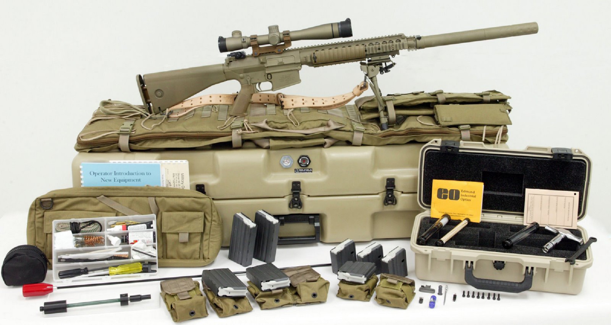

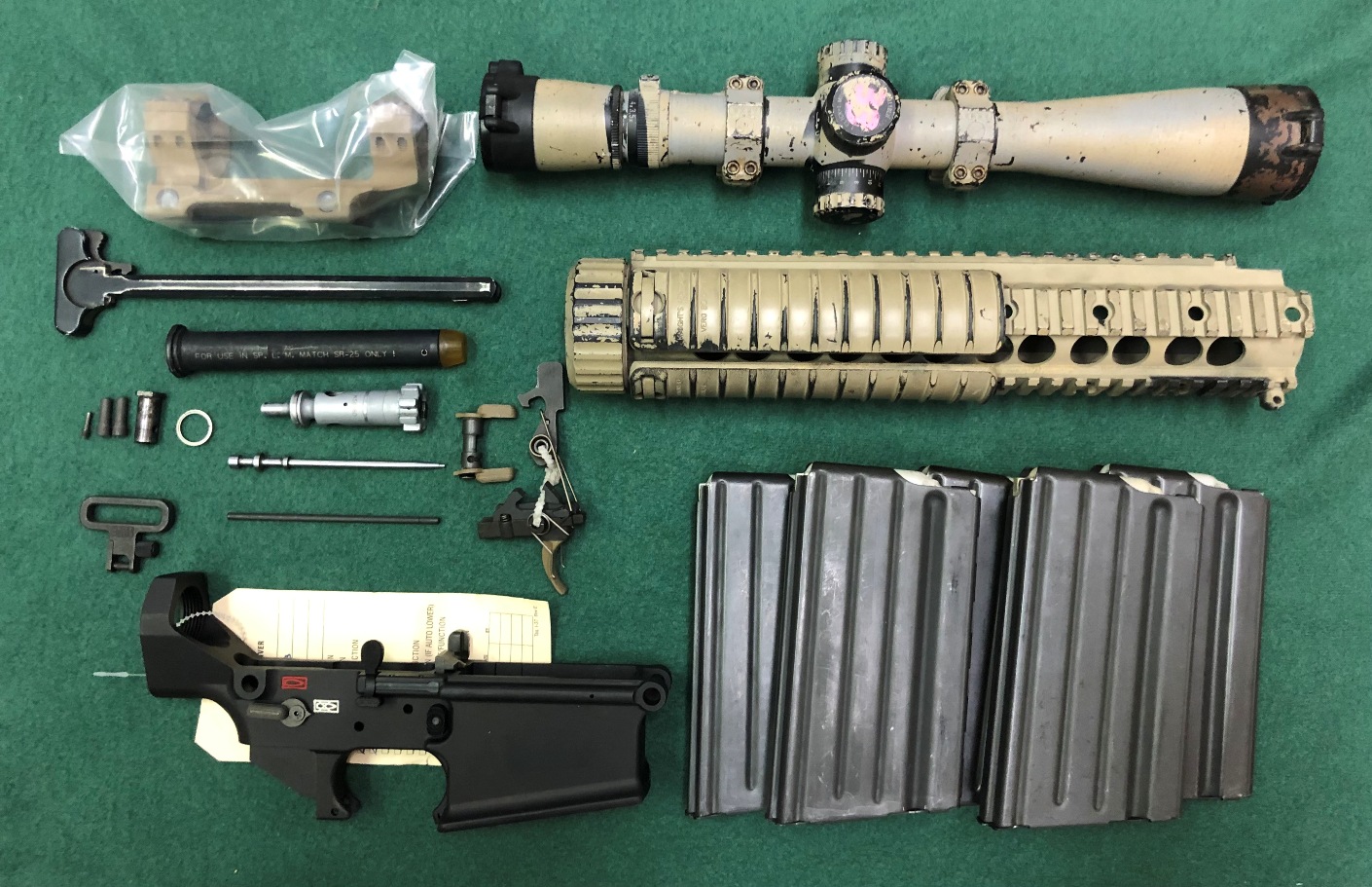

Fwiw, here's parts collected for a quasi-replica Mk 11 Mod 0, but with a poor man's LMT lower instead of KAC, but I still don't have an upper.
I have a salty Mk 11 Mod 0 transport case as well. It's a back burner project that I hope to complete one year....
Armalite uppers (though you'll have a different barrel nut thread pitch) and BCGs will fit on an LMT. May save you some time, money, and frustration.
Centurion Arms uppers are a direct clone swap, but haven't seen any in a couple of years. Matrix uppers may, but they have a forward assist (vice the KAC-LMT without).

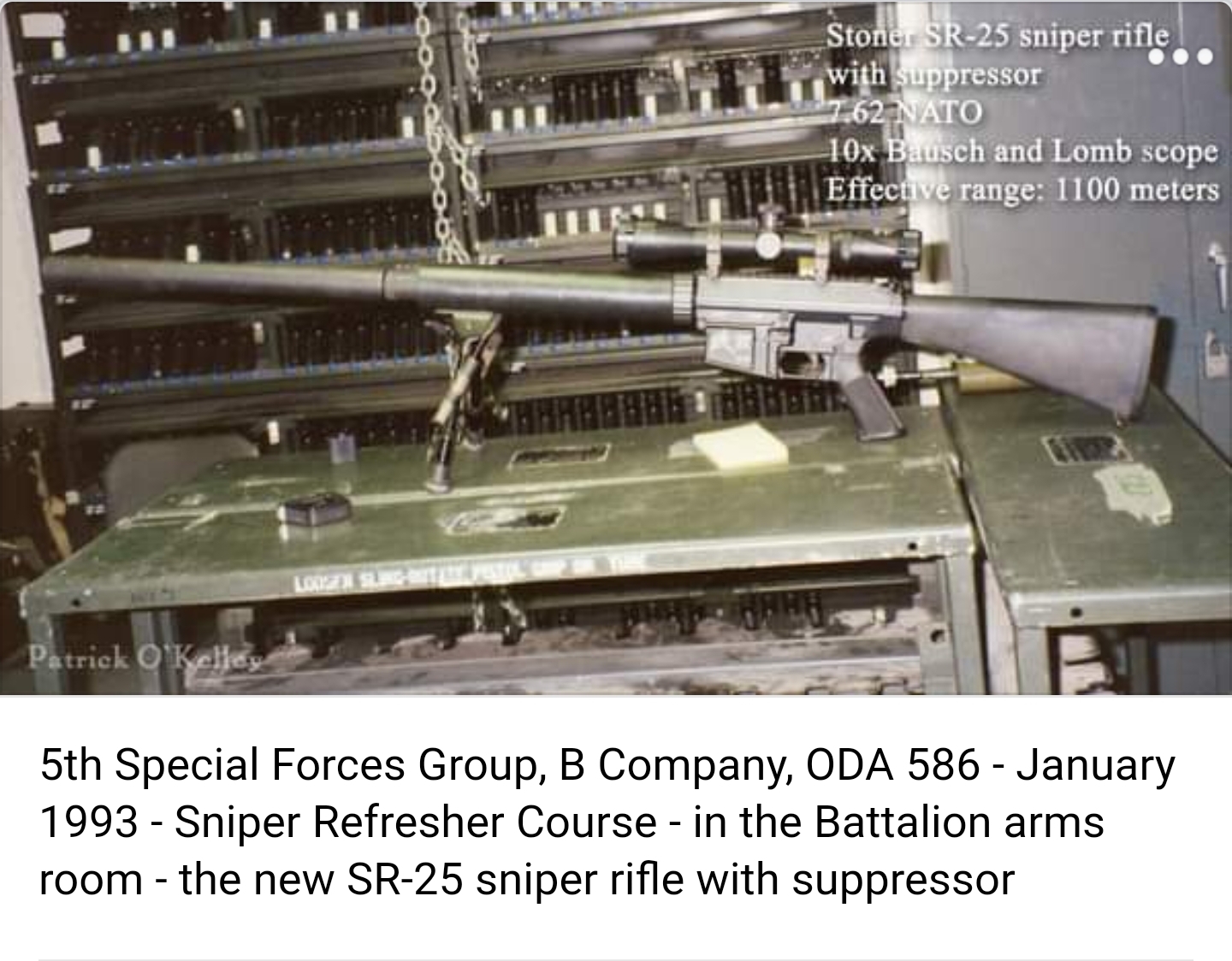

The dates on these pictures are interesting, August 1992 and January 1993. The early civilian sales of the SR-25 Match Rifles were happening almost in parallel. The markings look slightly different (address on the right vs. left), but the configuration appears to be the same.
Nice early SR-25s, they look pristine. Thanks for the pics(!).
My understanding of the history is that Reed Knight provided some no-cost civilian SR-25 Match rifles to Crane around 1992-93 and asked them to test them. The military threaded the 24" barrels for a suppressor and some of these prototypes apparently went to Somalia for field testing. The field reports must have been positive enough, given that 80 SR-25s were purchased in 1995 by SOCOM, and some were used according to Larry Vickers by Delta Force. I suspect the rollmarks on those rifles were similar to your 92-93 rifles, as the "Mk 11 Mod 0" military nomenclature didn't occur until I think 2000 contract award? (In other words, I don't know if the "pre Mk 11 Mod 0" rifles had a military designation in the mid-1990s, other than "SR-25" rifle).
My impression is that Crane worked with KAC for years and provided input re improvement opportunities, and so I imagine dozens of civilian-based SR-25s were being used by SOCOM/NSW/Delta/SF, etc in the mid-to-late 1990s, getting refined along the way (shorter 20" barrels, new handguards, sights, development of the quick detachable sound suppressor, improved mags, etc). Re the waffle mags, I recall an engineer at Crane telling me the original AR-10 waffle mags had issues re reliability, and that was one of the things that Reed Knight agreed to address during the product improvement process circa mid-1990s). The first 365 Mk 11 Mod 0s were ordered I think in May 2000 for NSW, and they were stamped with that nomenclature. That's all I know.
My impression is that Crane worked with KAC for years and provided input re improvement opportunities, and so I imagine dozens of civilian-based SR-25s were being used by SOCOM/NSW/Delta/SF, etc in the mid-to-late 1990s, getting refined along the way (shorter 20" barrels, new handguards, sights, development of the quick detachable sound suppressor, improved mags, etc). Re the waffle mags, I recall an engineer at Crane telling me the original AR-10 waffle mags had issues re reliability, and that was one of the things that Reed Knight agreed to address during the product improvement process circa mid-1990s). The first 300 Mk 11 Mod 0s were adopted I think in May 2000 for NSW, and they were stamped with that nomenclature. That's all I know.

The first rifle pictured above still has the preservative tube in the barrel, it was just removed for the pictures. It has the original Gun Guard case and shipping box from Knights.

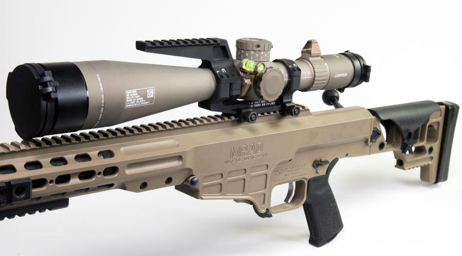

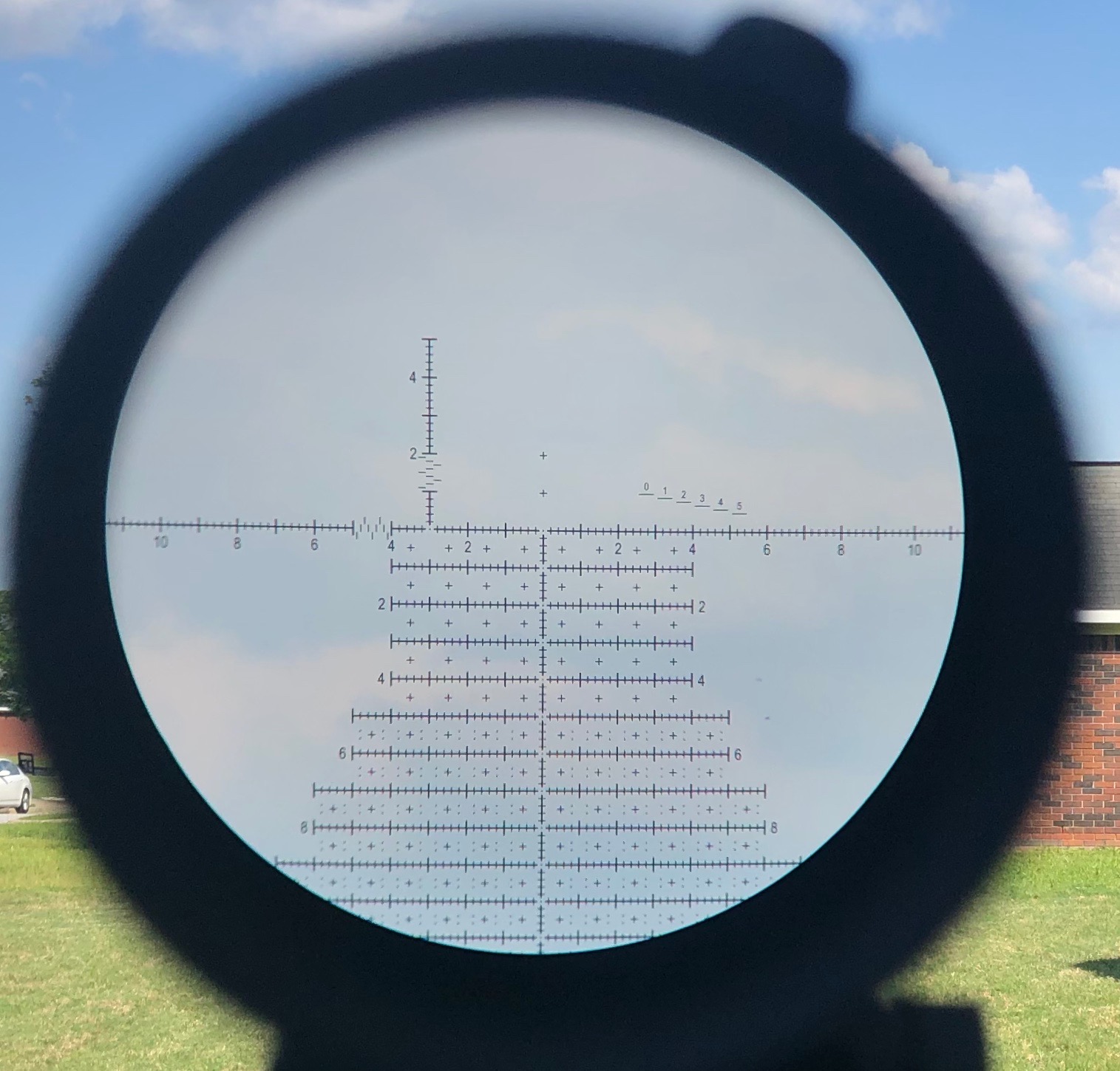

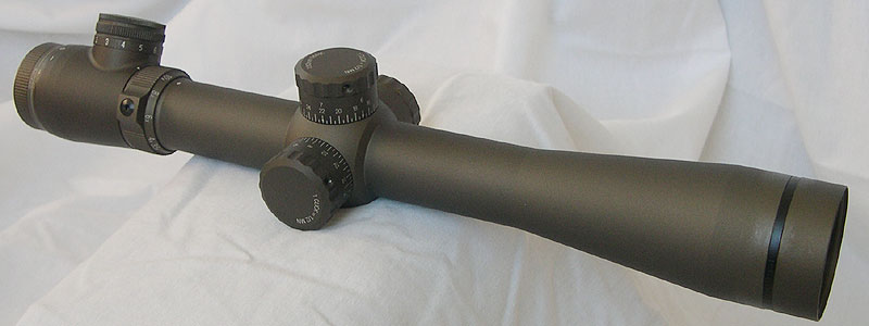

I understand the the Mk 11 Mod scopes (Leupold 3.5-10x) and later M110 scopes (FDE colored Leupold 3.5-10x) were both second focal plane (SFP) scopes. However, I will note that some Crane-based Mk 11s used by Army Rangers (& perhaps others) used scopes that had been modified by Premier Reticle w/ Front Focal Plane (FFP) and what was called a "Gen II" Mil-Dot reticle. A guy had 7 of more of these for sale last year from a gov't auction, and I bought the salty one with old ARMS rings and a lot of patina. The serial number prefix is 2003-dated (they were mostly 2004 dated scopes). So this era was way before Leupold offered FFP scopes. I was curious about this scope and asked someone at Crane about this odd auctioned-off scope, and learned it was part of the 'INOD Block 1' contract circa 2004, that I think went to Ft. Carson. (I heard these ARMs rings tended to slip)
Re the reticle, Crane noted this: "Haugen wanted the FFP Leupold as well with the GEN2 mildot. That caused some issues with Premier reticle in the future as Leupold did a slightly different version (TMR?), but too close to the copyright or patent pending from the Thomas’s at Premier. Shortly after the award, he had the entire setup he wanted and we modified it into the contract."
So it sounded like Crane modified the optics contract to allow the FFP conversions for some scopes that were used on Mk 11 Mod 0s. I subsequently asked Haugen (former 1st SFG SOTIC instructor before joining Remington) about this topic. He recalled: "I pushed to have FFP on the optics because as I am sure you know on a 2nd FP optic the mils are only relative at a specific spot and I knew that guys in combat would not remember that that they had to be on a specific power when milling even though most would have LRFs going in. Additionally with NVGs the FFP was more of an issue mainly because in 2nd FP the reticle remains the same size and under NODs it can be a bit distracting."
...So he made it sound like perhaps night vision devices do better with 2nd focal plane scopes? If that is so, and assuming I understand what he wrote, perhaps that might explain why may have SEALs preferred SFP back then? I have no personal experience re this night vision topic and SSP vs FFP reticle, just a random theory about why SEALs might have liked the SFP scopes back in the day.

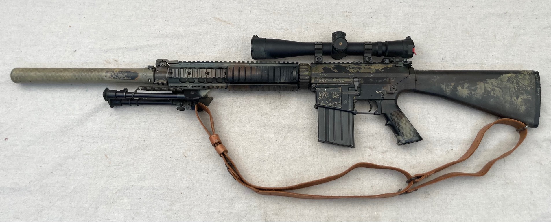

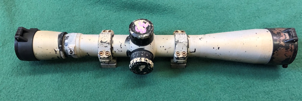

Lastly, a local buddy who was an Army Ranger and had a Mk 11 issued to him and I learned that his rifle also had the same Leupold FFP Premier Reticle scope. This PRS stock was something given to him for T&E purposes. (I think he still has it somewhere). He liked the Leupold FFP scope and the rifle, but said he was later issued an M110 and didn't think it was as good as his Mk 11, and he didn't like the original NF 3.5-15x scopes either, mainly because they were SFP scopes, and he preferred FFP. I always found that curious that he preferred the Mk 11 over the M110.
Anyhow, I think for nostalgia purposes he bought the last of these old DRMO'ed 3.5-10X Leupolds w/ Premier Reticle FFPs.

Younger SF snipers are also moving to the Army-issued Leupold M5HD standard on the M2010, and the HORUS-type reticle due to Todd Hodnett influence starting around 2010-ish.
I don't know what scope they ship on the new Barrett 300.
"The U.S. Army Mark 5HD 5-25x56 will come in a proprietary flat dark earth coating and utilize the Army’s patented Mil-Grid Reticle. The Mark 5HD will be mounted on the US SOCOM selected MK22 Mod 0 based on the Barrett MRAD bolt-action multi-caliber system chambered in 7.62×51 mm NATO, .300 Norma Magnum, and .338 Norma Magnum."
Apparently has a special reticle that the Army developed and patented (this is probably reticle at 25x):
I guess whoever designed that reticle has never heard of Holdunders.
Spotting impact - 99.9% of the time
Holding under - .01% of the time
Yea i get that it makes it easier to see trace but having a 3 or 4 mil vertical stadia would solve the issue without compromising the optic.
But lets be real, with the massive grids and hold overs if you can see your impacts through that a few extra mils of vertical will not make a difference.
Well if you dial and get your distance wrong, you can hold a faster follow up shot. Yea you won't have wind holds but can copy/paste it it get it close enough.
