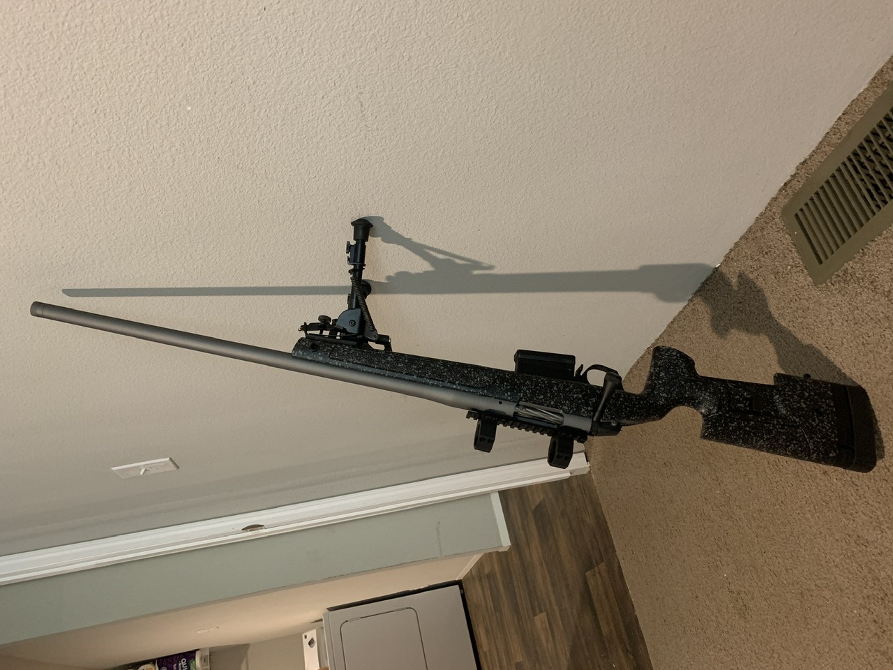

Recently picked up a Bergara HMR pro 6.5 creed. This is by far the nicest bolt rifle I have owned. What should I be expecting in terms of accuracy? If anyone would care to share any groups it would be appreciated.
Waiting on my PST 6-24 to come in from euro optics.

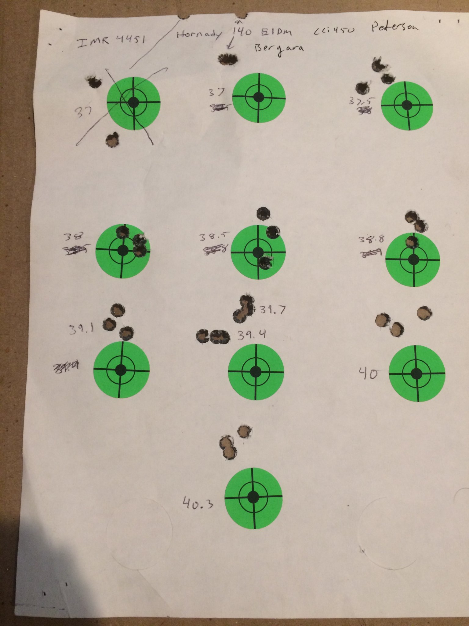

Ran some 130 Berger hybrids with both IMR4451 and RL16 the same afternoon. They ran about an inch with the IMR4451 until the upper end of the loads I was trying and closed down to a couple of acceptable groups which can just be covered with a dime at 41.3 and 41.6 grains. Again only three shot groups so I don't feel they're statistically valid. These loads and the loads in the photo above are reduced from the published loads I've seen because the Petersen brass has a slightly reduced capacity. I think my rifle will safely handle a bit more powder, and there may be something decent to be found there.
The RL16 gave an easy 100fps boost, but only brought 2 rounds each charge and didn't bother grouping them, just sent them at steel for the vel. numbers.
