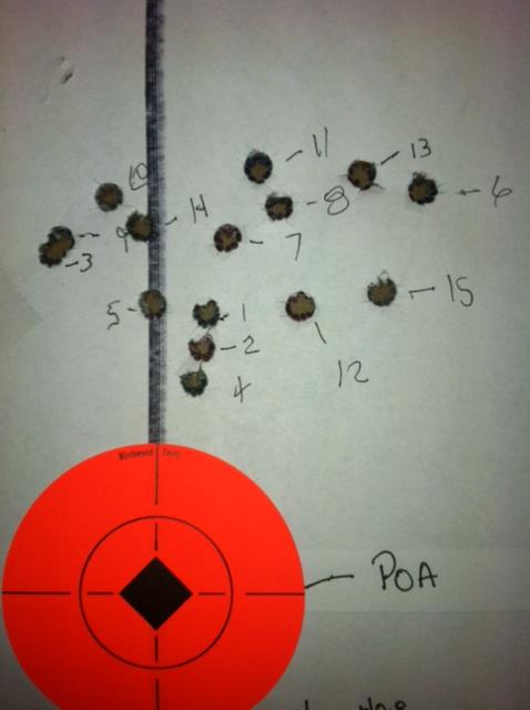

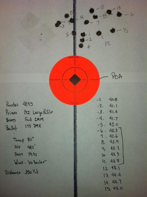

    The best grouping that I see is for shots 6 through 11.
    Am I reading this correctly?
    Details:
    Powder H4895
    Primer CCI large rifle
    Bullet .308 175 SMK
    Brass Fed GMM
    Rifle GAP Rock 22 inch barrel
    Cleaned barrel after 6 shots. Fired one fouling shot then 5 on the ladder after each cleaning
    Temp 80 degrees
    Alt 482'
    Press 29.92
    Wind No factor
    Range 350 yards
    Thanks

    Looks like you have a fine shooting rifle to shoot like that at 350. I would say 6 - 11 is definitely your accuracy node. Load 3 up at each and try em at 350.
