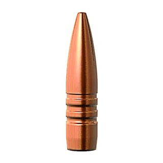

So it sounds like I might be going on a hog hunt in Texas this March. I have used my 308 and dirty 30, but would like to take the AR. That being said, all of mine are 14.5” pinned. What bullet would yall recomend, and what speeds should I be looking for with it? I was thinking the 70gr tsx or maybe a gold dot. But not sure if I can get the speed I will need, and was looking for other advice. I will be relaoding my own ammo to do this with. Thanks
Might consider the standard 77 SMK.
Nothing wrong with the 70 grain ttsx
I have a bunch of it loaded up, and is what I keep in my ARs. But, I am only getting 2500fps with it. It is an accurate load, but I was worried about using it. I did read a couple threads here where people were using the 77smk. What speeds do you think I would need to get it to to be effective, or will 2500fps be ok? It has been A LONG TIME since I hunted hogs, and was always with 30cals.

The OPs 70gr TSX will perform well down to 2K FPS...that'll give you probably ~ 200 yards if muzzle velocity is in the 2,500 range. Plus that bullet will penetrate the shoulder and get into the spine...so you aren't stuck with just head/neck shots.
Personally I'd go .308 all day and never look back.
I like the lighter TSXs for a little more velocity. I’m pushing 62s at 3000 out of a 16” with a can. It gives you more room to get down to expansion velocities than starting at 2500 with a 70.
