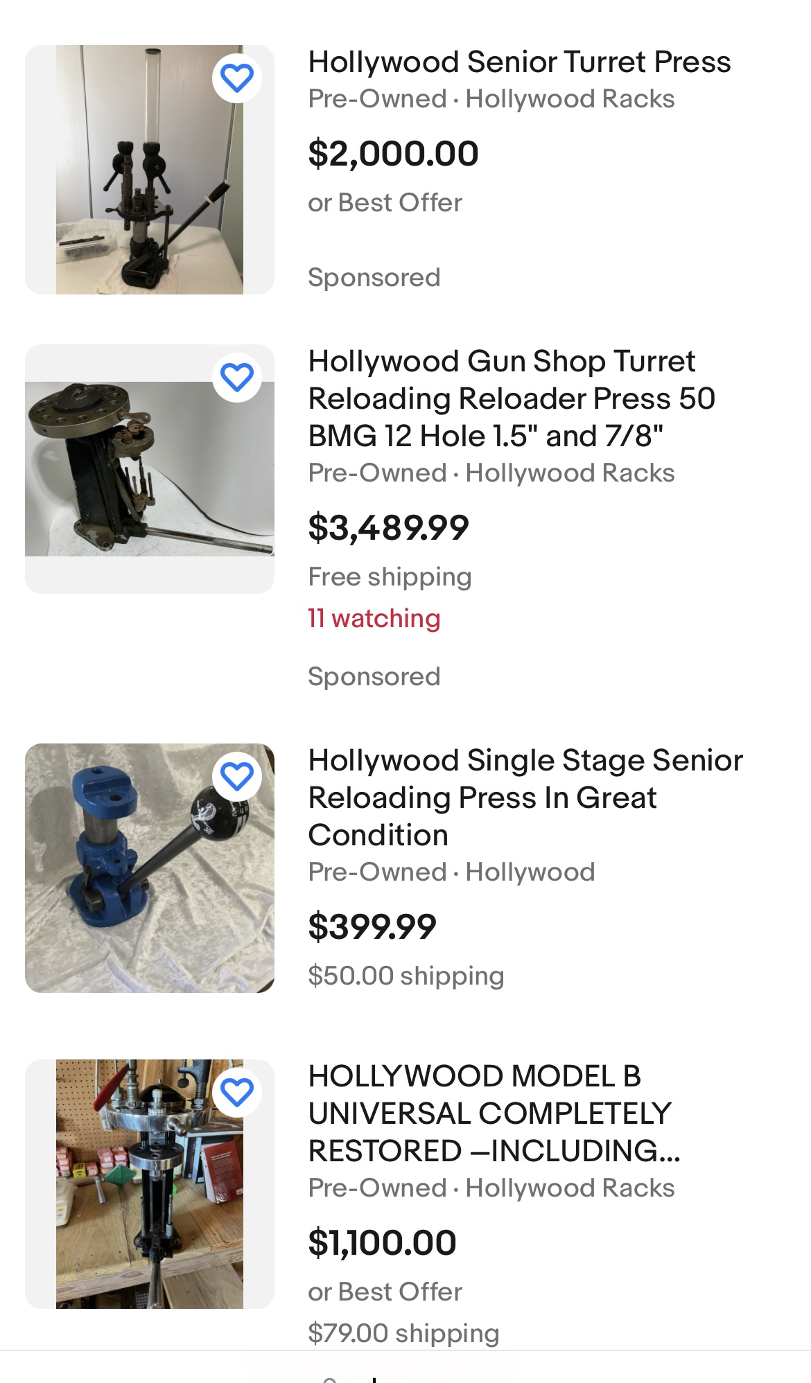

If someone wanted a Hoss of a press, that Hollywood turret press would be it. Some of them already have 7/8"-14 turrets, some have 1.25" or 1.5" by whatever threads. There are sellers on eBay who still make shell holders and priming rams for these, so thats no big deal.

is this the same thing you saw ?
and if i can get my hands to type you said they had more of these ? on amazon ?

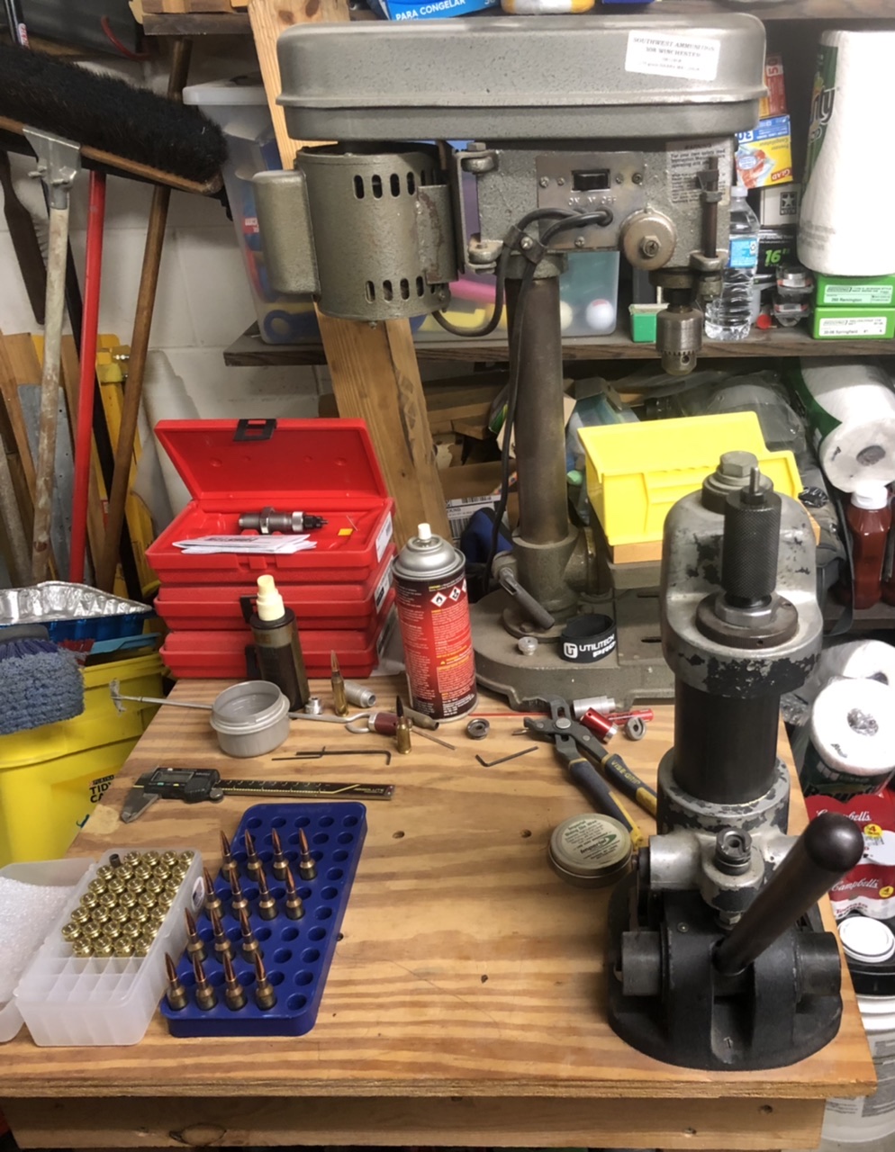

You mean like this?
I have been using this press to load since the early ‘80s when I was given it by a family friend who had used it for many years. It just works and I wouldn’t trade it.
