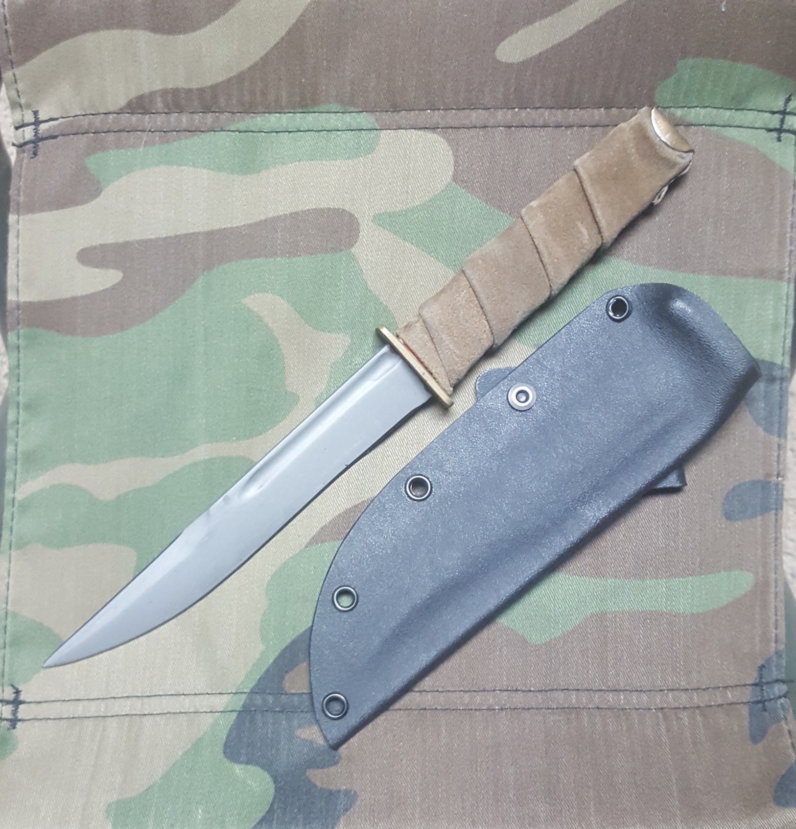

That tanto was to see if I could make by hand, a kanmuri-otoshi blade. The tsuba is simple brass, and I used combat boot to wrap the handle with. A artillery(Army) collar device brass disc is the pommel. The leather and disc are held on with epoxy'd nails I forged out of galvi steel hanger wire using a torch and vice and small hammer, and a Dremel to grind points, then heat treating.
