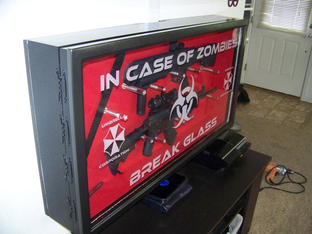

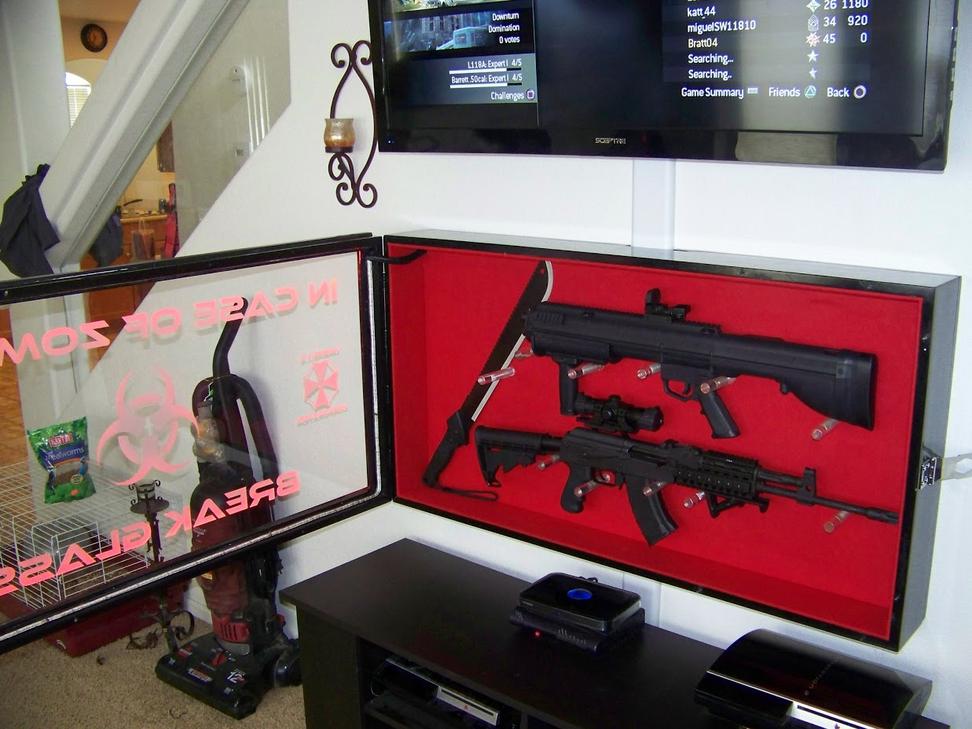

Hey guys!.. Pretty impressed with a lot of the DIY stuff in this section.. So I thought I would contribute my pet project for the past month.. :)

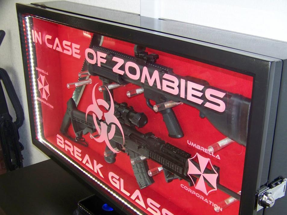

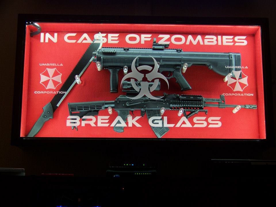

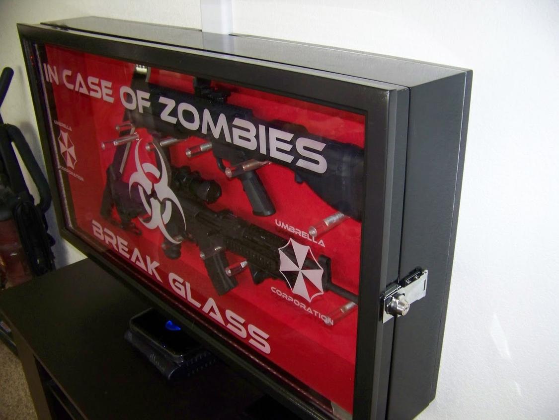

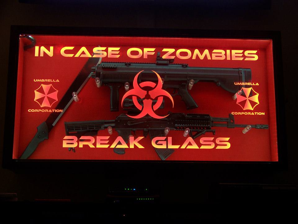

I made this display case because I couldnt find anything on the net that was worth my money. :) Its a key-locking case with recessed hinges. Red Felt interior with Adjustable Acrylic pegs. Interior lighting is two part, Red LEDs for the Acrylic front, and white LEDs for the weapons. Both sets of lights are individually dimming.. The acrylic front is sand blasted and edge lit, so the carvings really stand out in the dark.. Both weapons are also locked to the case with Trigger locks, mounted through 1/4" steel plate on the back side, and the entire box is mounted with 4 x 4" lag bolts.. So you MIGHT be able to steal these guns, but you'll have to take a chunk of framing with it.. :) What do you think?

The Gel cells would be pretty cool.. But honestly, those are the least expensive weapons in the house, and not my go-to's in an emergency anyways.. And I used acrylic plexi for the front, because I have kids, and dont want to worry about them breaking the glass.. I suppose the "BREAK GLASS" part would be kinda difficult with plexi :) But I sandblasted the lettering and logos with fine grit AO, and used adhesive vinyl shelving for the resist.. :)
