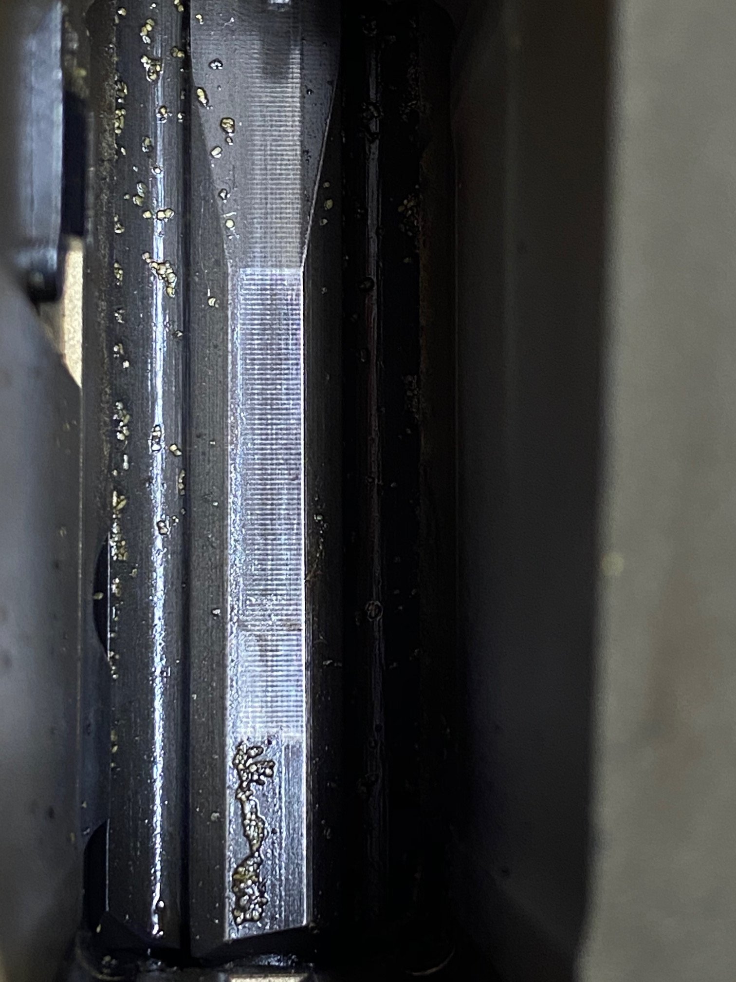

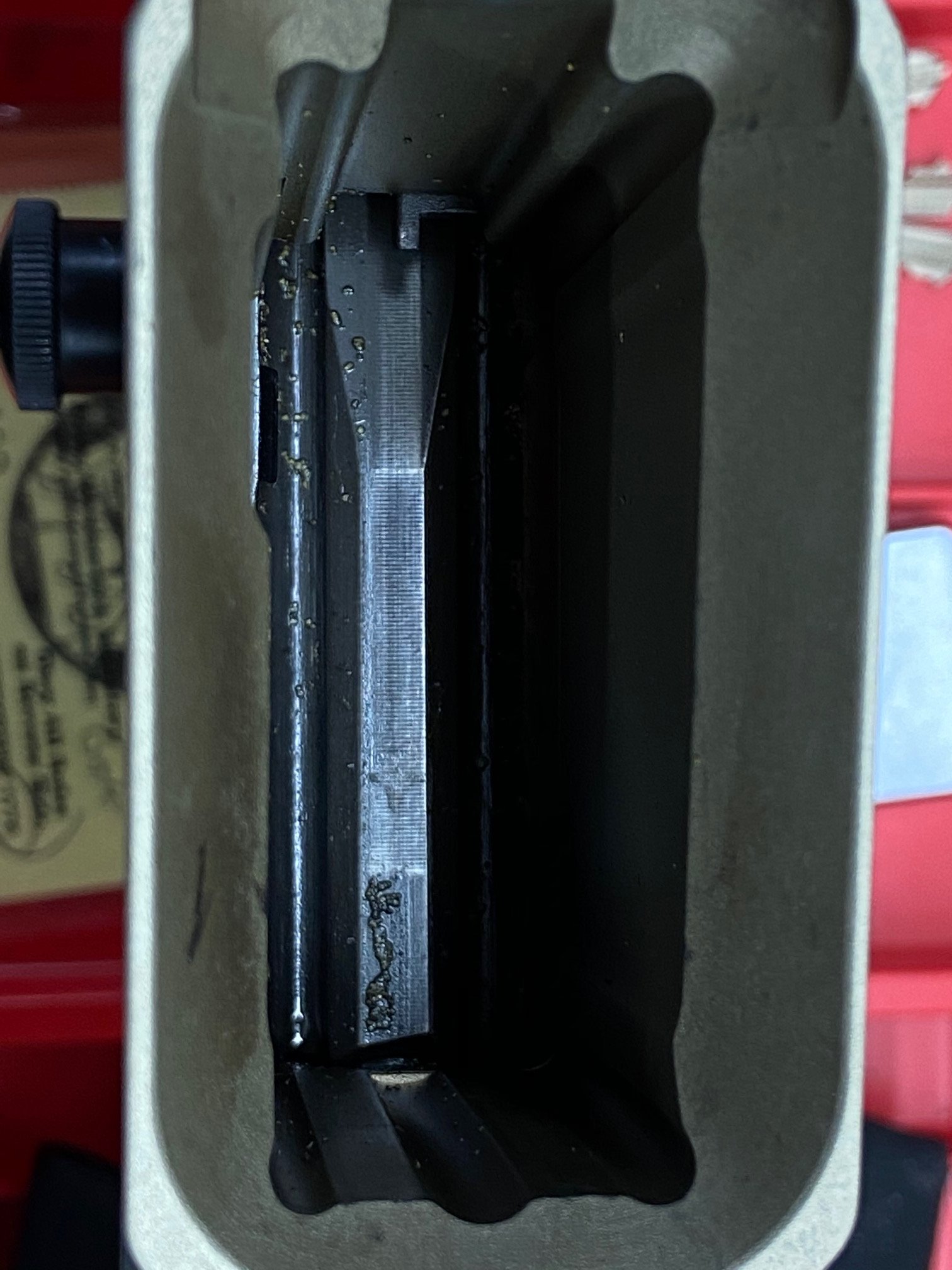

Does anyone have recommendations on subsonic ammo? I've used SIG's Elite Performance (220g). When I clean it there's what looks to be brass filings everywhere in the gun. I've only shot bolt guns up until the badger but I'm guessing that can't be normal?

How new is the gun, and what does your brass look like after firing? Could be your barrel extension grinding it up if it’s got some rough edges.

It relatively new, as in I don't shoot it that often, especially during the PRS season. What should I be looking for with the spent shells, just rough edges?

Look for gouges and scratches on the brass. They would be linear and run the length of the shell. My guess is your barrel extension lugs are scratching it up. I would try and cycle a few rounds through without firing, just run the charging handle a few times and let them kick out. Look at your unfired ammo. Does the ogive of your bullet or the brass seem beat or scratched up? If this is the case, you may just need to cycle the rifle more to smooth out the rough edges on the lugs.

It is far more likely that is unburnt powder.... kind of the nature of the beast in 300BK

bfoosh006 The flakes are gold/brass color. I'll have to break one open and check
That's not brass that's partially burnt powder; the yellow color is a typical characteristic of that. It's not really "unburnt", the powder doesn't look like that before it burns, but it's not completely burnt either.
It's a typical symptom of low powered subsonic ammo.
