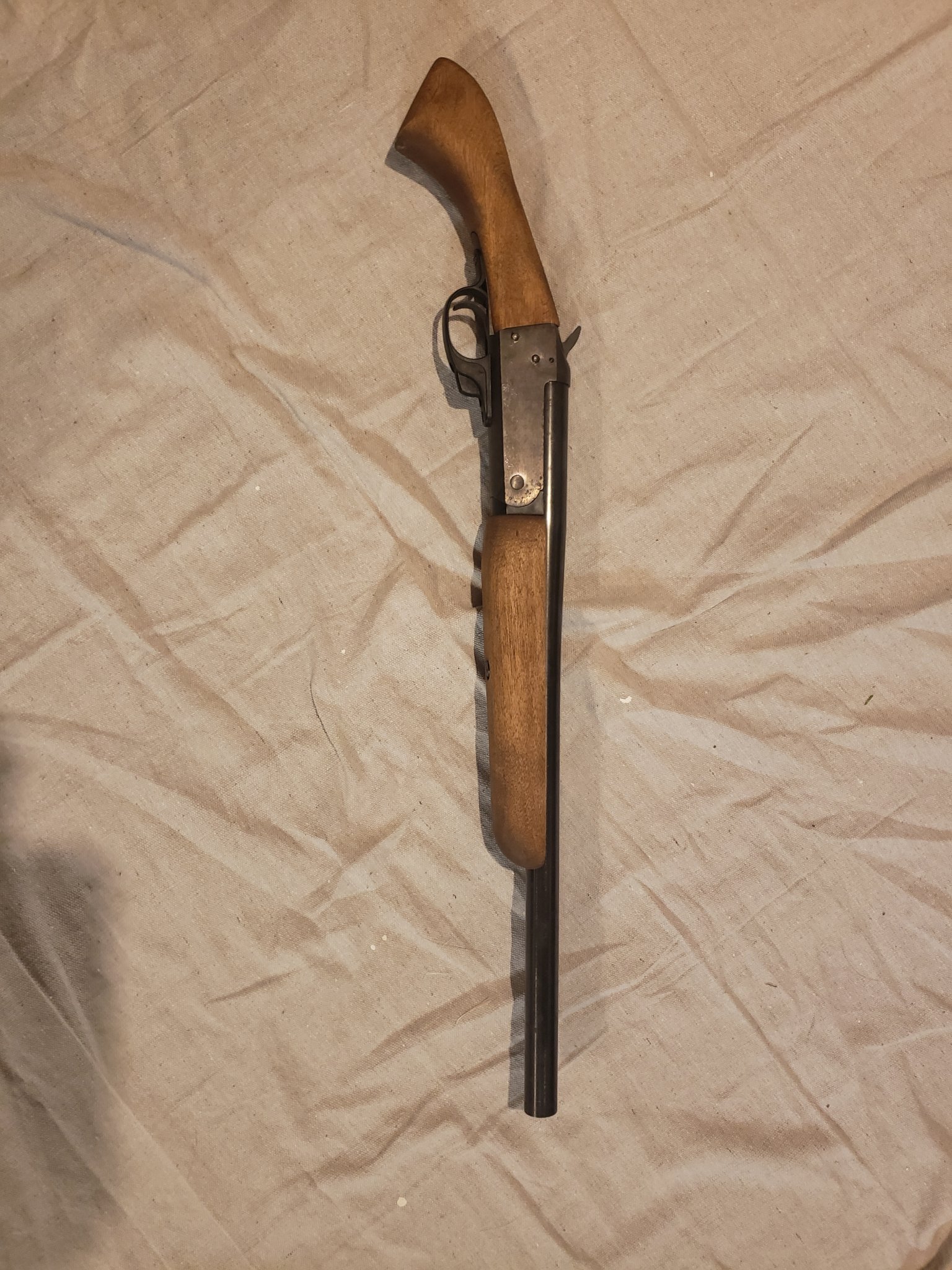

So I bought a beat up single shot 12 guage to turn into a legal sawed off. I was at a gun show in San Antonio and stopped to look at it because I had never seen one that had the lever in front of the trigger guard. I thought it was cool but he had it marked 100 bucks. Little much so I started to move on. He said I'll take 80. I said naw. He said 60? Nope. 40?
I said. Well I have always wanted to make a sawed off! I got it all done and went to shoot it and sure enough it goes bang just fine!!

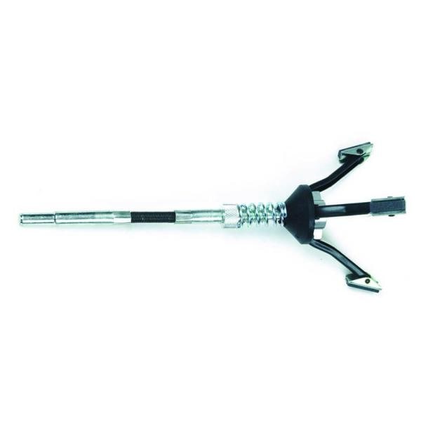

However it will not eject. It ejects unfired shell just fine! Sends them flying. But shoot it and you have to ram a stick down the muzzle to get the shell out. My theory is that the shell expands into the pitting from the rust. So the question is, can I use something like a brake cylinder hone to smooth out the chamber? Please tell me if this is the most idiotic thing you have ever heard. Or tell me what I should do.

I've never done work like that but I would be inclined to use something designed to hone shotgun chambers.
Did not know that was a thing. Thank you!! Will definitely try that first!!!
THIS X1,000,000
I've use their products for honing revolver chambers and they work great
I would avoid the use of a brake cylinder hone at all costs
