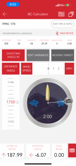

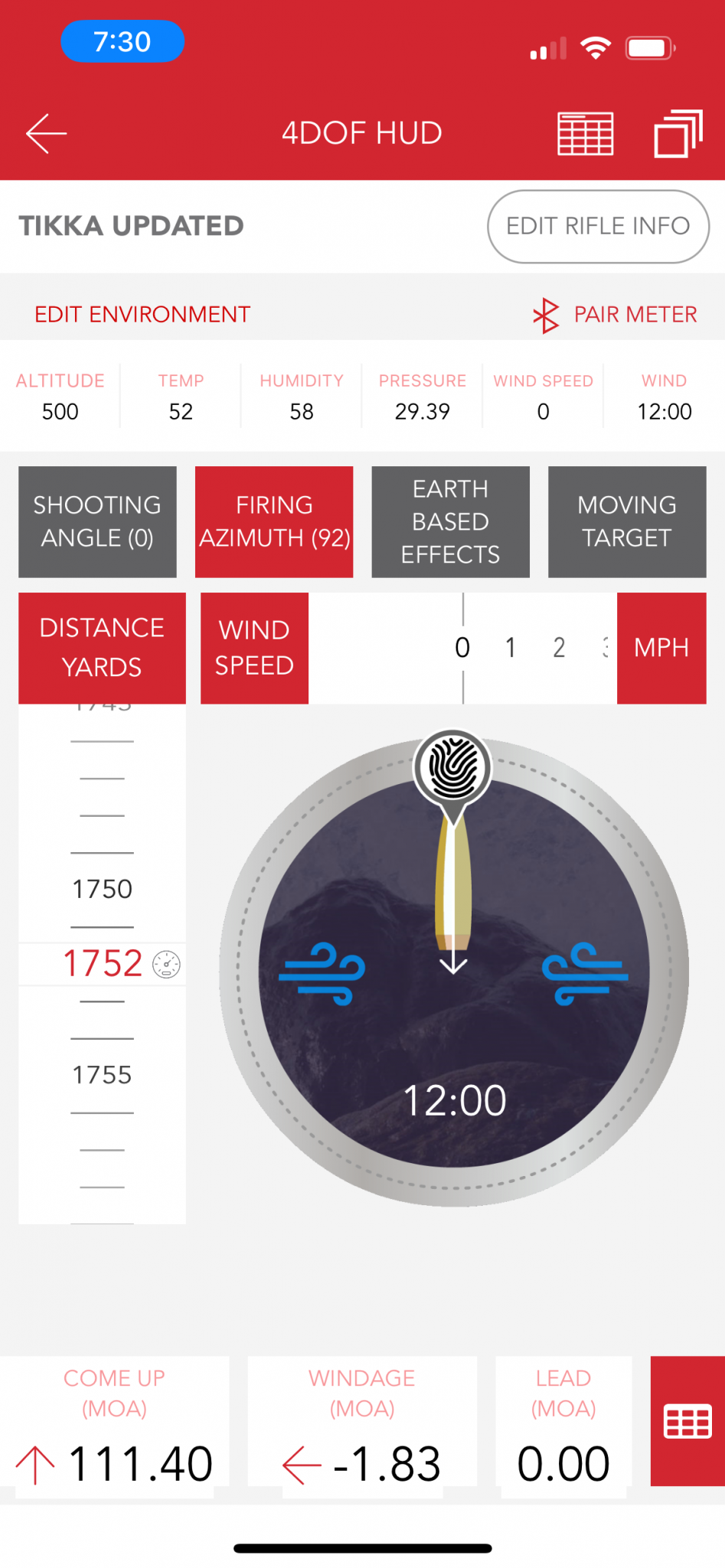

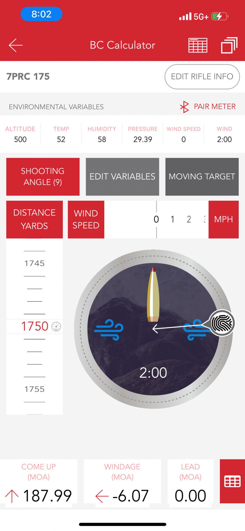

OK, I’m sure I’m gonna get roasted but not understanding when I have the same rifle info inputted into the 4DOF and switch to BC calculator the drop estimate is WAY different see pics below

Can we see what you have set for the "Edit Rifle Info" for both the 4DOF and the BC Calculator? Also double check the data for the bullet information.
Double check your screenshot. The BC doesn’t have the option to select the axial form factor. That option should not appear there.

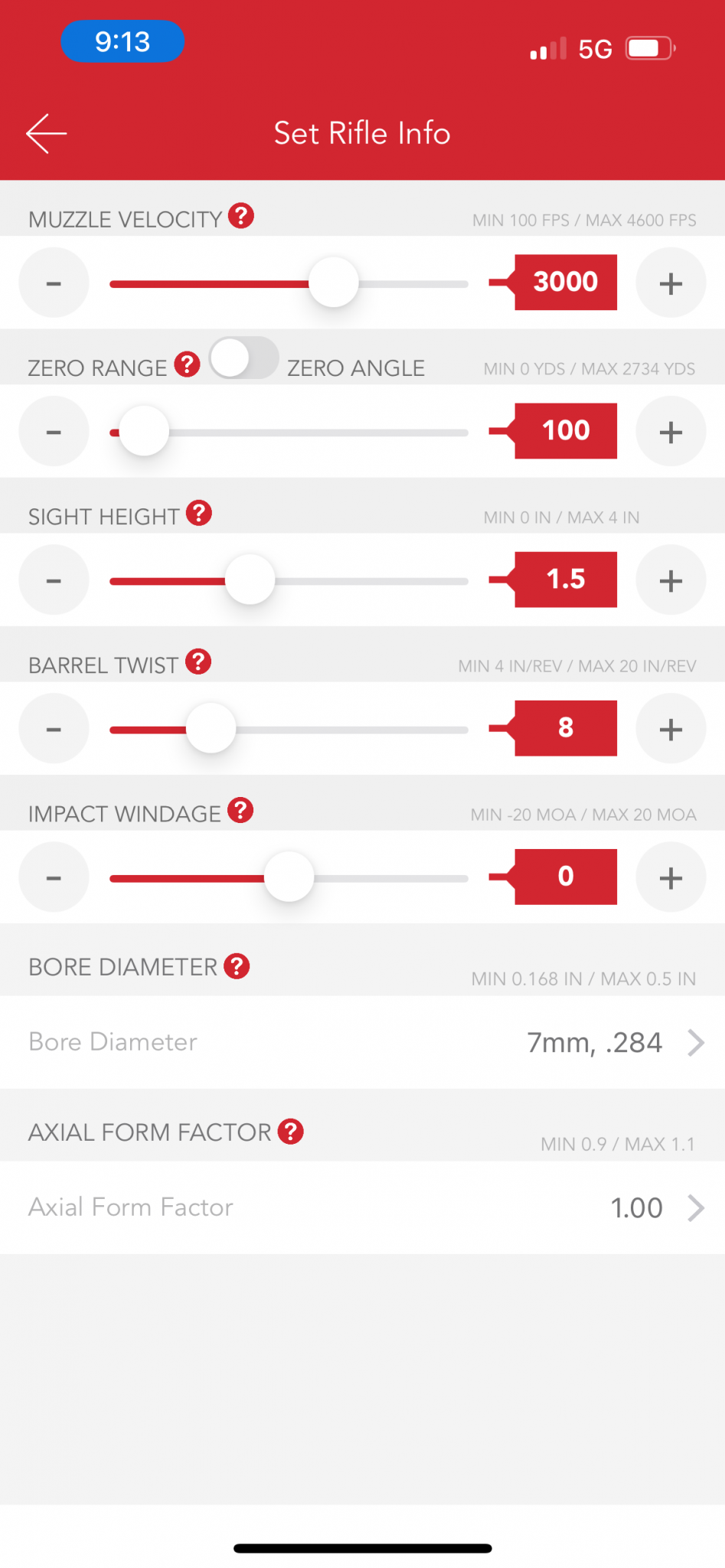

Ok I’ll resend but I have too many 7PRC profiles. So I’ll show you my 6.5 creed profile same
Issue see below 4DOF and BC screenshot

Ok, we need to see one screen for the 4DOF profile and two screens for the BC profile. Both profiles we need to see the "Edit Rifle Info" screen, and on the BC profile we need to see the screen you get to when you go through the following steps from the profile selection menu:
Edit the profile -> Bullet/Ammo -> Enter BC Value
